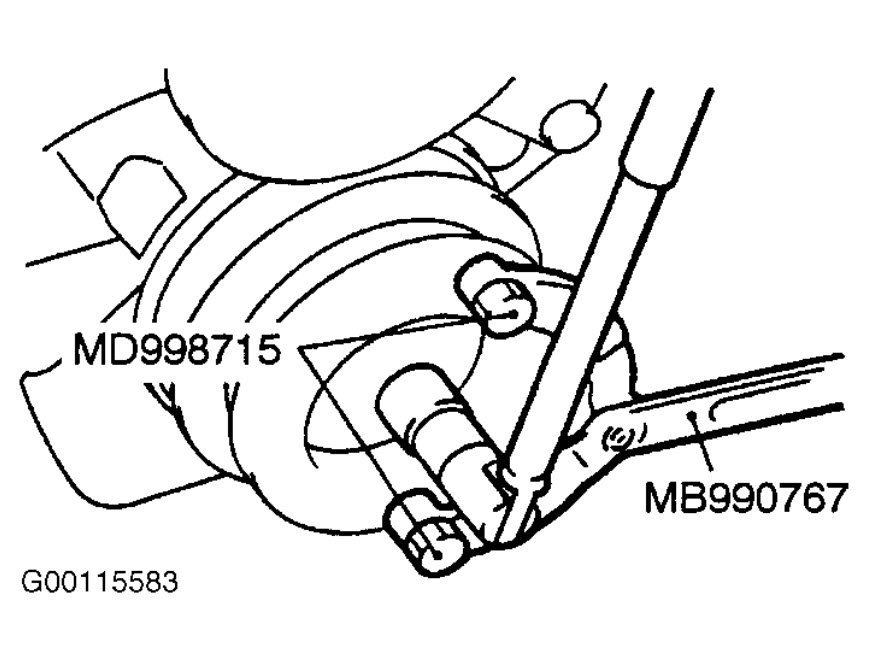

Trying to get the crank pulley off my 98 montero sport,you can't use a duckfoot puller because there are no anchor holes for puller,tried using a 3 jaw fear puller but not having any luck with it either,how do you get it off,most videos I've watched all show it coming right off after removing the crank bolt ,but not mine ,it's almost like something else is holding it on,any help would be most appreciated!!

you need the tool in pic shown to remove it. you might get a straight across puller to work maybe rent fro auto parts.
