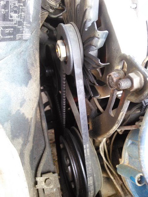

This one
Feb 23, 2016 at 9:13 AM
WRENCHTECH
  • 20,761 POSTS
In that case there is something wrong with the information you are giving me because that is the setup for the engine that you told me you had.
