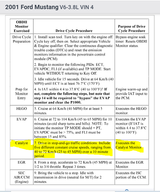

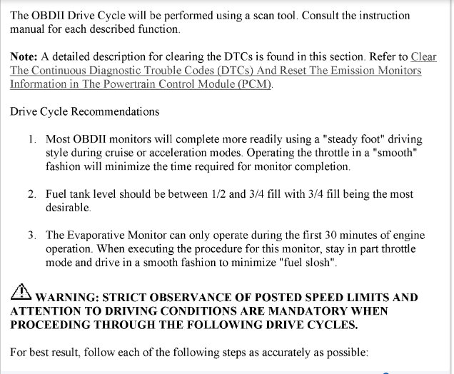

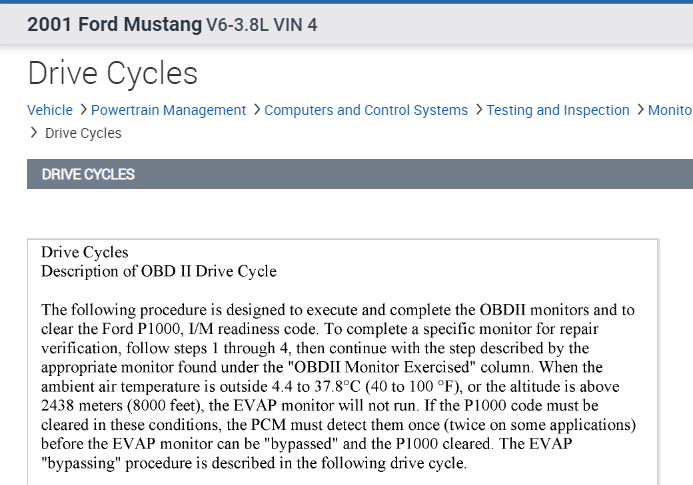

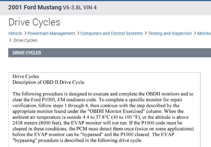

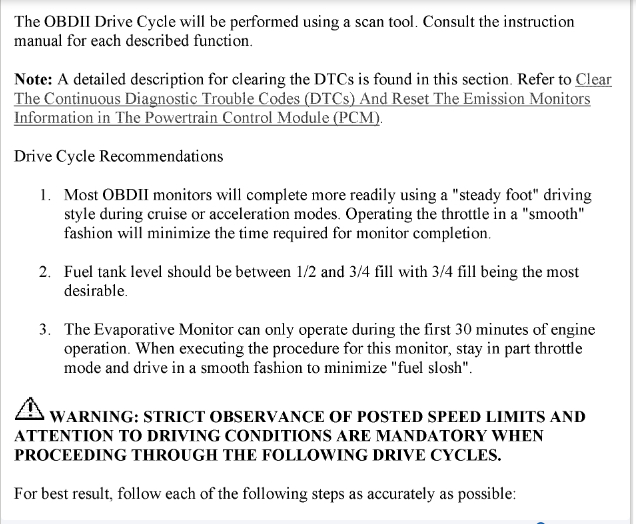

Due to the pandemic, we didn't drive the car that much. My car battery got replaced 2 times since. I took it for smog and all the test results were good except it's 'Not Ready'. I've driven this car close to 500 miles with all the tricks I found online with no success. I've got all ready except the Catalyst. The car runs very good for its age and mileage. Any secrets to share or products/parts to try? I've spent a lot of time and a small fortune on this car already.
