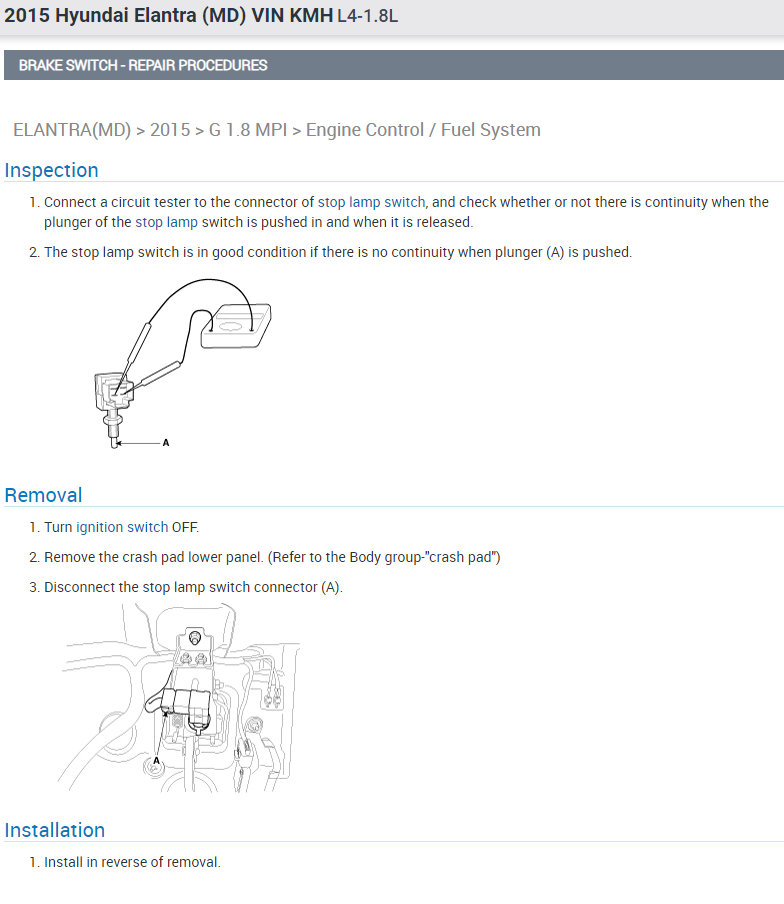

My brake lights are stuck on even when the car is off.

It sounds like the brake light switch is probably faulty. It is possibly stuck in the "on" position.
