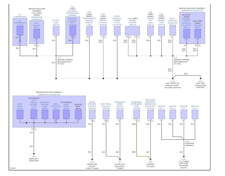

When I’m driving down the road. I’ll have to use the positive and negative buttons on my gear shift to help it not shift so hard at times. All this started after my transmission was rebuilt.
