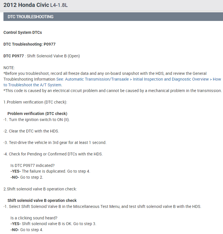

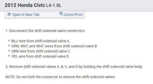

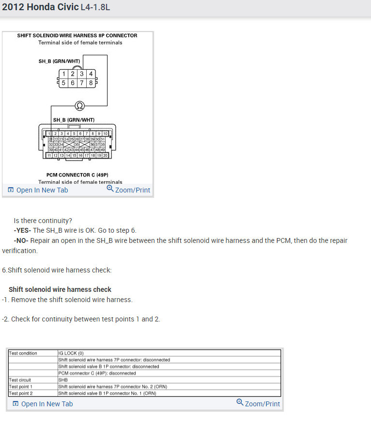

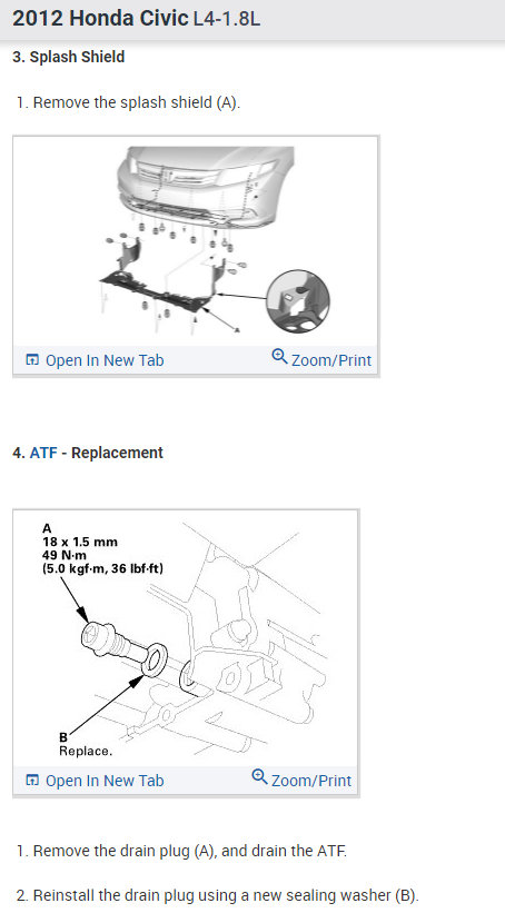

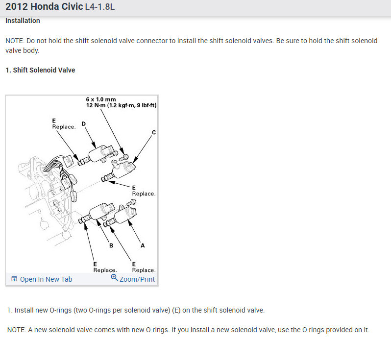

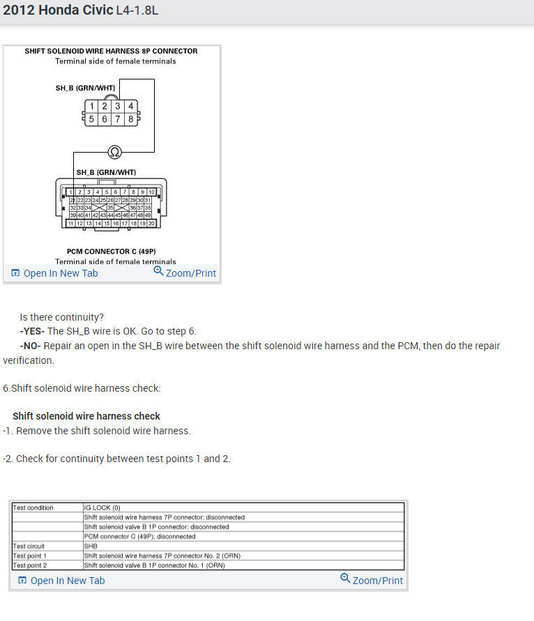

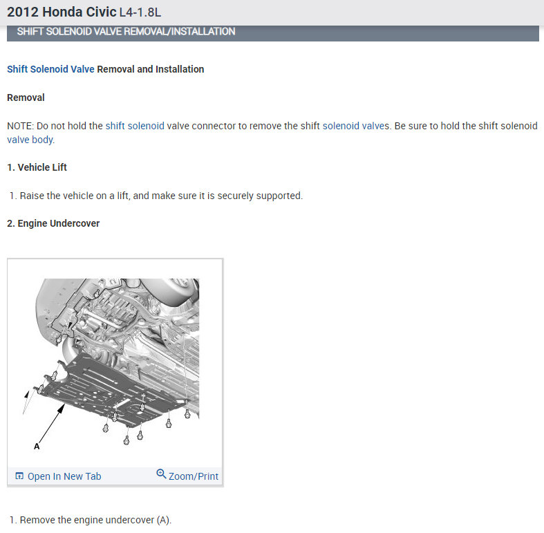

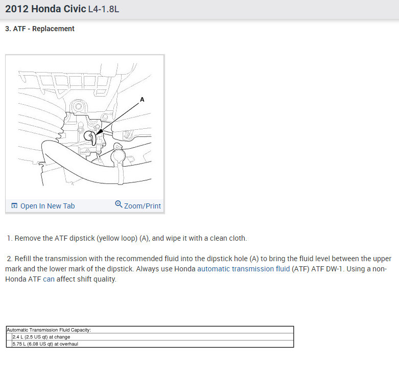

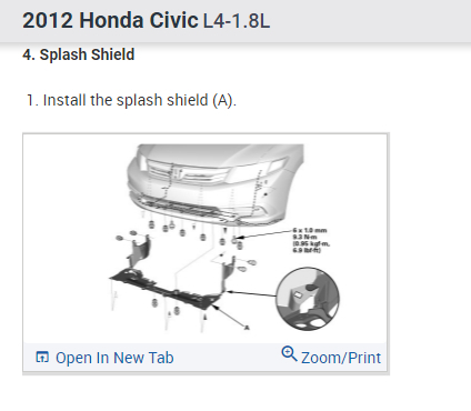

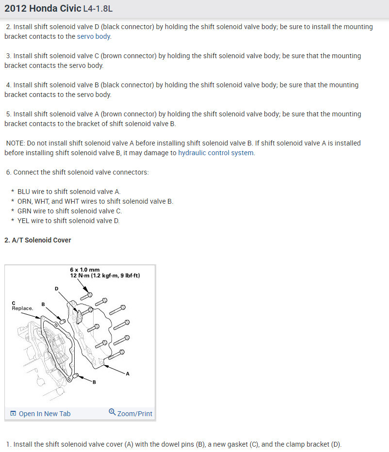

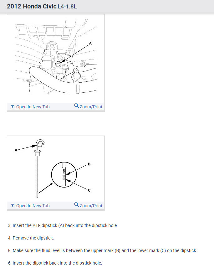

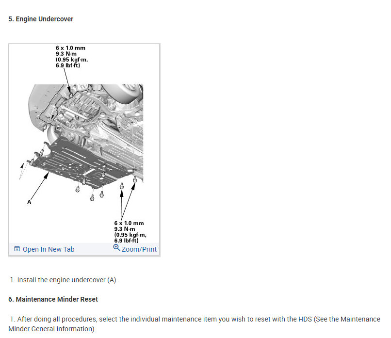

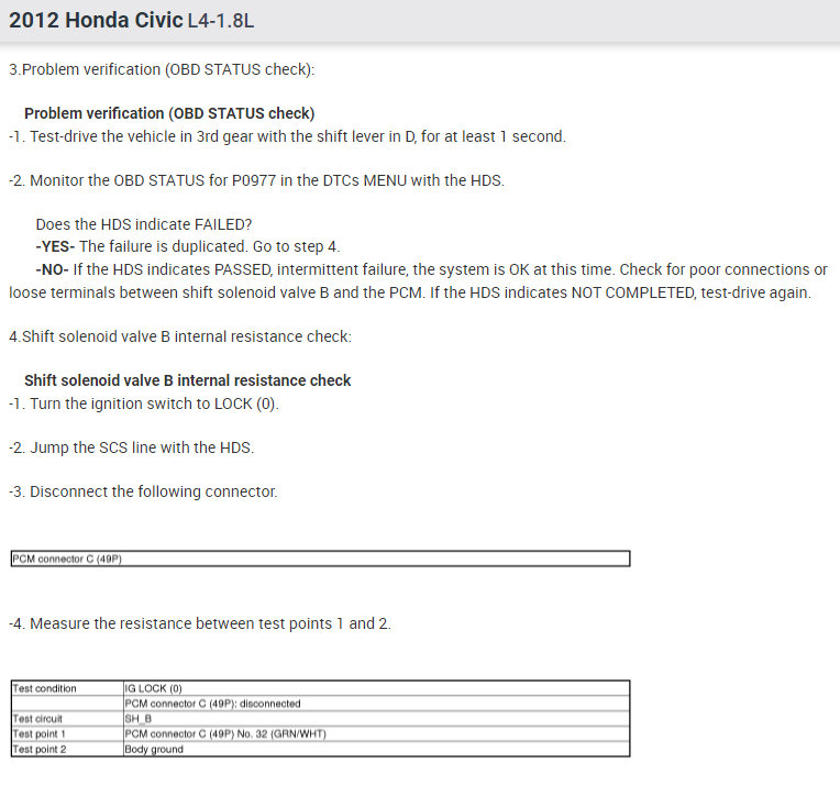

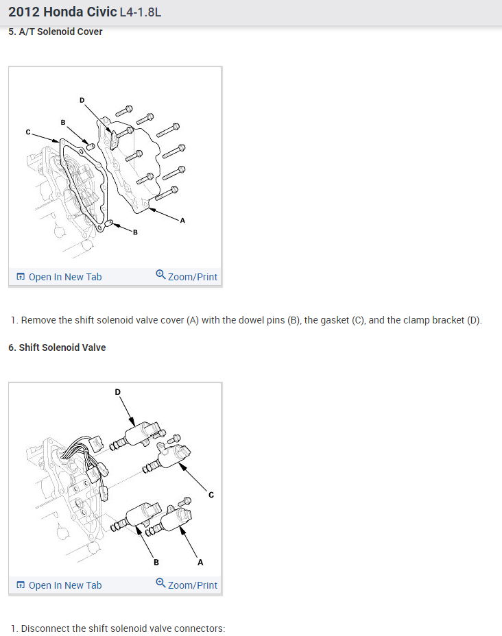

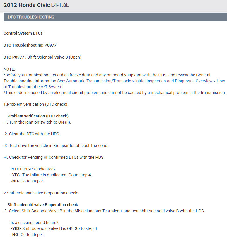

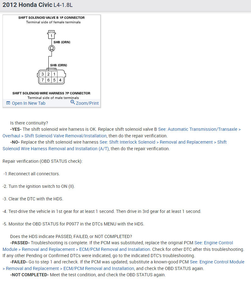

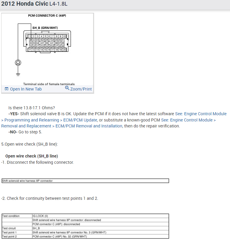

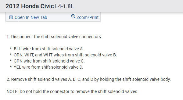

The "D" indicator light keeps flashing so I had it scanned and received two different codes from two different places (auto parts store and a mechanic). P0977 came from the auto parts store after the mechanic scanned and got a different code at first and then received that code with a different scanner. My question is, where is problem and is there a diagram or video I can follow to fix it?
