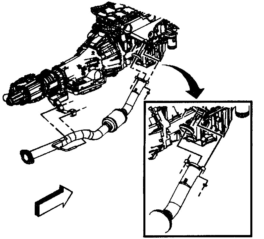

pic 1
1. Raise the vehicle. Refer to Vehicle Lifting.
2. Remove the nuts that secure the converter pipe to the exhaust manifold.

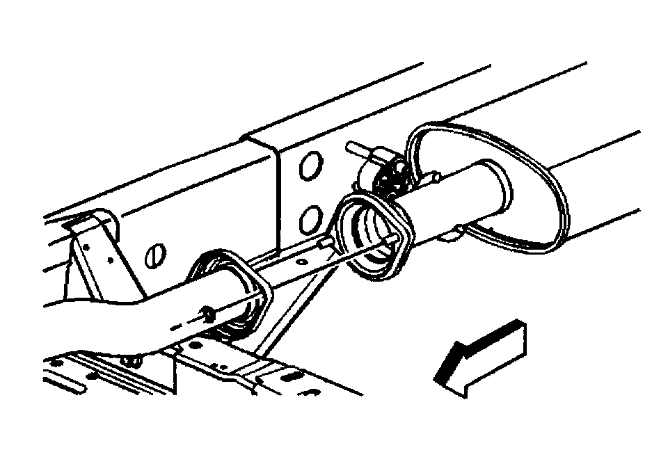

pic 2
3. Remove the nuts that secure the converter pipe to the muffler.

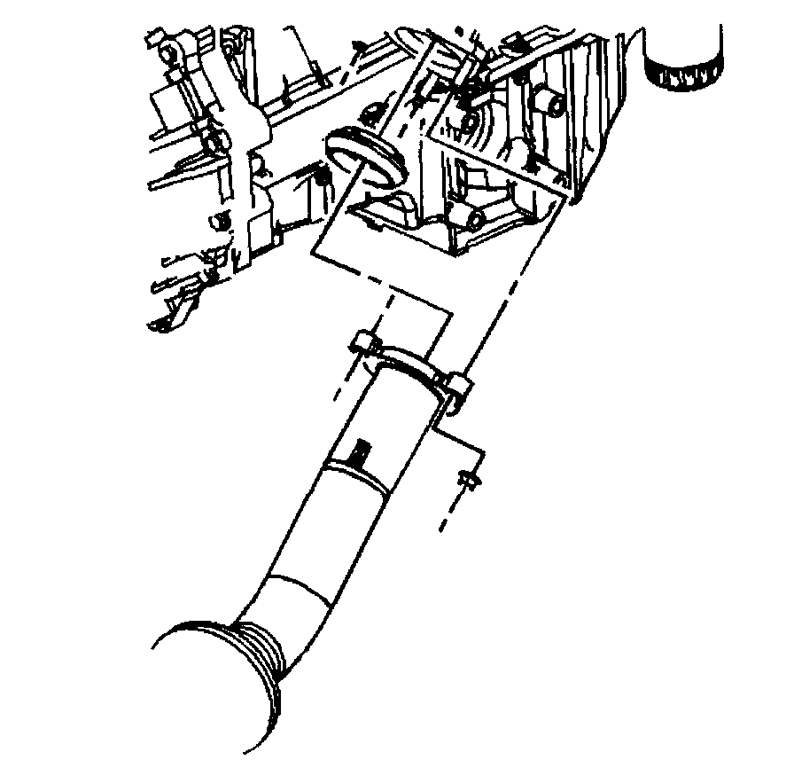

pic 3
4. Slide the catalytic converter out of the exhaust insulators and out of the vehicle.

2. Install the converter pipe to the muffler and secure the pipe with the nuts.
^ Tighten the converter pipe to muffler nuts to 45 Nm (33 ft. lbs.).
pic 6
3. Install the converter pipe to the exhaust manifold with the exhaust seal, and secure the pipe with the nuts.
^ Tighten the converter pipe to the exhaust manifold to 50 Nm (37 ft. lbs.).
