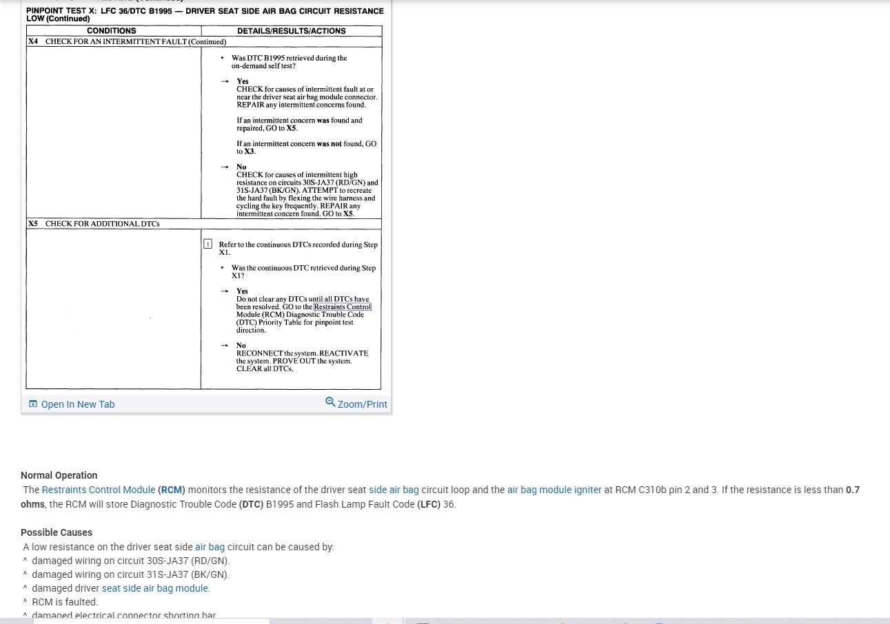

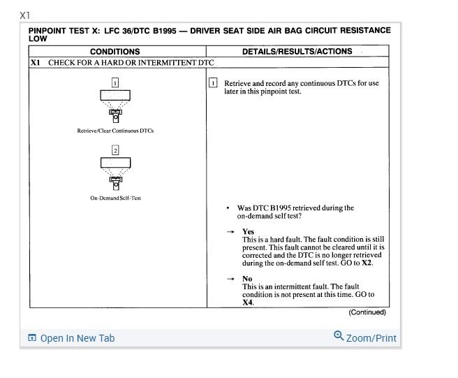

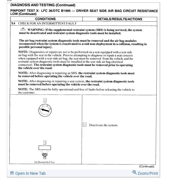

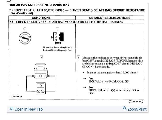

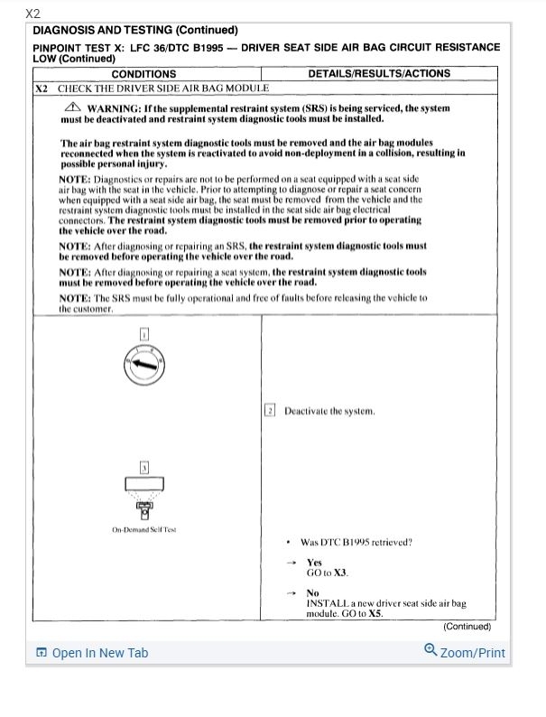

Good evening,
There is no way to bypass or disable the beeping. Since it is a safety system, it is programmed for you to have it repaired as soon as possible when the fault occurs.
I attached the flow chart for you below. The wires are a common failure, but they don't have to show external damage to be bad. They could be corroded internally. That is what the testing is for.
