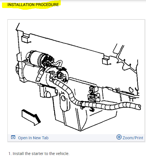

Also, I attached the directions specific to your truck below.

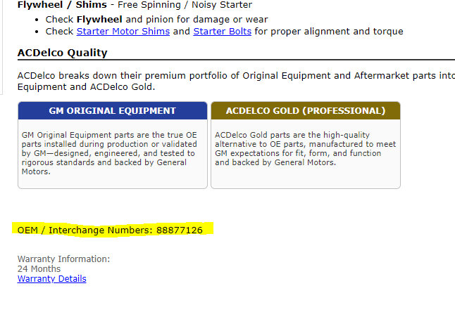

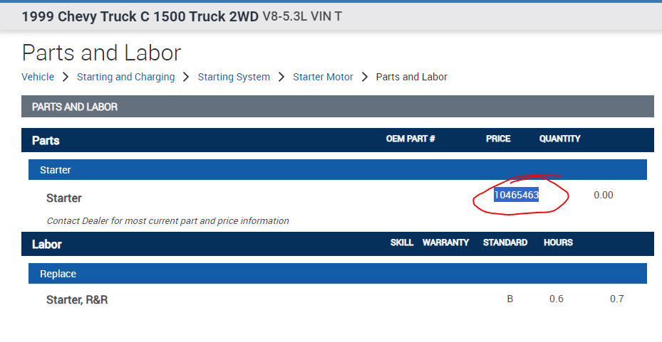

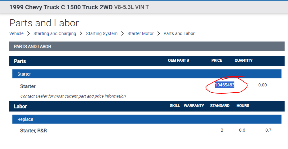

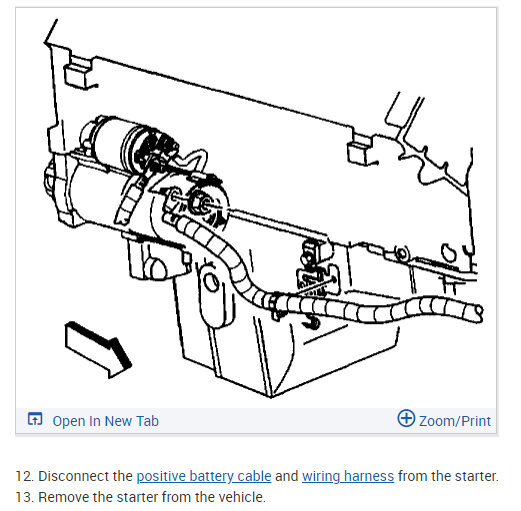

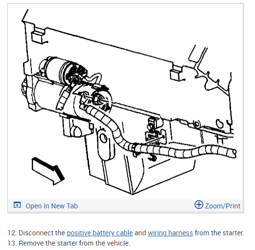

The OEM part number for the starter in your truck is 10465463. See pic 1 below. I looked up the part you indicated, and it shows a different OEM part number that it replaces. See pic 2.

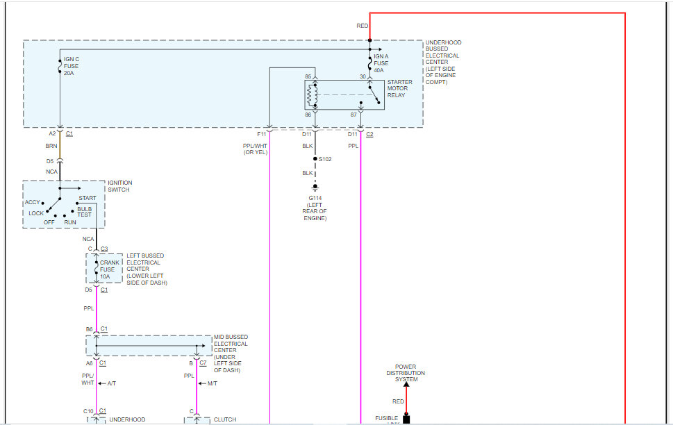

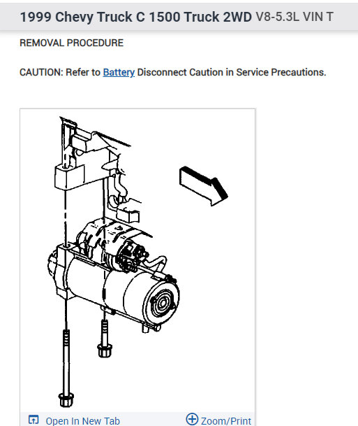

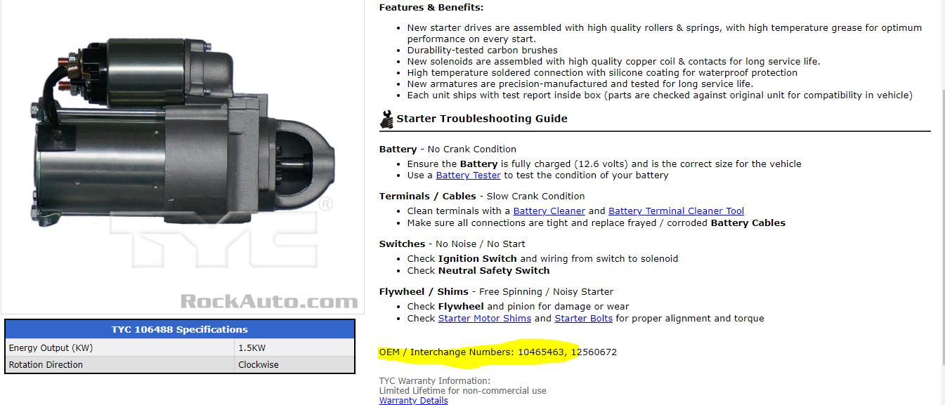

I used the OEM part number from my manual and Rockauto came up with multiple starters that indicate it is a replacement for what my manual indicates. Pic 3 shows an example.

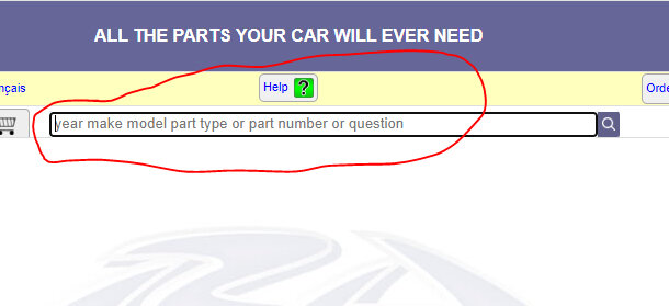

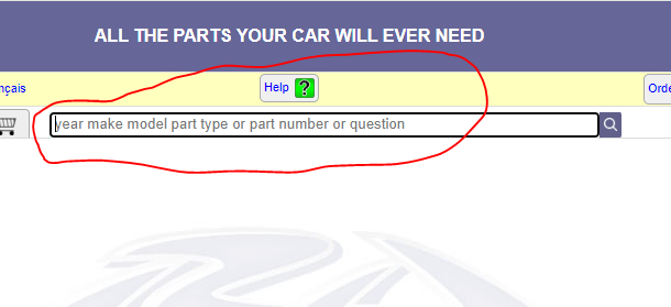

At the top of the page, you will see a place to put a part number. Put the 10465463 part number there and it will bring up starters.

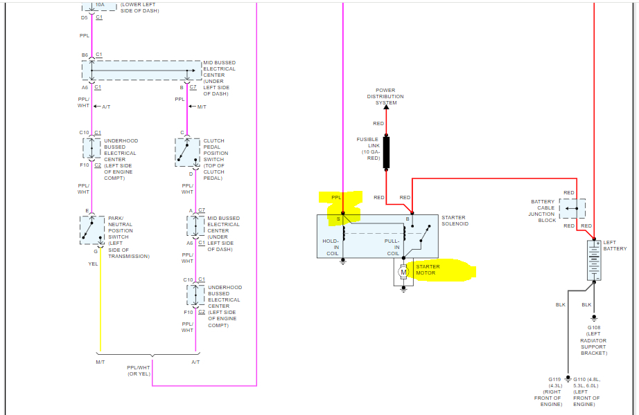

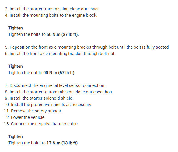

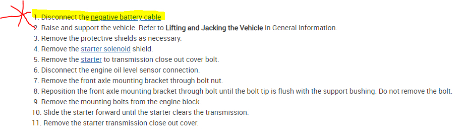

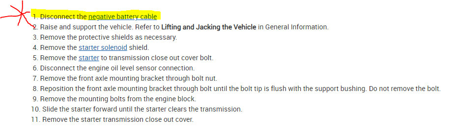

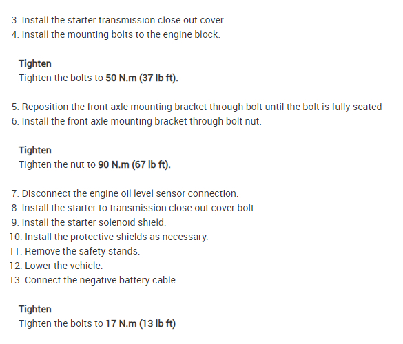

Starting with pic 5 are the directions for your vehicle. Before starting, make sure the battery negative terminal is disconnected. Also, it indicates removing things that I just don't remember ever having to remove. LOL Take your time and check to see what needs to be done for removal. It should be two bolts and the wiring on the starter motor.
