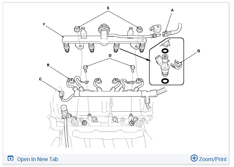

Yes, testing the resistance does not always work, it is more about the injector nozzle. I would remove the injectors as you are thinking and use this guide as a test:
https://www.2carpros.com/articles/how-to-test-a-fuel-injector
Here is how to remove the fuel injectors in the images below. Let us know what you find.

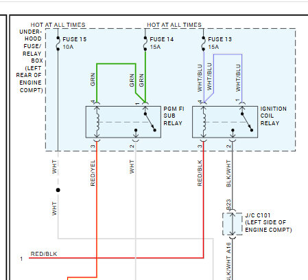

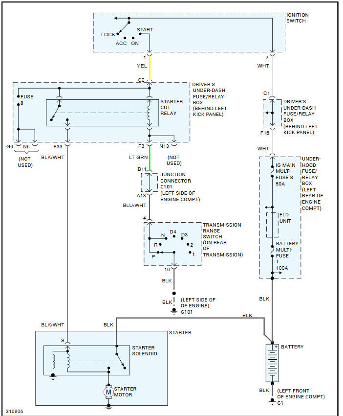

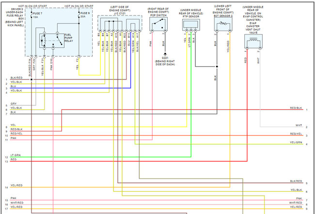

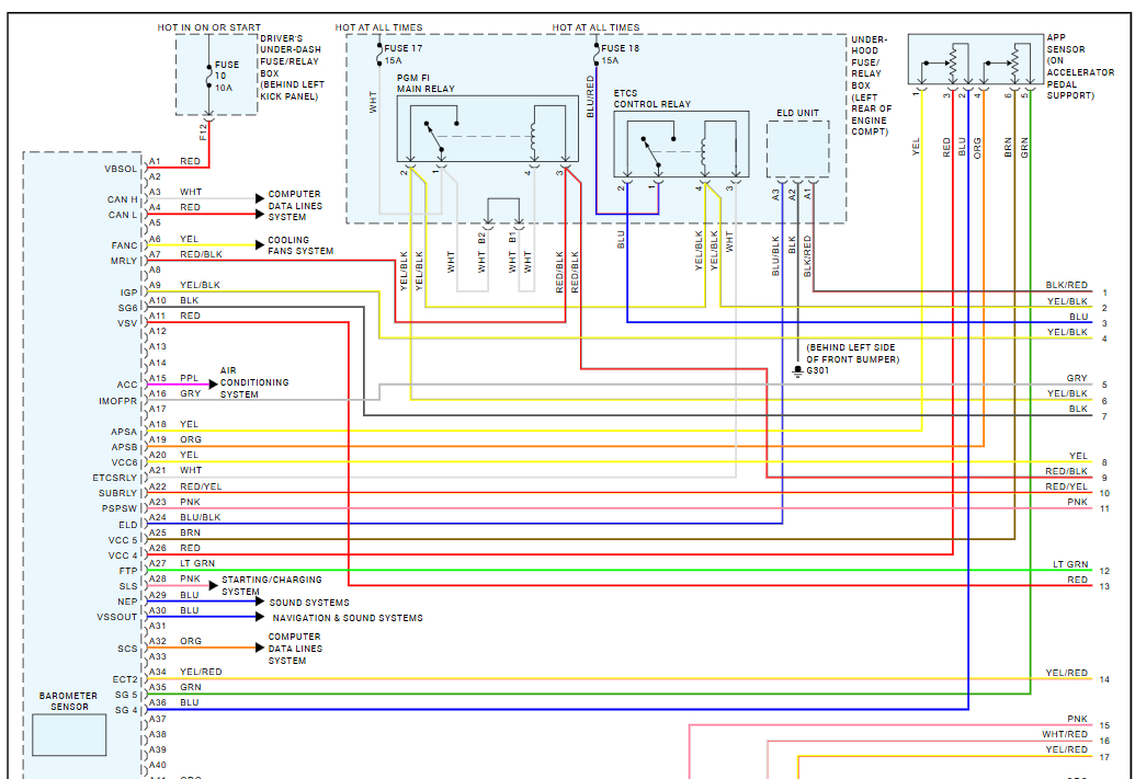

The images were lights on dashboard when key on III position without start. It’s normal. Yes, there are two problems now: first, I don’t know if injector 2 and 3 bad that caused p0112, p0113?
Second, now a new problem is the engine couldn’t startup with all injector wires losing power. When turn start key, no crank sound, but it changed battery power from 12.7v to 10v, indicating starter was not dead?
If specific fuse was broken? Or wire was disconnected?
I was going to check vacuum leak and fuel line pressures, but engine couldn’t startup now.
I need diagram from injector line to battery and battery to solenoid and starter diagram.
The cause of new problems probably the same on power lack on starter and injectors.
Thanks for your help!
May 23, 2025 at 11:14 PM
Sure here are the wiring diagrams for the PCM power and the starter system. Let me know what you find. Try uploading a video?
