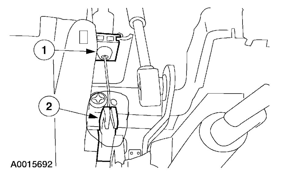

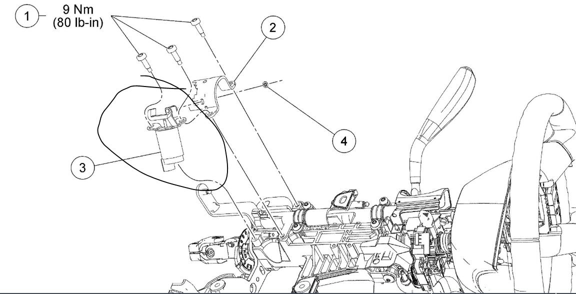

The floor console shift lever will not shift out of park.
Jan 9, 2020 at 10:05 AM
CERTIFIED EXPERT
52,796 POSTS
Good afternoon,
I attached the procedure for removing the cable to the shifter. By disconnecting the end, you will be able to move it out of park.
I attached both the floor shift as well as the column shift as well.
