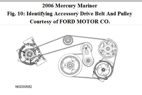

I've changed a few belts in my time but this one got me stumped its in there tight. looks like there should be a panel to be removed

you have to remove the right splash shield first . also replace tensioner at same time tighten tensioner mounting bolt to 33 ft. lb Check out the diagrams (Below). Please let us know if you need anything else to get the problem fixed.
Image (Click to enlarge)
