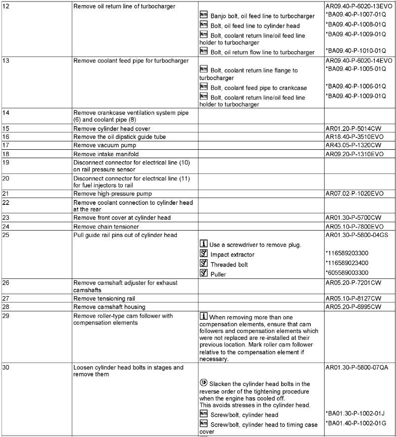

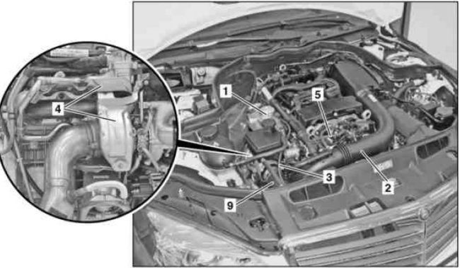

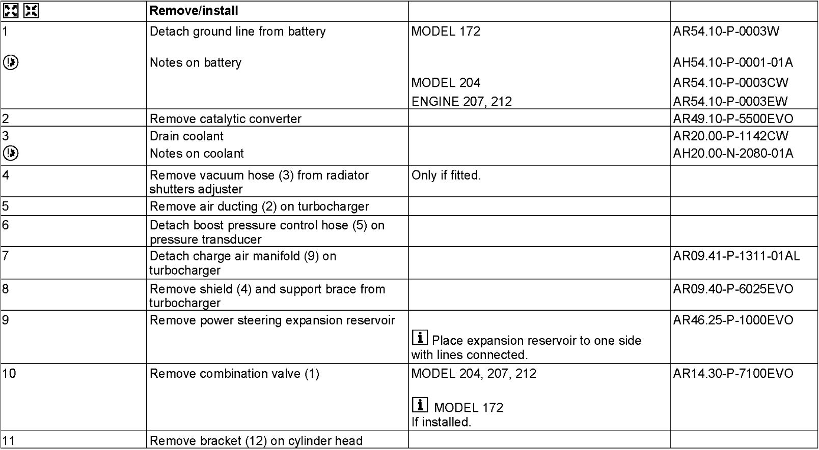

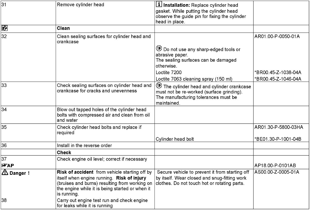

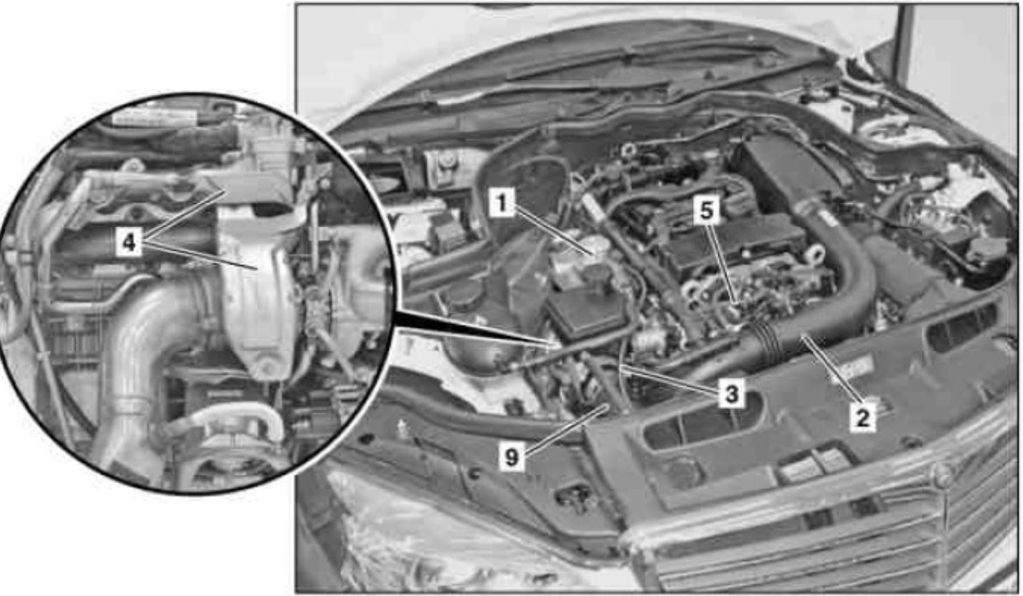

This is what the book has for this job.
Image 1
1 Combination valve
2 Air ducting
3 Vacuum hose
4 Shields
5 Boost pressure control hose
9 Charge air line

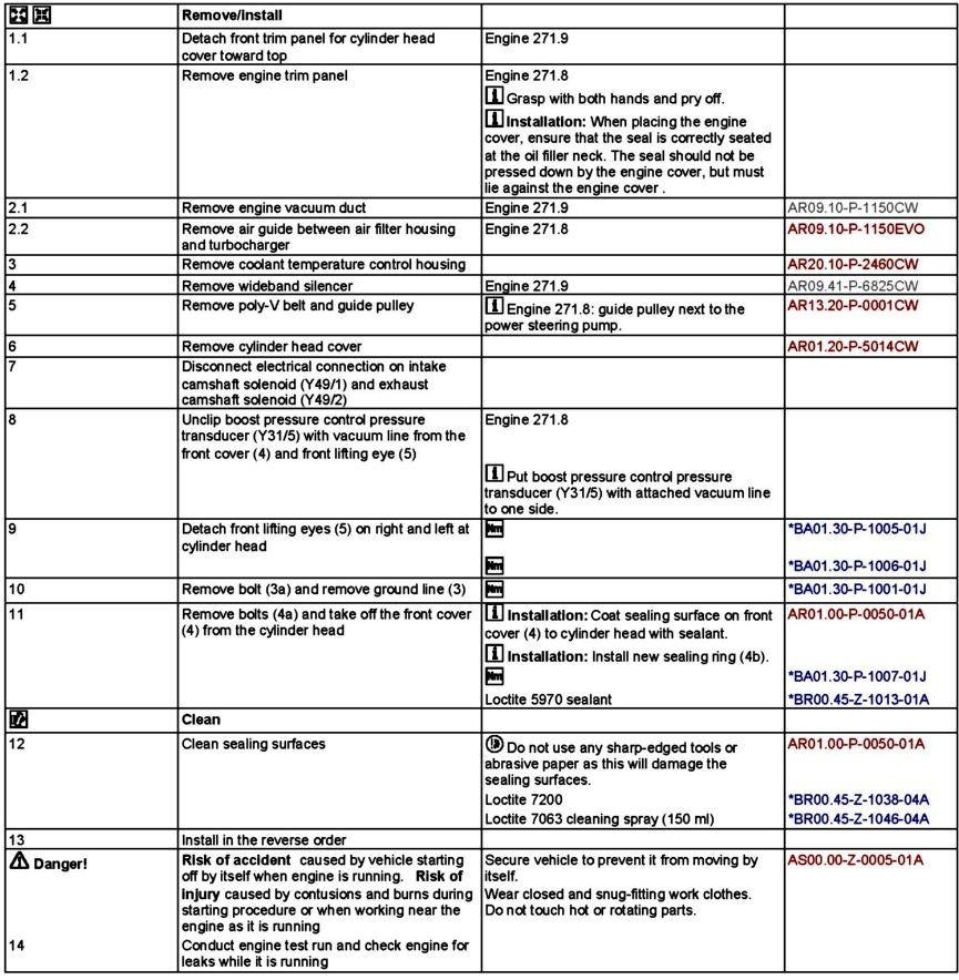

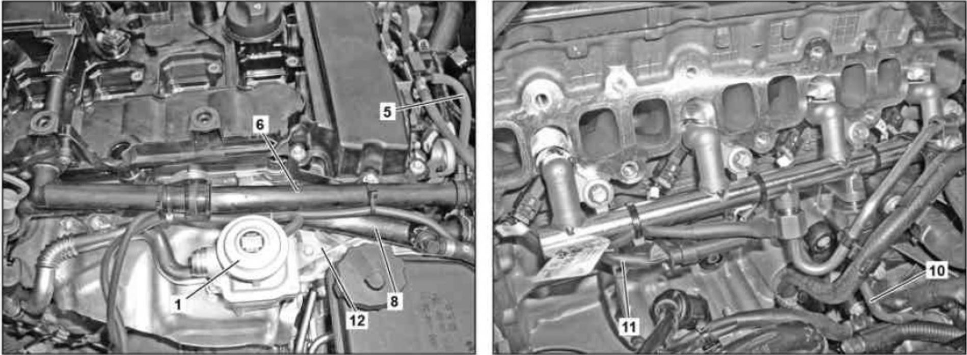

Image 2
1 Combination valve
6 Crankcase ventilation system pipe
8 Coolant pipe
10 Electrical line
11 Electrical line
12 Bracket

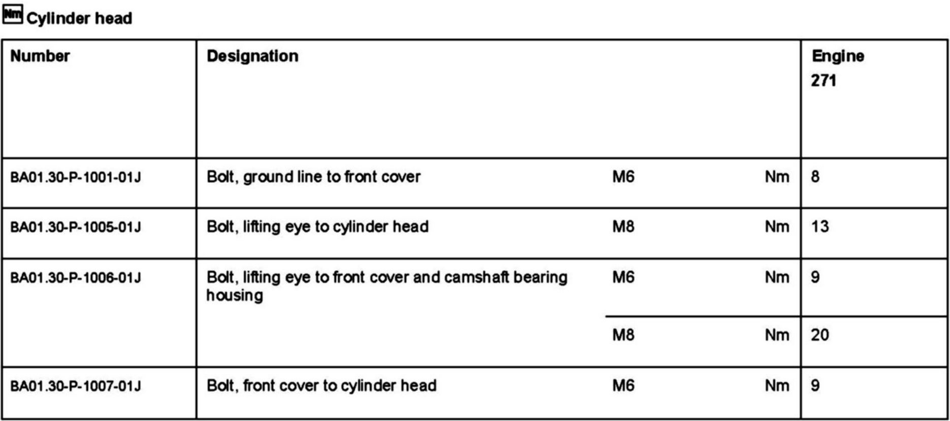

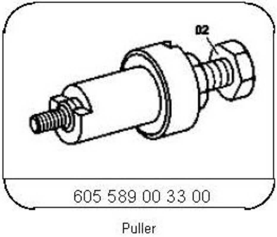

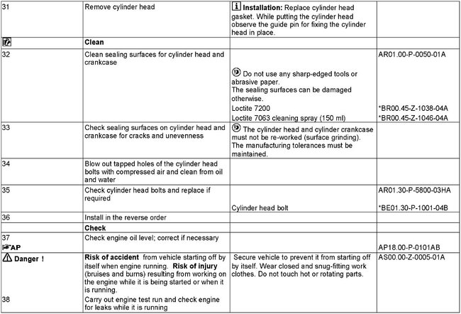

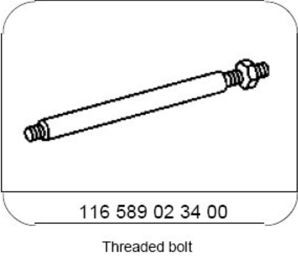

Images 3 thru 5 are the instructions for the head.
The tools are the special tools needed.

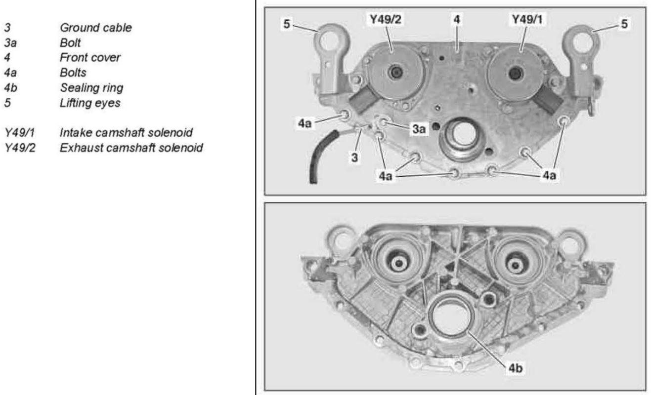

The other 3 images are for the front cover on the head.
