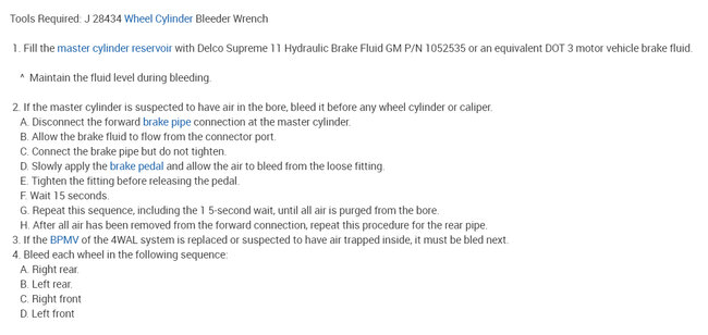

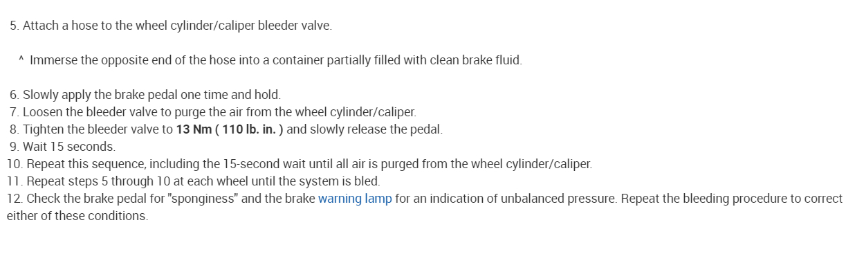

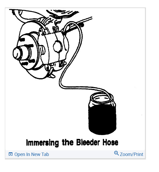

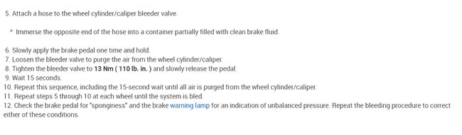

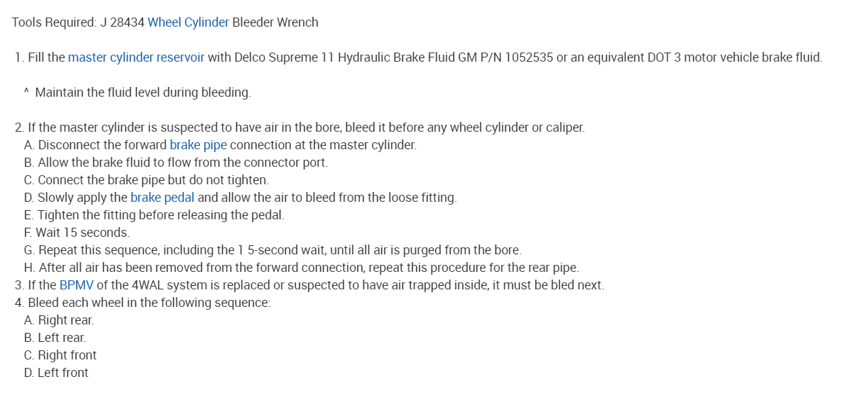

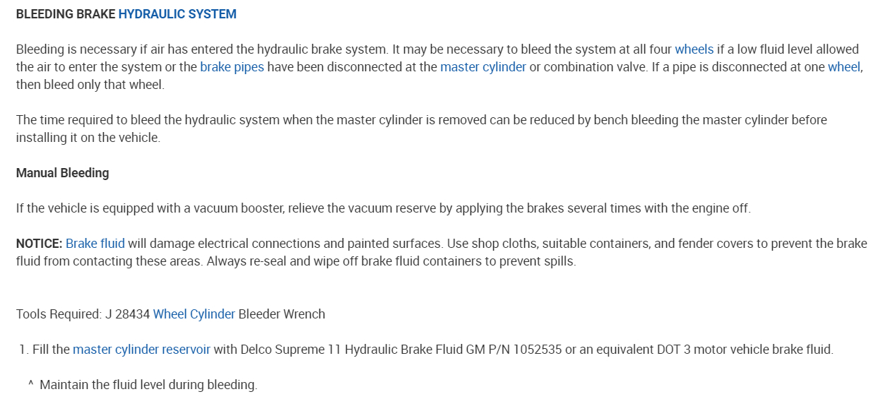

Here are the instructions for your truck in the images below. Please let us know if you need anything else.
