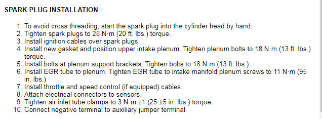

How do I change the back three spark plugs when you can't even see them?
Jul 14, 2019 at 5:12 AM
Hi Jamie,

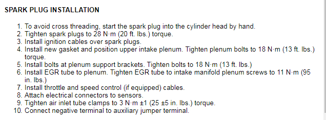

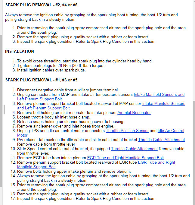

Please see the attached documents. Unfortunately you need to remove the intake plenum in order to remove the plugs. Not the easiest job but if you take your time, it is doable.
Let me know if you have questions. Thanks
