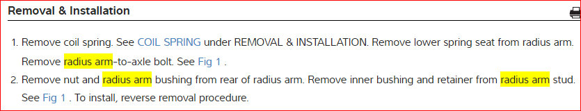

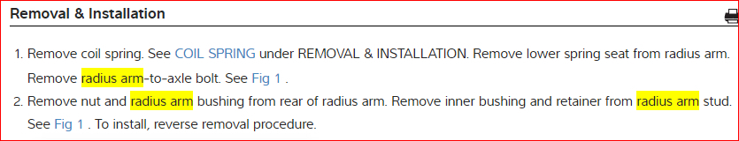

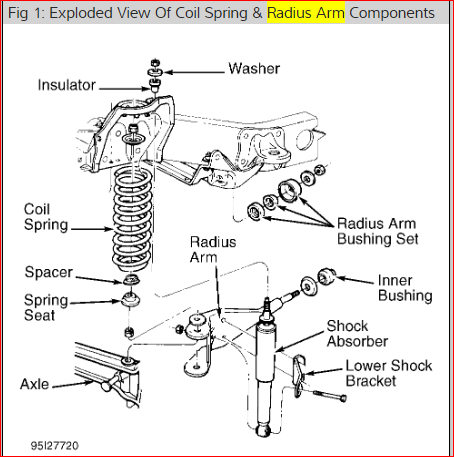

How do you replace radius arm bushing on my truck listed above? Maybe a good YouTube video you can suggest.
Thank you
Jan 30, 2019 at 11:12 AM
DANNY L
  • 5,648 POSTS
Hello, I'm Danny.
I've attached two pictures below for removal and replacement. Check out the diagrams (Below). Please let us know if you need anything else to get the problem fixed. Hope this helps and thanks for using 2CarPros.
