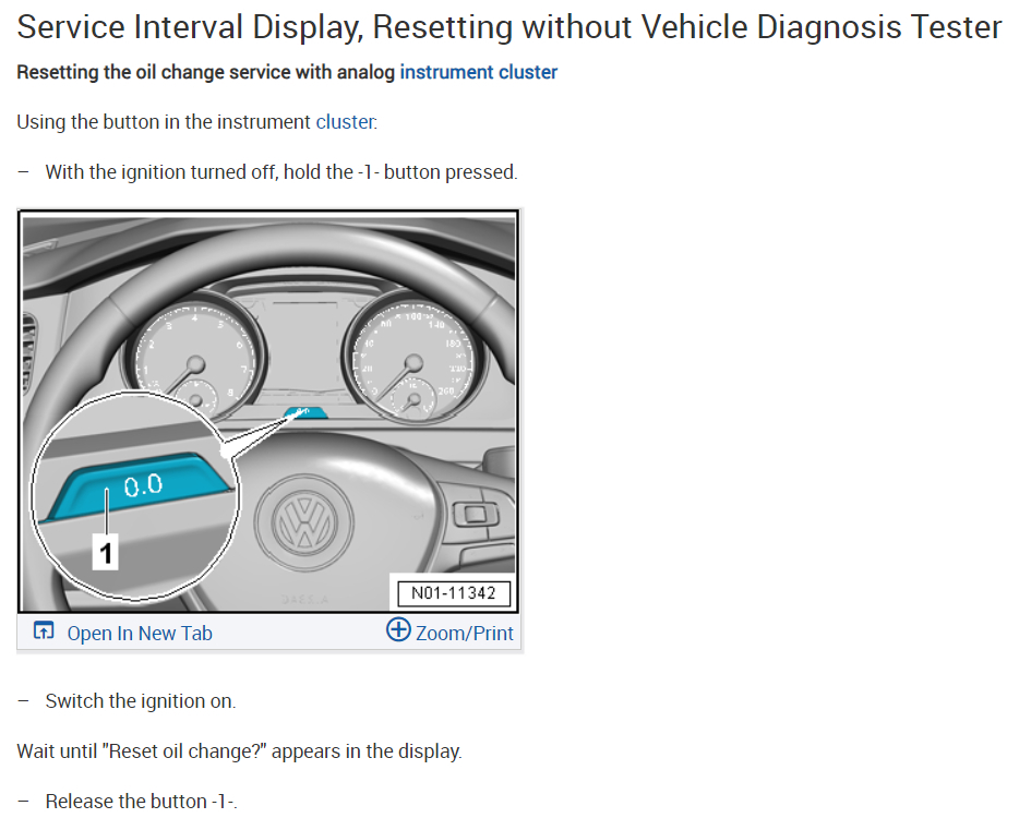

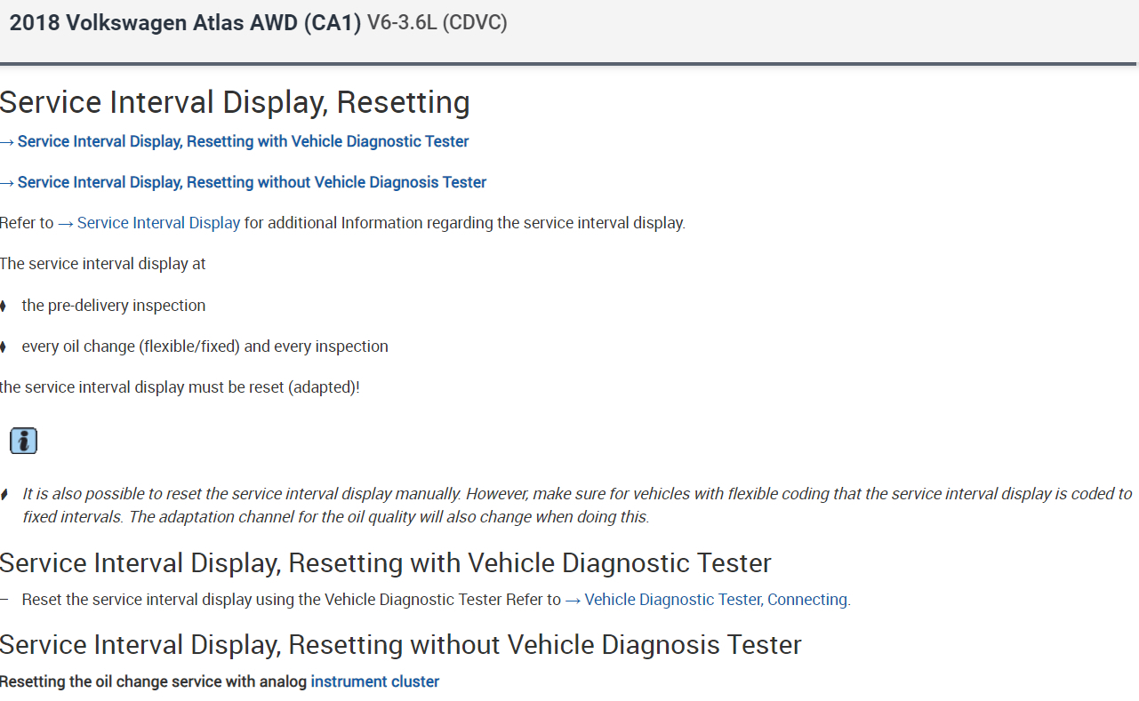

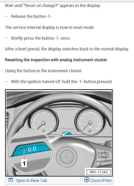

Looking to see how to do that, if possible, on my husband's 2018 vw atlas. We found how to reset it after the oil change happens, but I want it to alert me every 5000 miles- not the 4000 that it is currently set to. Please assist.
