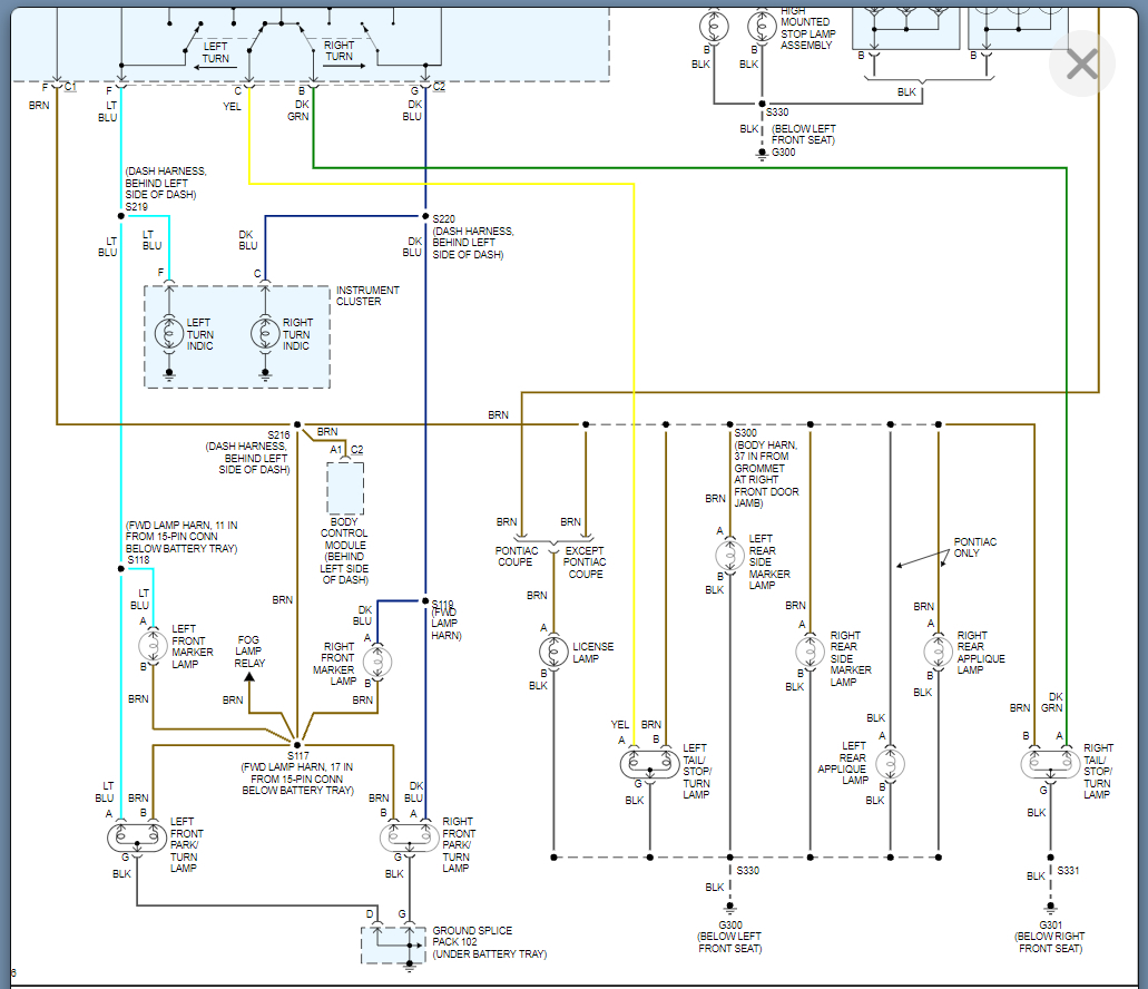

brake lights work but not the taillights. also, the dash lights don't come on. ever since my ex took the converter from car and melted harness wires now you can't shut the car off with a key, you must remove a relay. Please help me.

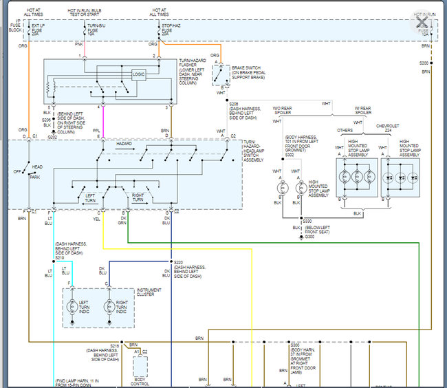

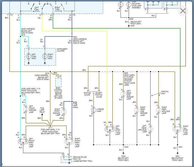

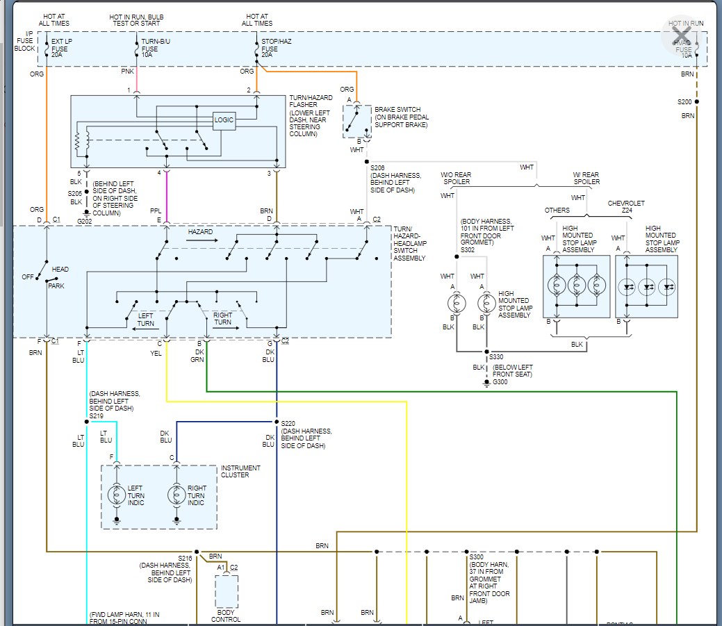

Let's start with the taillights. I am attaching the wiring diagram below because we are going to have to start with tracing wiring or just run a new wire because if you have melted wires then I suspect that is the issue.
What I would do is go to the light switch and see if you have voltage coming out of the switch on the brown wire. If your front marker lights are working, then you do but you are going to have to find the splice that you no longer have this voltage because that is where the issue is and either repair the wiring or just find where you do have voltage on this wire and create your own new splice.
Let me know what you find with this, and we can go from there. Thanks
