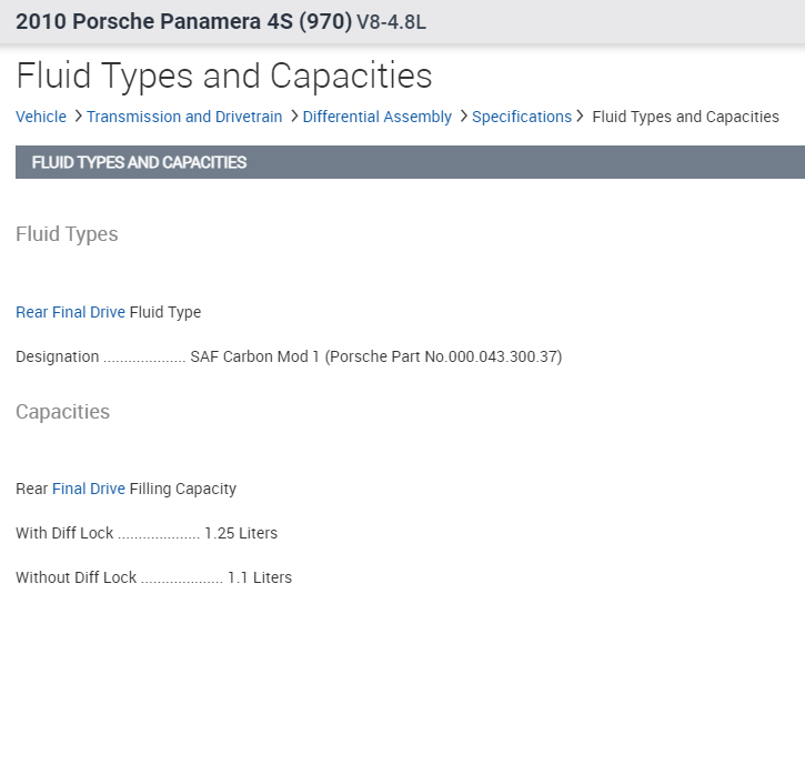

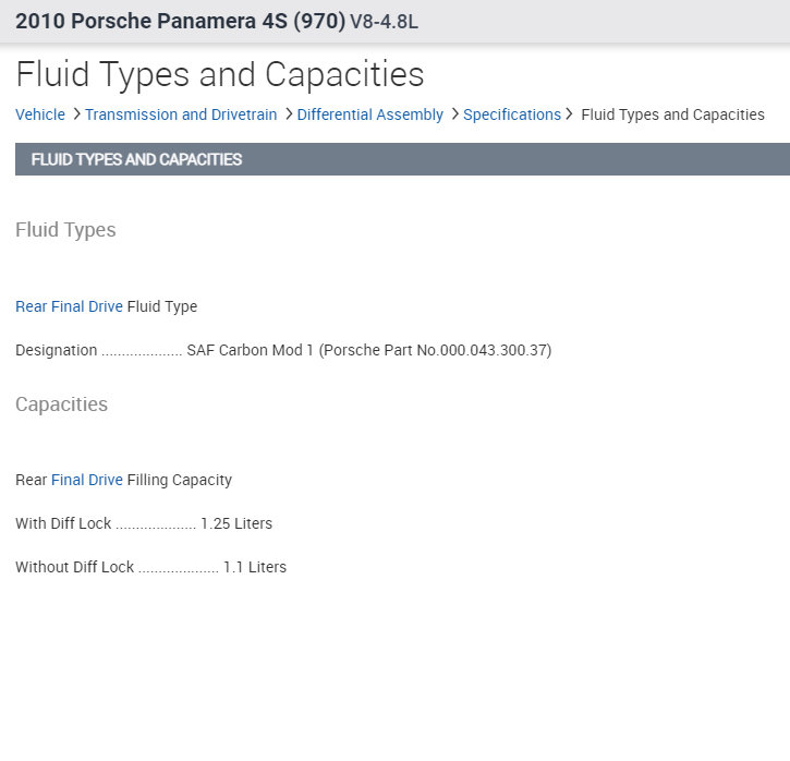

And what the book says the type of fluid is please.
Jan 8, 2022 at 6:06 PM
SQM
CERTIFIED EXPERT
6,383 POSTS

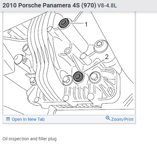

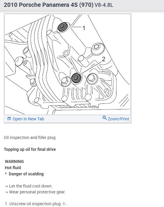

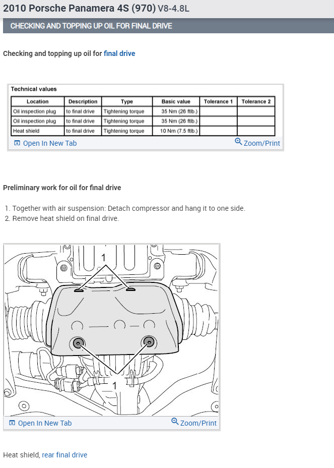

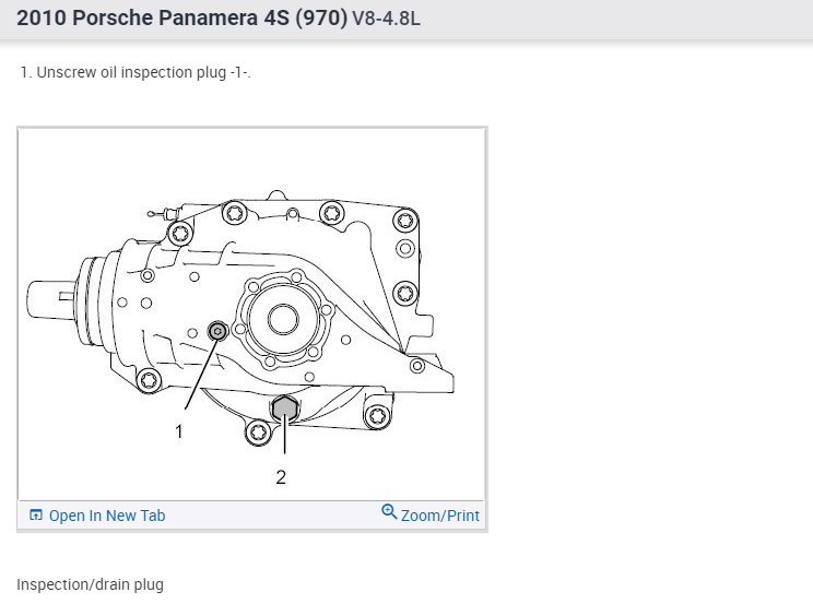

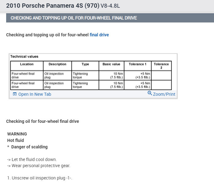

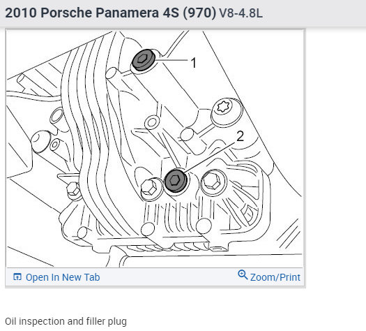

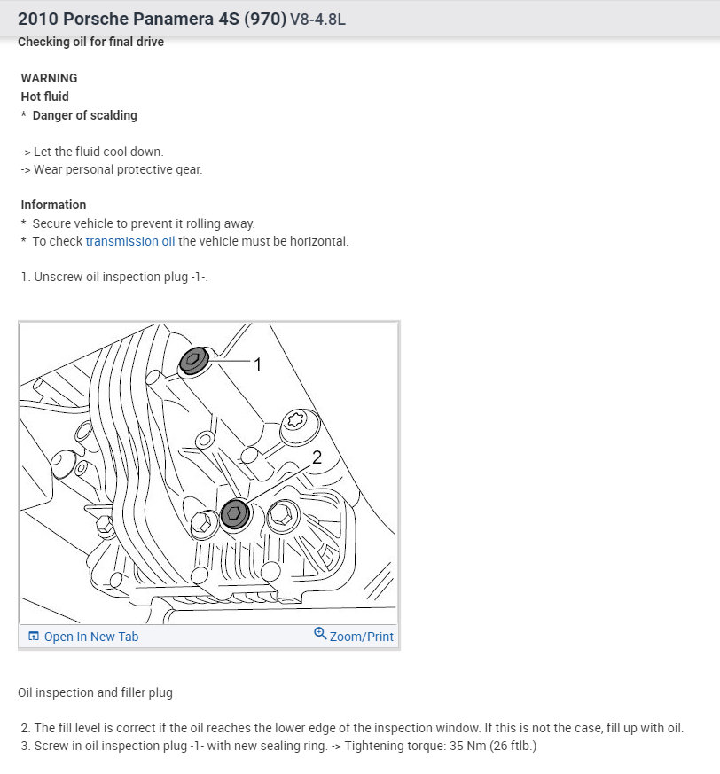

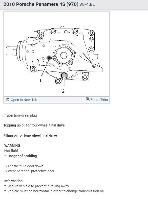

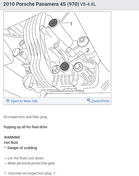

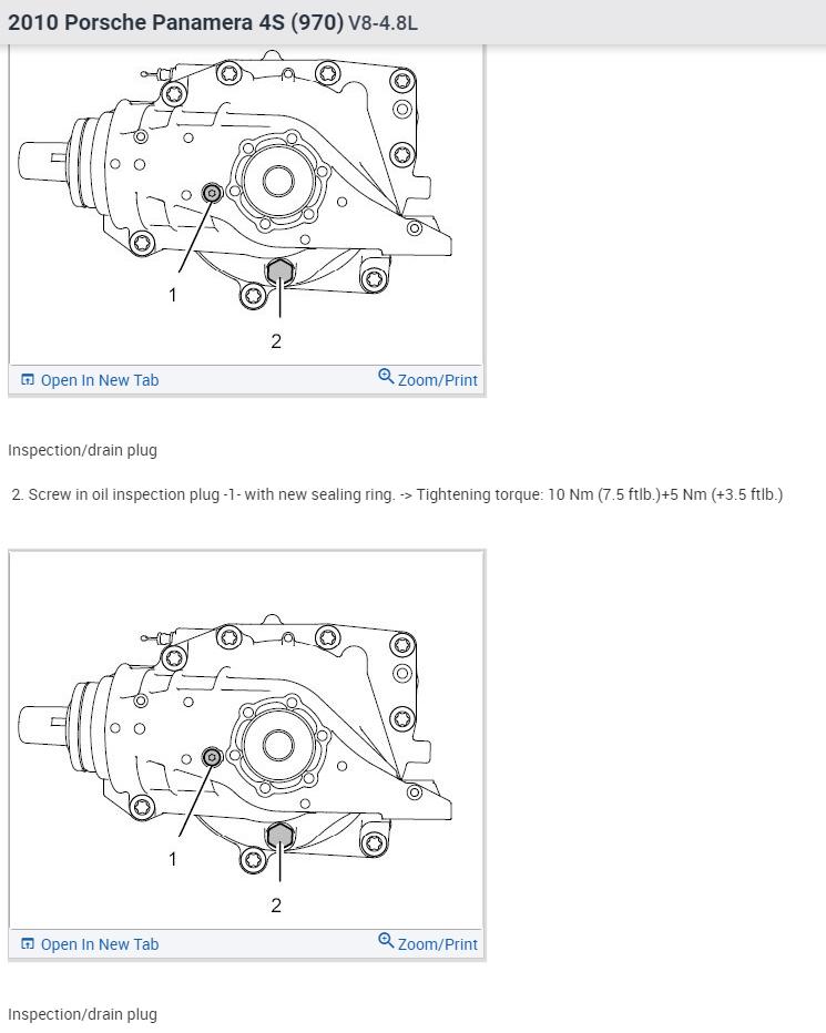

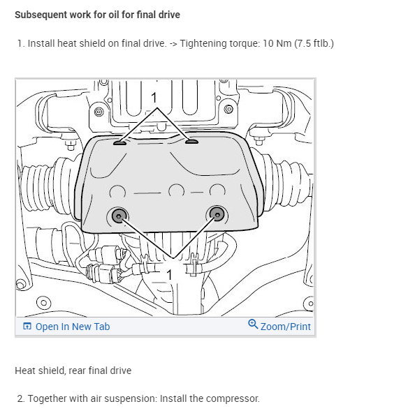

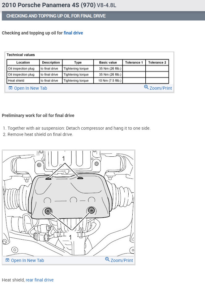

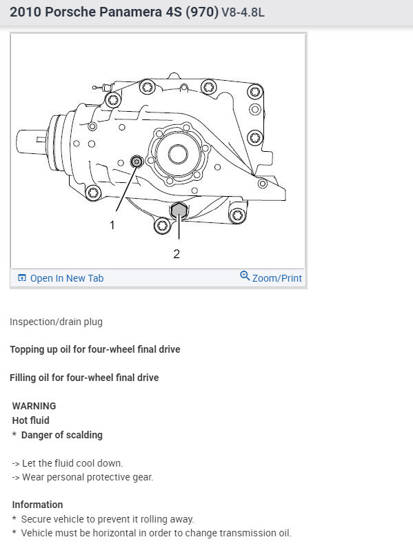

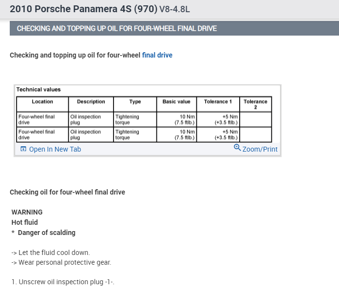

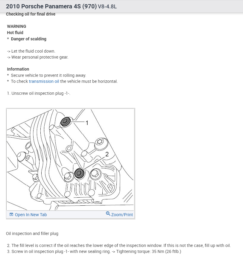

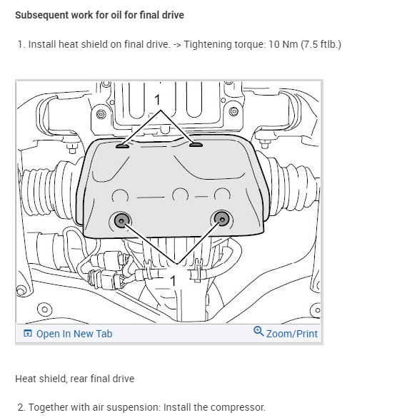

It calls for SAF Carbon Mod 1 (Porsche Part No.000.043.300.37).
I have attached the procedure for both front and the rear below.
Let me know if you have any questions.
