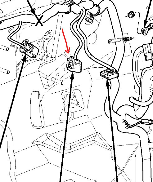

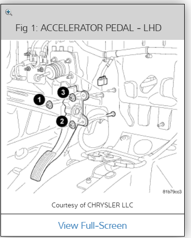

Here is how to change out the throttle position sensor in case you want to try replacing it. It looks like one electrical connector and three mounting nuts. Check out the images (below). Please upload pictures or videos in your response to the problem so we can see what's going on.
