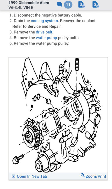

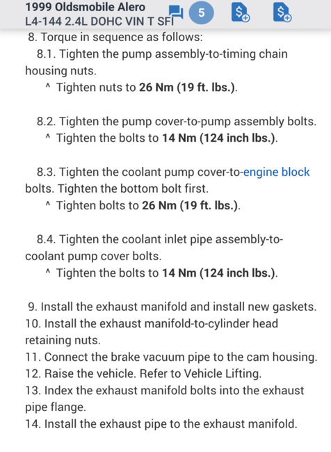

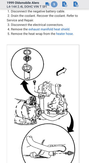

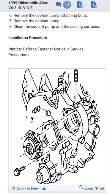

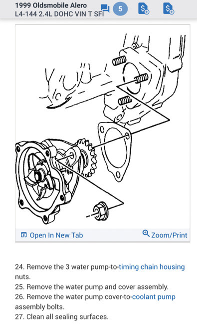

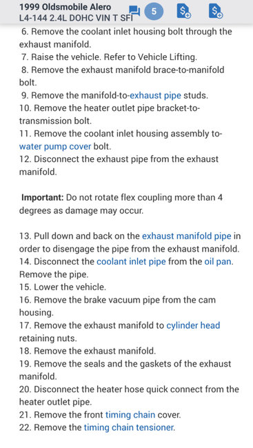

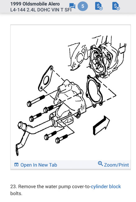

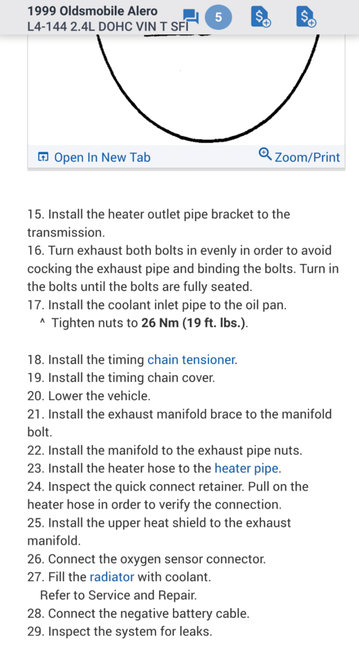

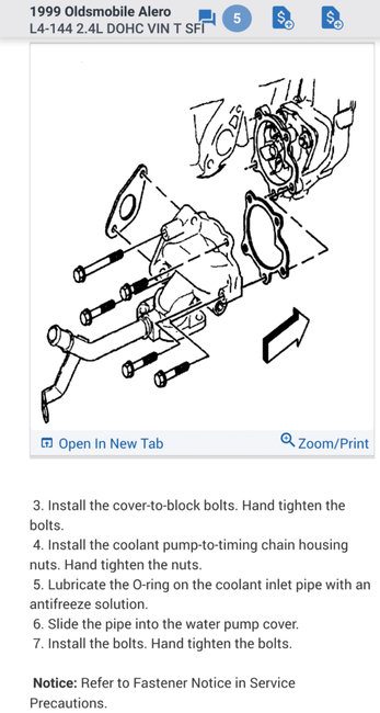

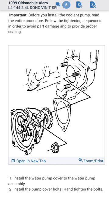

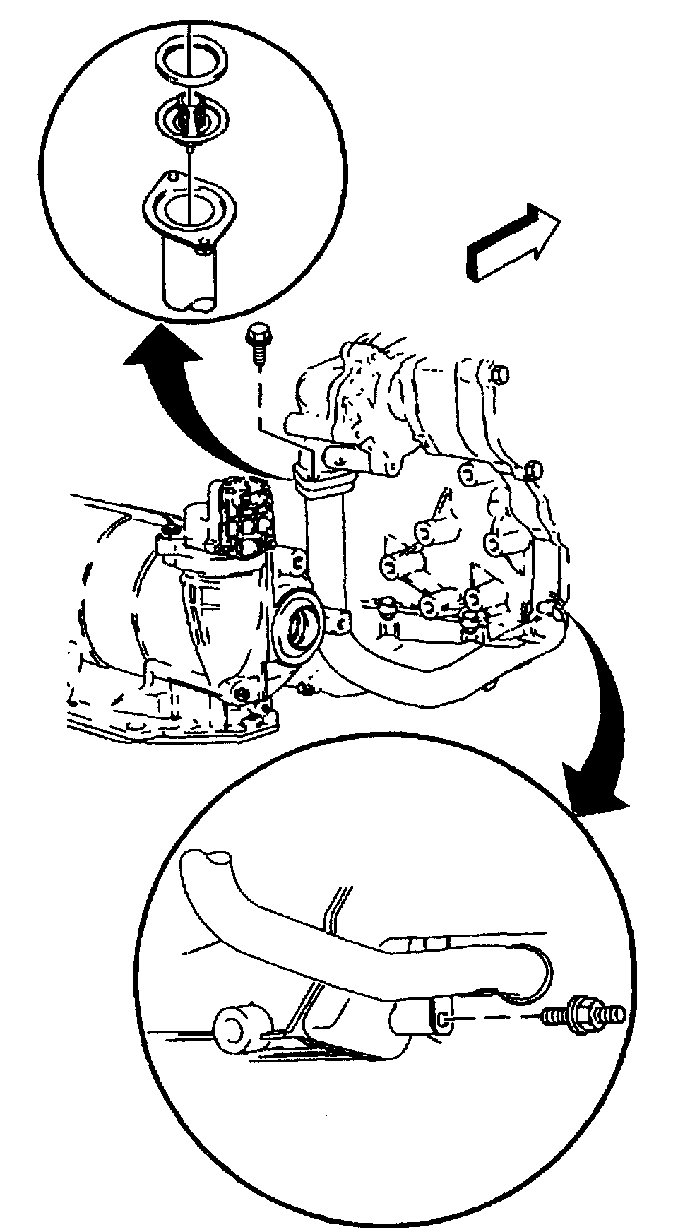

A couple of tips.
No matter which engine you have, it is vitally important to clean the mounting surfaces and make sure that any remaining old gasket pieces are gone. Failure to do so will result in a leak and having to do it all over again.
Also, I personally always use gasket sealer/maker in conjunction with the proper gasket. This helps seal things up even better as well as helping you to keep the gasket stuck in place. Again, this is optional, but strongly recommended.
Good luck to you. Be sure to come back any time.
