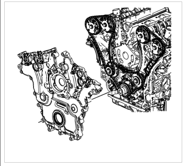

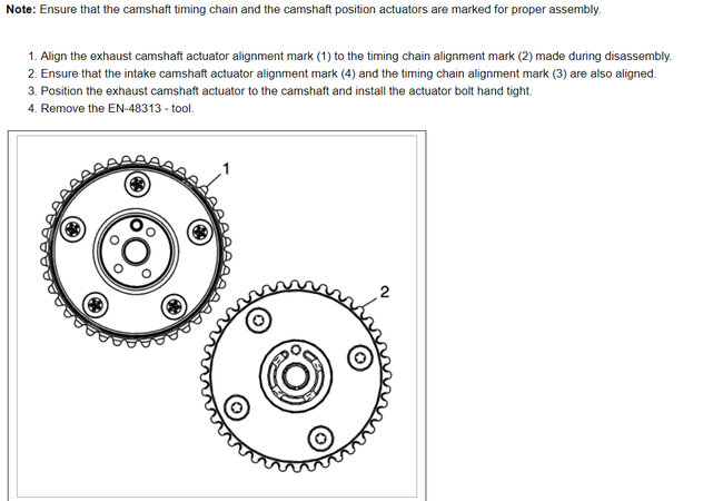

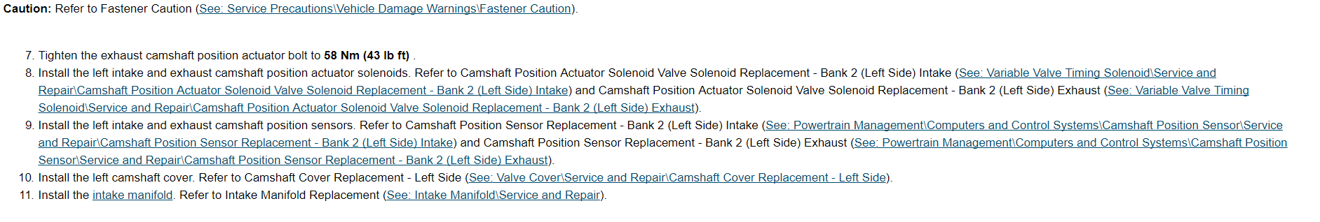

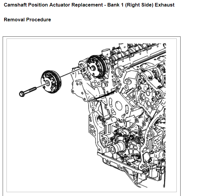

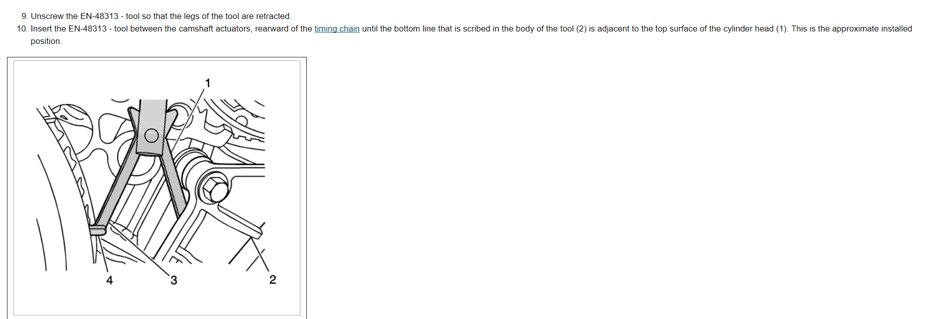

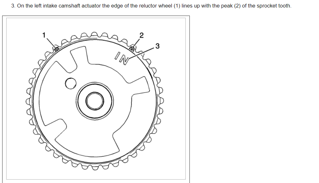

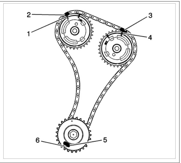

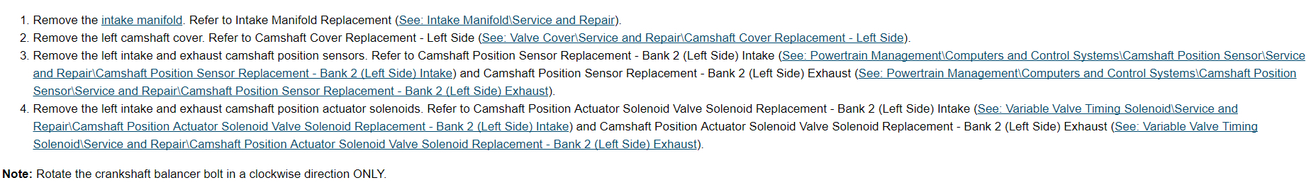

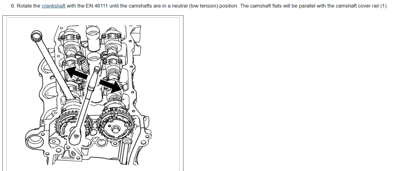

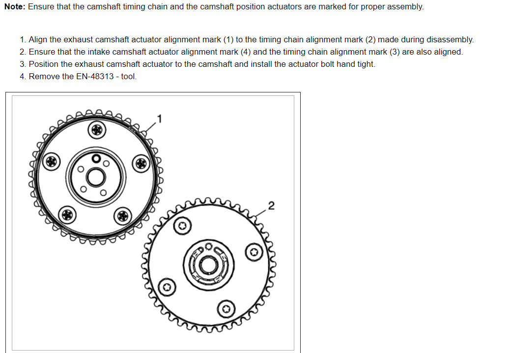

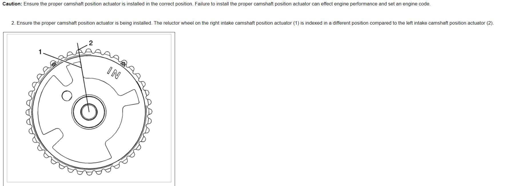

Hello, You must start by disconnecting the battery to avoid shorts. Then you will need to remove the serpentine belt and the balancer along with the timing cover. Here are some guides to give you an idea for what you are if for to get the job started:
https://www.2carpros.com/articles/replace-serpentine-belt
and a video to get the balancer off of the engine.
https://youtu.be/NZIMNkLxCMA

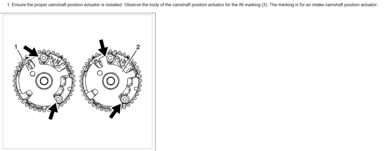

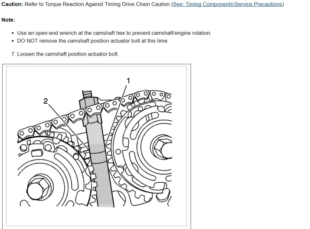

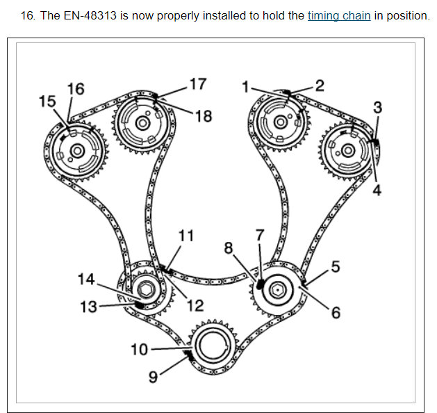

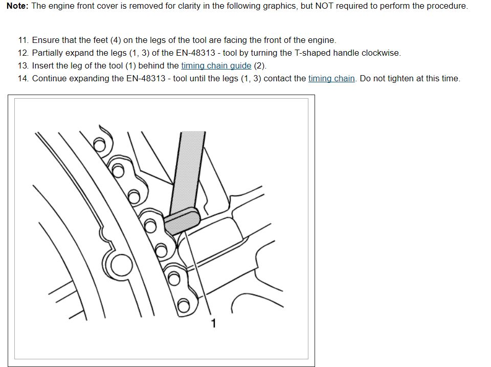

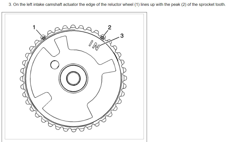

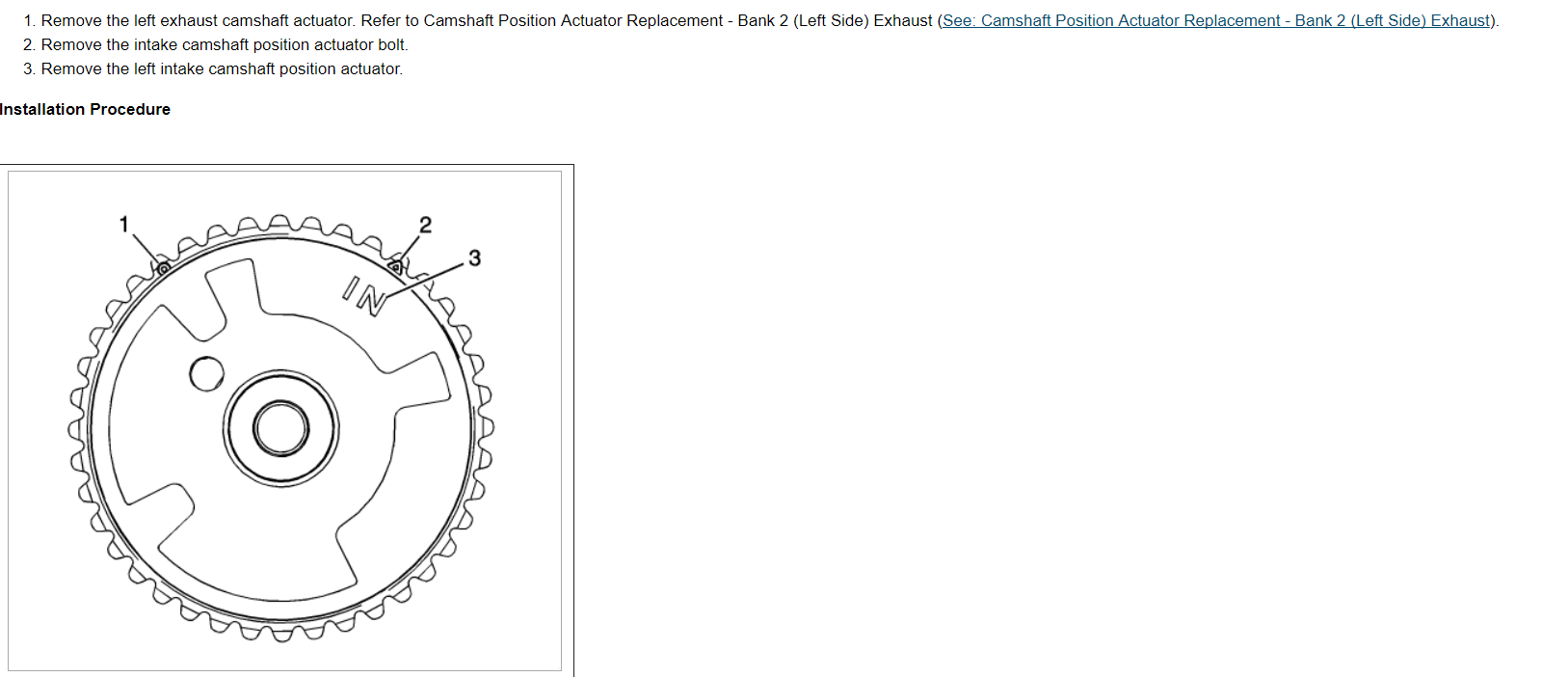

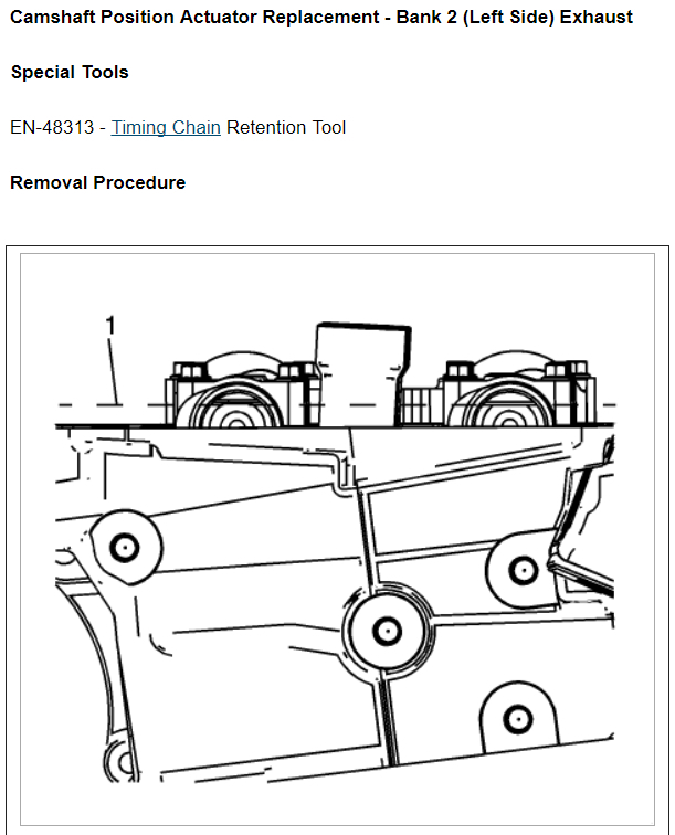

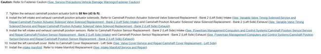

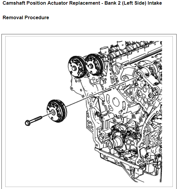

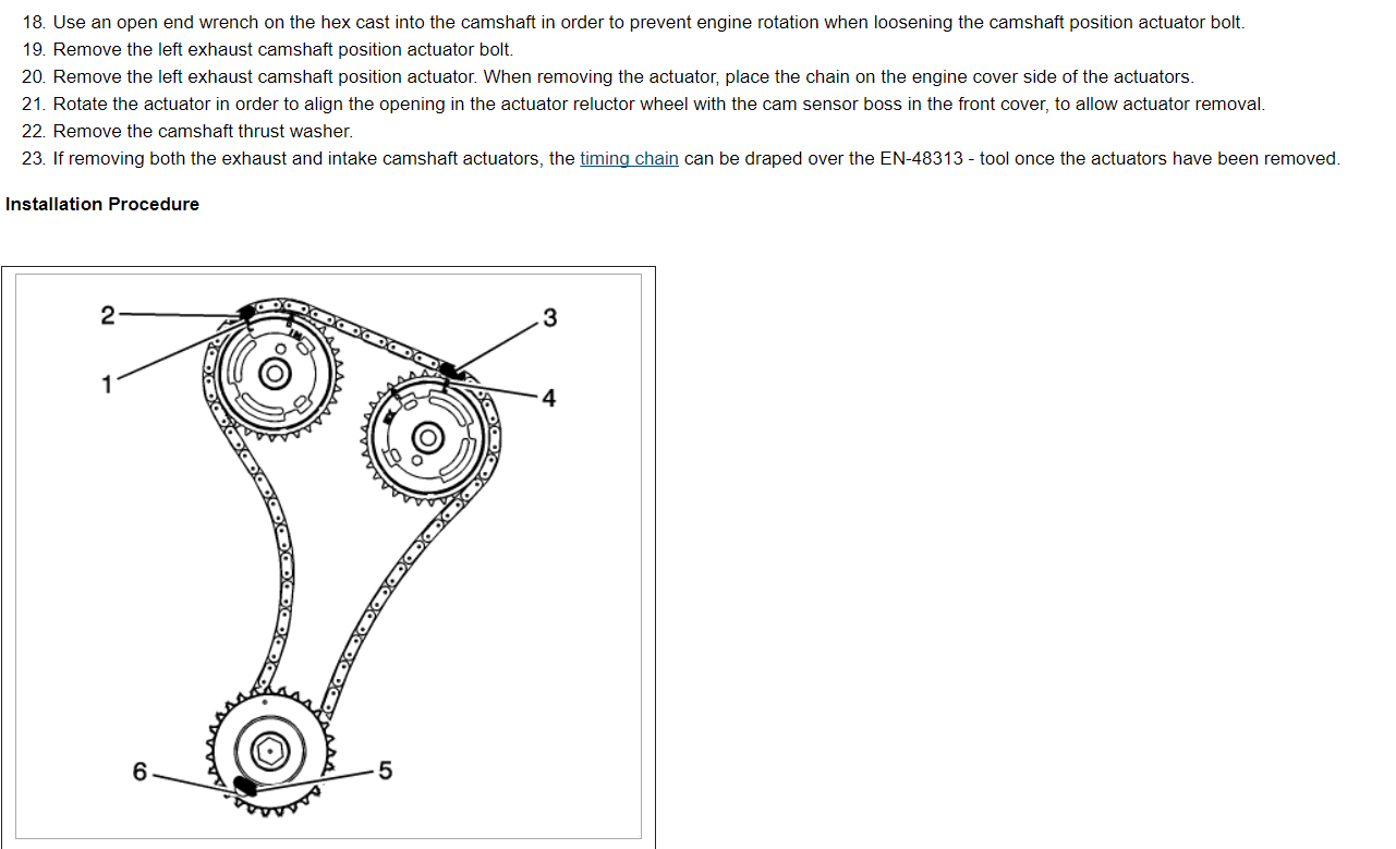

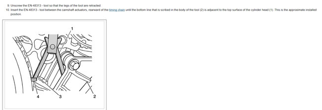

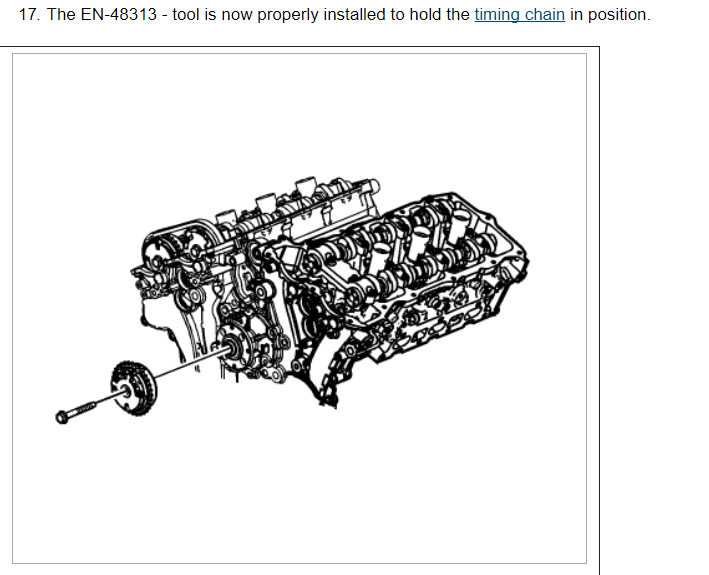

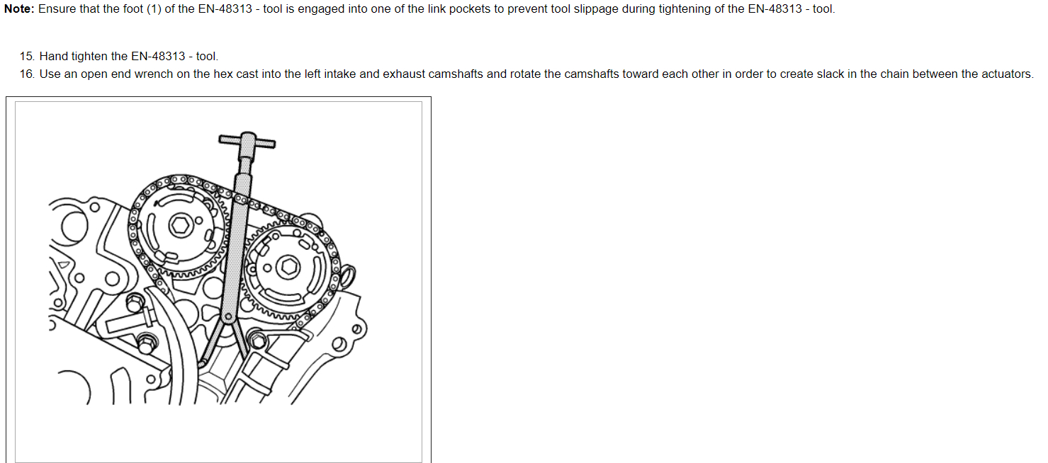

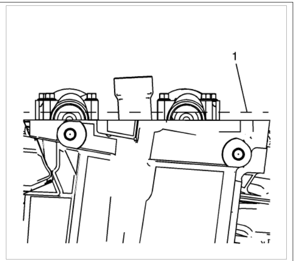

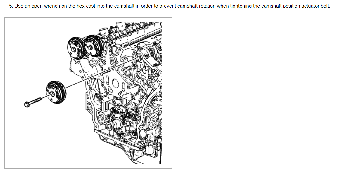

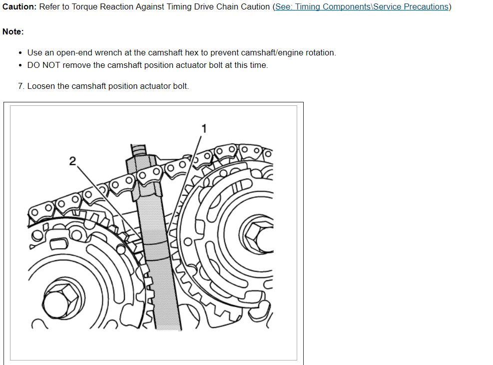

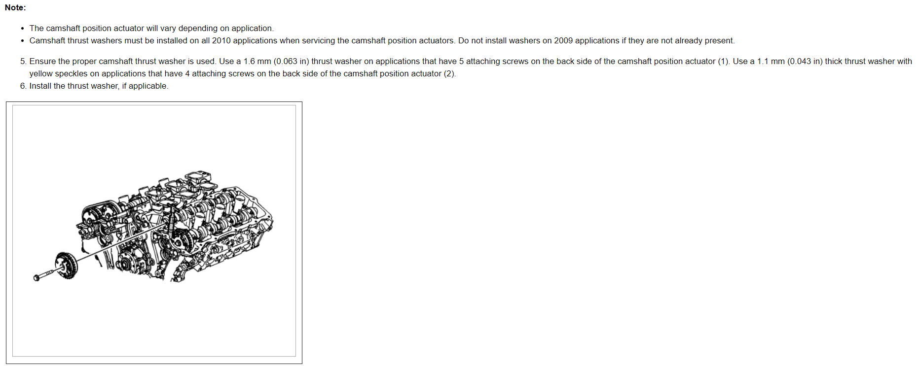

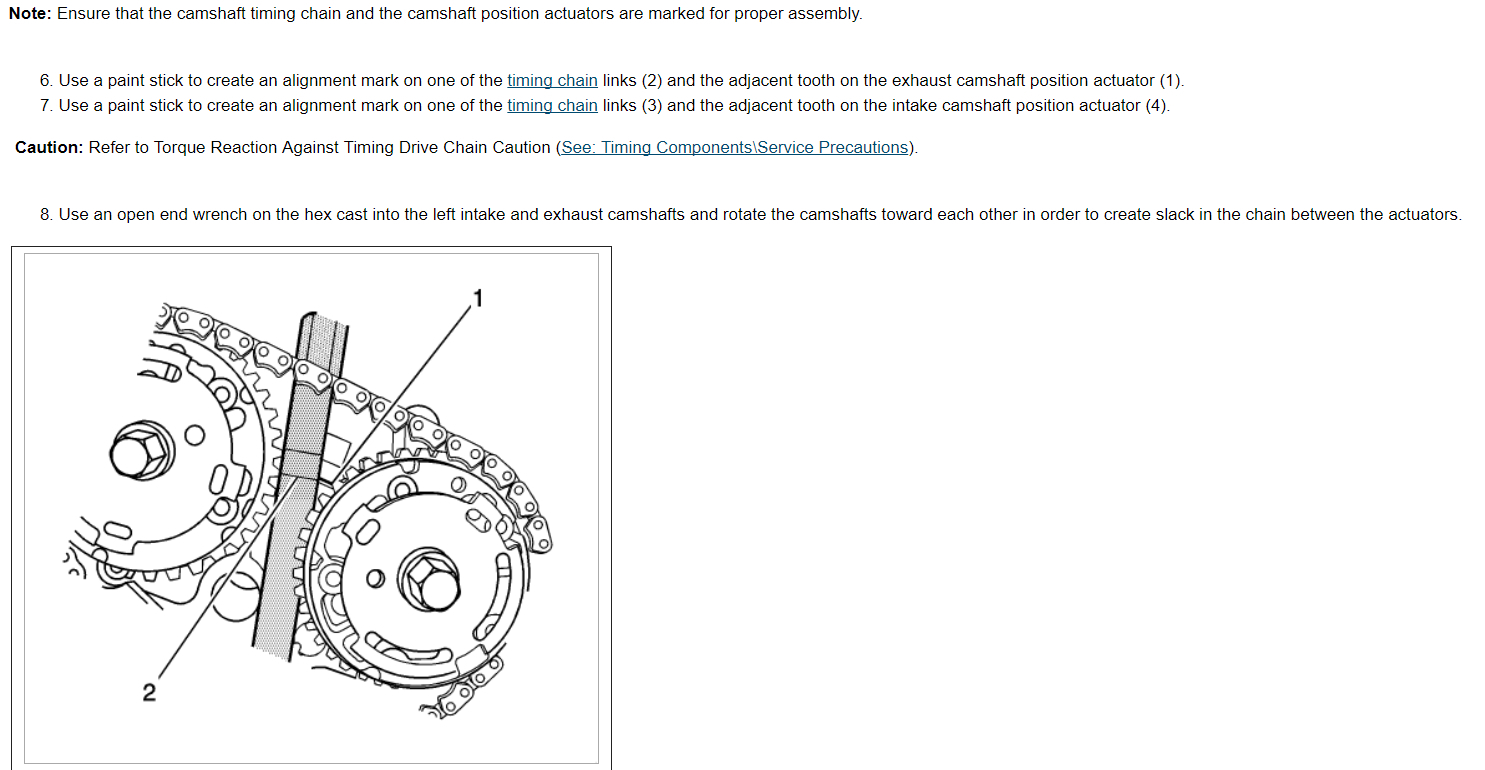

Below are the diagrams you will need to do the timing chain and actuators for your car.
