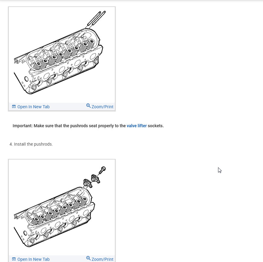

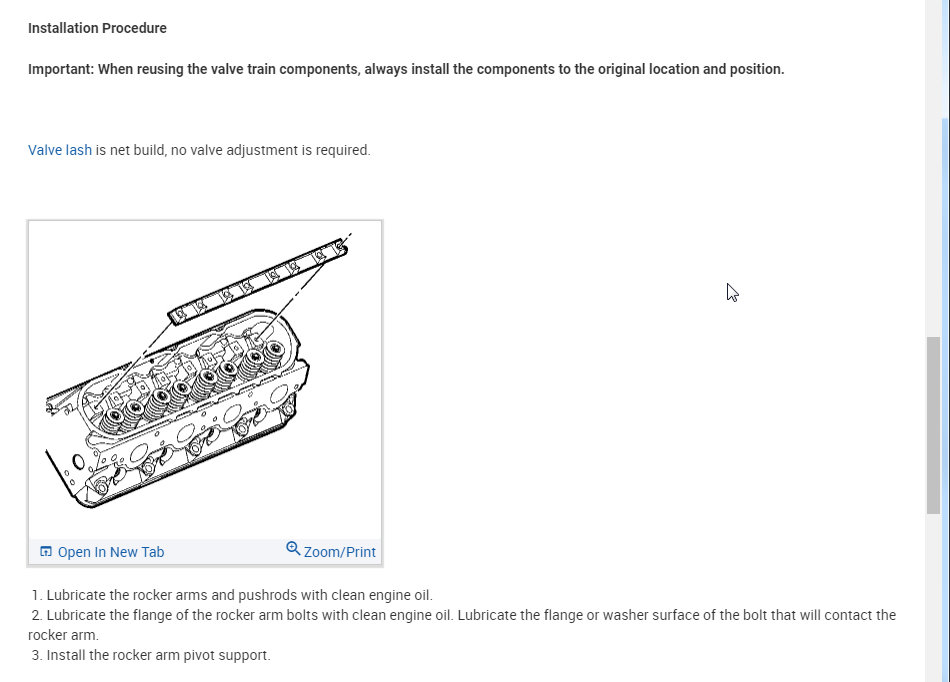

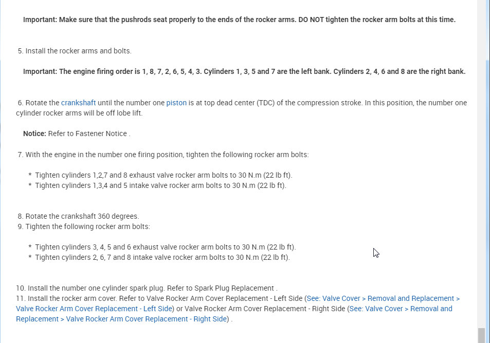

Replacing lifters, wanted to know how should I adjust the rocker arms after I'm done.
Aug 19, 2020 at 6:40 PM
I attached the process for this. There is not a traditional way of adjusting them as they come already adjusted but there is a specific tightening process so make sure you follow those steps. Let us know if you have questions. Thanks
