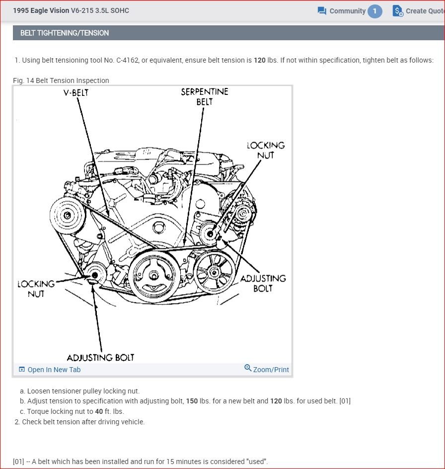

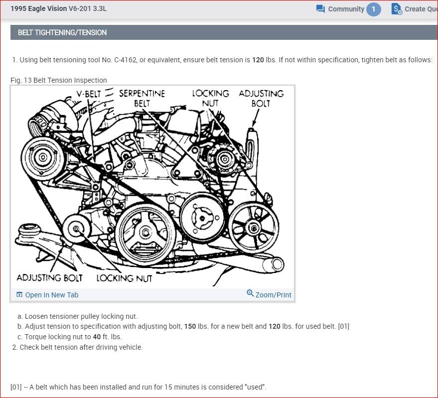

We cannot locate how to adjust the tensioner for the compressor. Where is it located? My belt is currently squealing every time the compressor kicks on and would like to see if adjusting it will fix it up.
May 16, 2019 at 5:40 PM
Hi Shannon,
Here is the procedure for adjusting the belt on both engine options. Please take note of each engine at the top of the page.
Please let me know if you need anything else. Thanks
