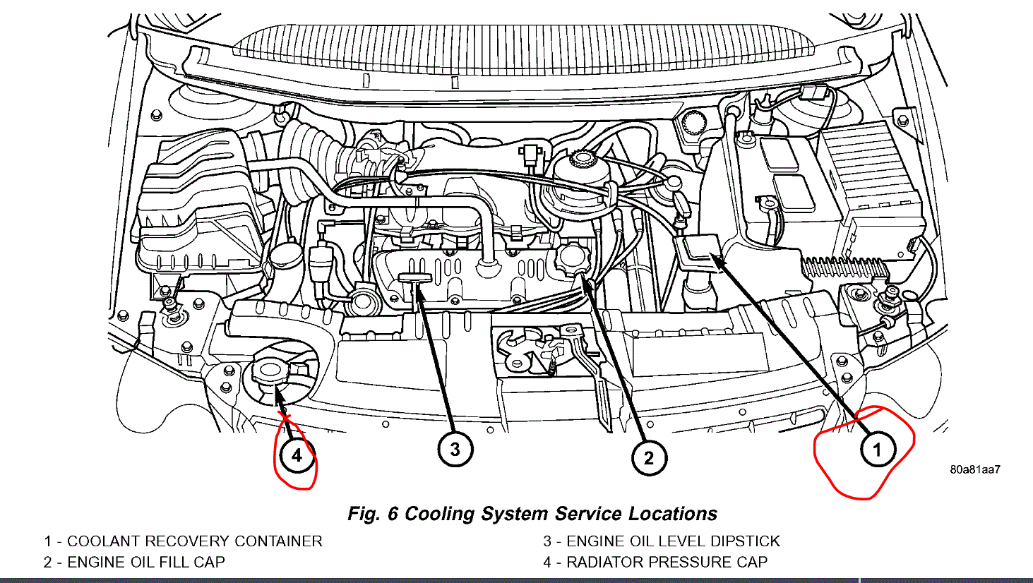

Here are the directions straight from the repair manual. The attached pic correlates with this. I circled the two locations for filling.

Fig.6
See pic 1
Remove radiator pressure cap and fill system, using a 50/50 mix of Mopar Antifreeze/Coolant, 5 Year/100,000 Mile Formula and distilled water.
Continue filling system until full. Be careful not to spill coolant on drive belts or the generator.
Fill coolant recovery/reserve container to at least the MAX mark with 50/50 solution. It may be necessary to add coolant to the recovery/reserve container after three or four warm up/cool down cycles to maintain coolant level between the MAX and MIN mark. This will allow trapped air to be removed from the system.
