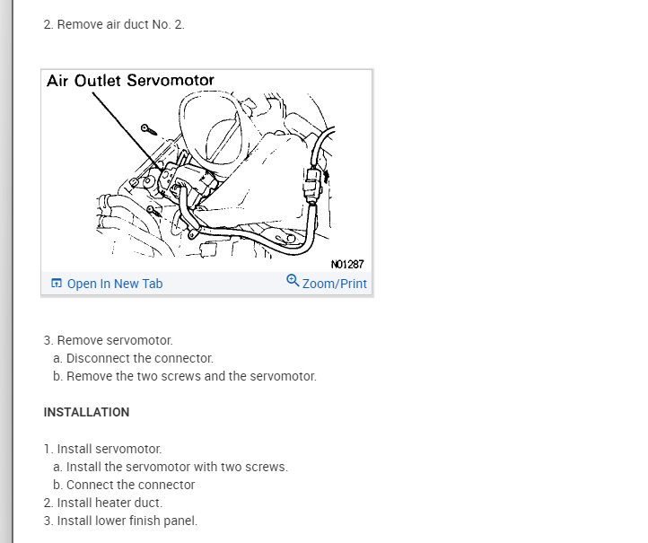

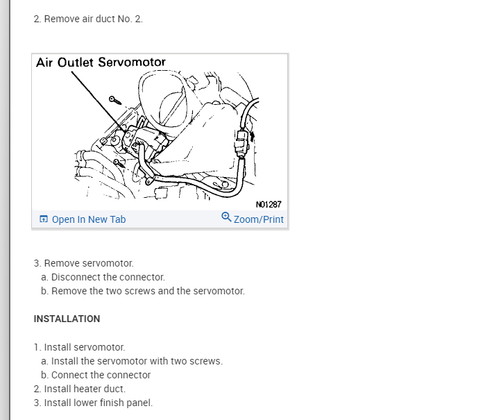

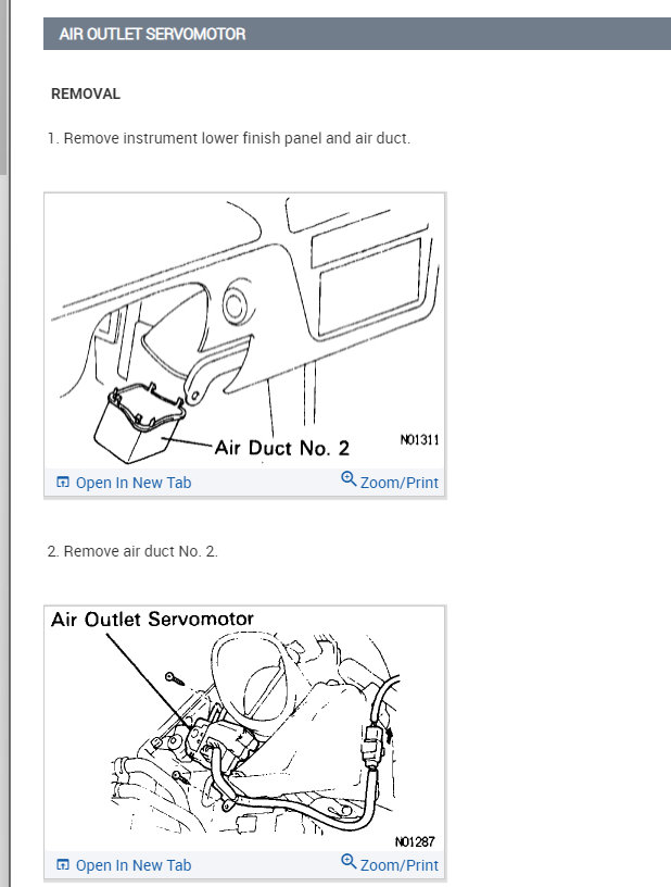

Does anyone know how I can access the center air vent damper on the car listed above? I have no air coming out of the center vents, but I have air coming from the side vents, and I suspect it might be the center air vent damper.
Thanks for any and all help.
