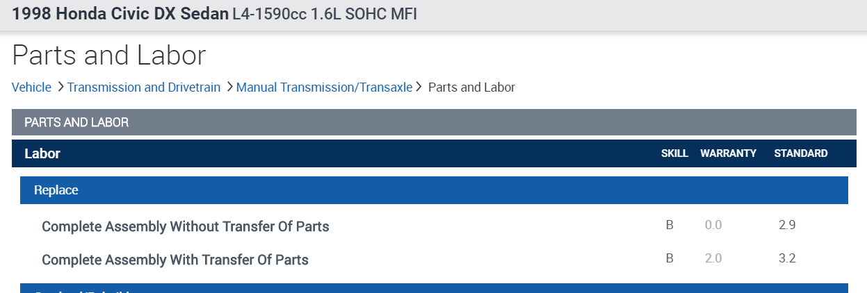

I'm looking into buying a used transmission and having a shop put it in for me. around how many hours do you think it'll take?

I attached the labor time for removal and replacement. The only difference is if it's a complete assembly or a transfer of parts. See pic 1.
Let me know if this helps.
