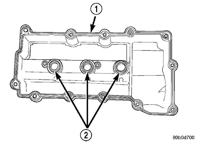

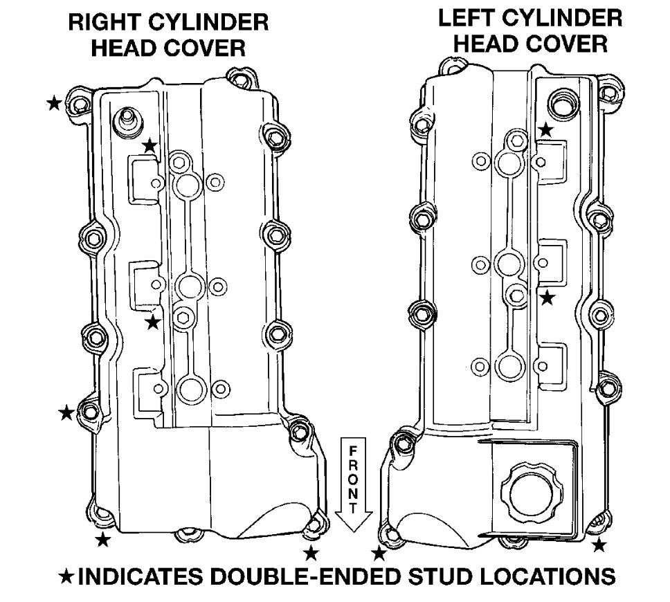

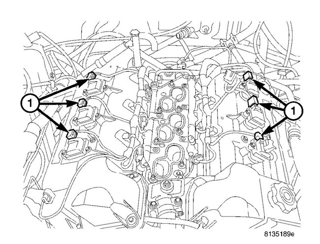

Hello again.
How long between replacement did it do again (code set/oily deposit)?
Also, the mileage in between. Probably the valve cover gasket leaking oil into the spark plug well.... fairly common issue
Since you have to remove the upper intake to do this and one side is leaking you may want to consider replacing both sides while it is apart.
Let me know. Thanks again for using 2CarPros.
Danny-
Some diagrams below of replacing V/C gaskets
