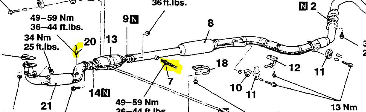

Looking to see how many O2 sensors are there.

There are only two on this vehicle, an upstream and a downstream. I attached a picture below showing both of them on the exhaust system. I highlighted them for you.
Let me know if this helps or if you have questions.
joe
See pic below.
