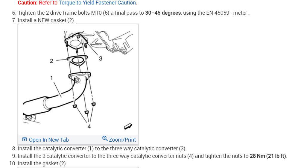

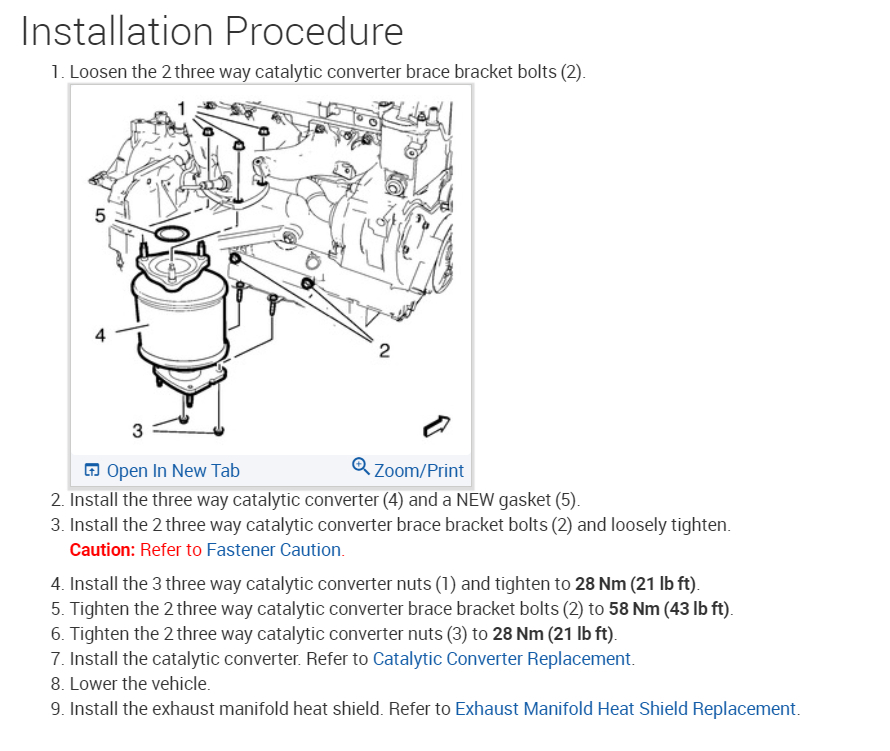

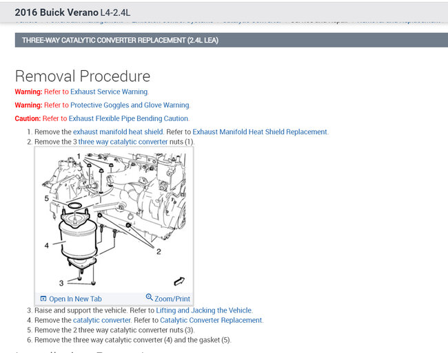

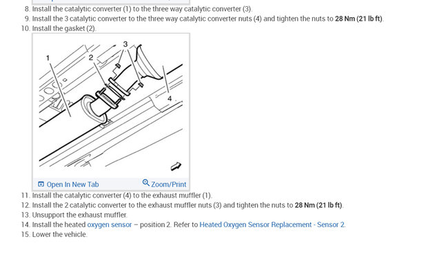

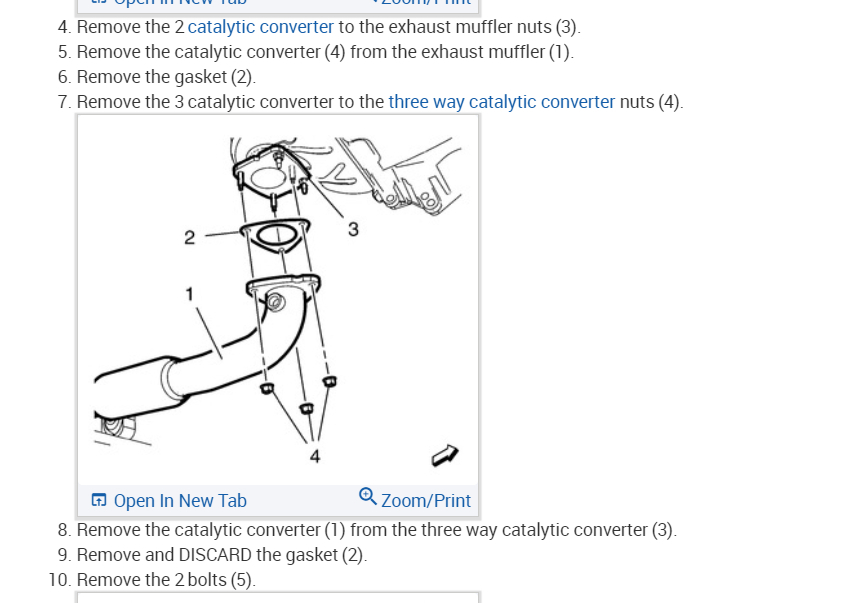

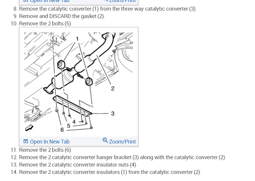

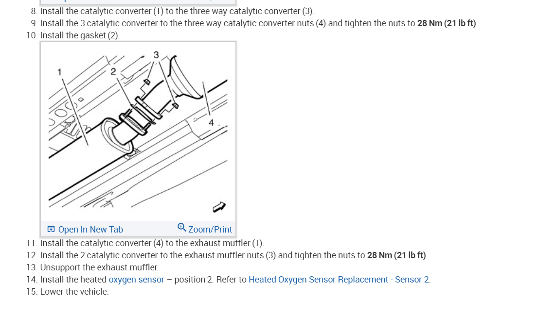

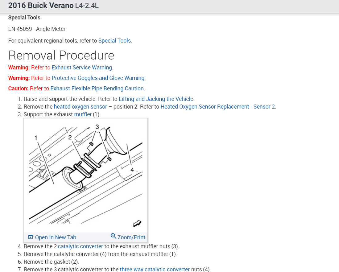

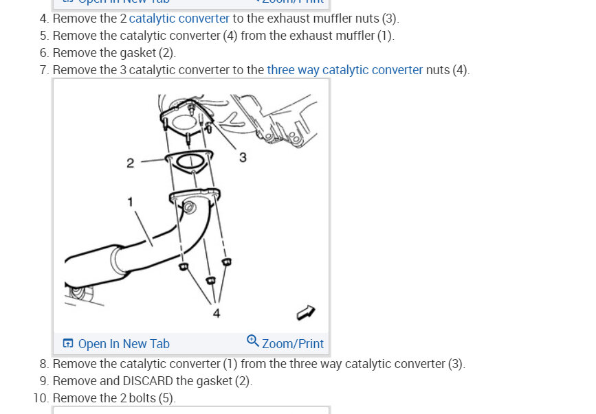

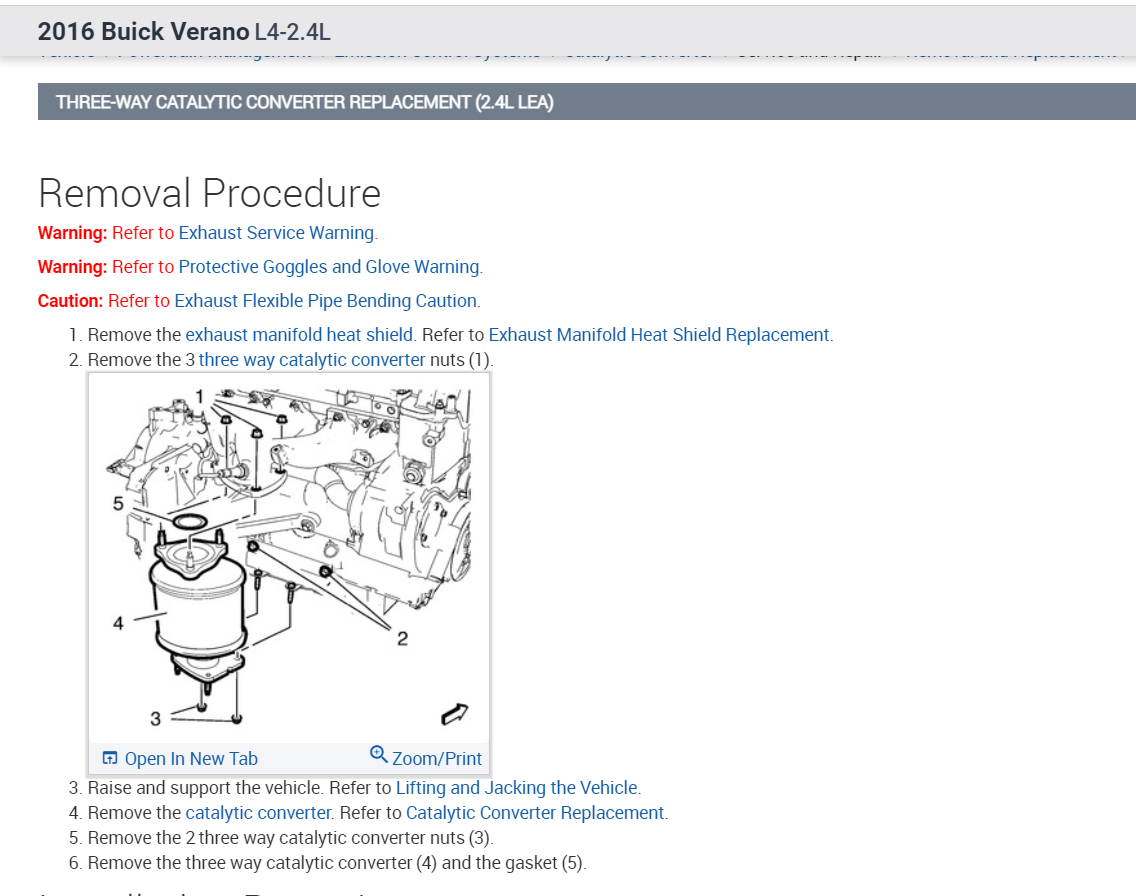

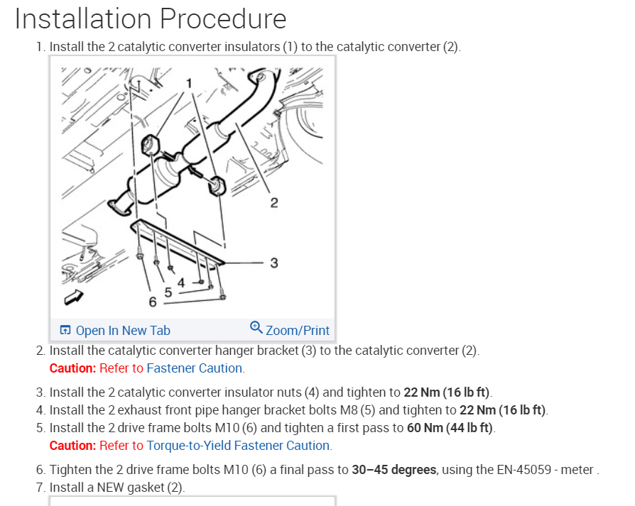

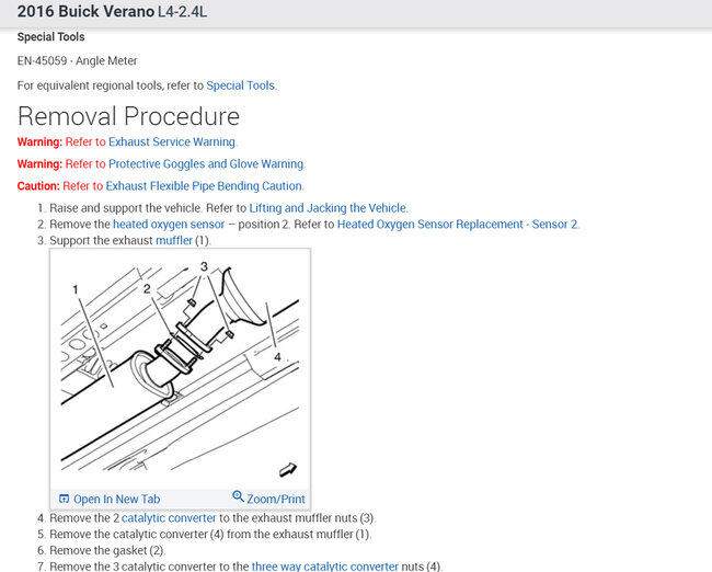

So, you have 2 catalytic converters. The primary converter is bolted to the exhaust manifold which is what they call a 3-way cat and a secondary cat which is down from the head pipe in the exhaust system. Here are the instructions on how to change them and their locations as well, can I ask what kind of problem you are having? Check out the images (below). Let us know what happens and please upload pictures or videos of the problem. Also, if you have codes, please include them so I can tell you which catalytic converter you need.
