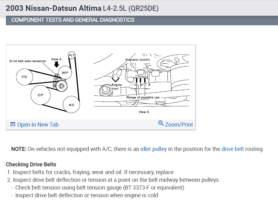

It keeps throwing the belt. I have installed a new belt tensioner. I don't have a lot of money to replace the pump.
Aug 28, 2022 at 3:53 PM
It will need to be trial and error, I would use a string to put around the pulleys and then measure the string to get started here is a diagram for the belt to help you get an idea of the belt you need, the car will be hard to steer so please consider replacing the pump.
