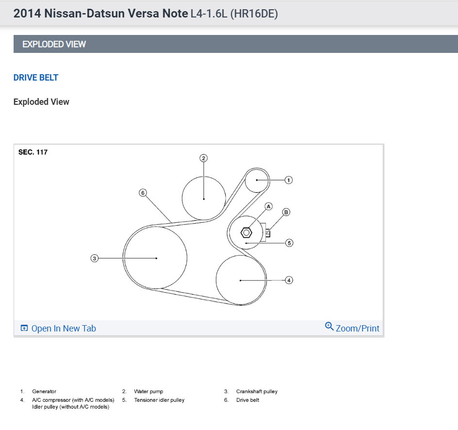

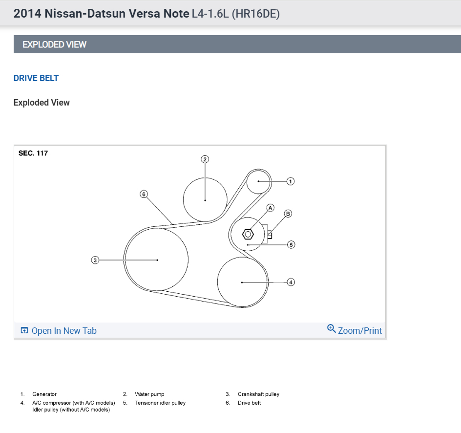

They should last about 100,000 but I have seen them go out before can you open the hood and take a short video of the noise that way, I can tell what's going on you can upload the video with your response. Also, you can remove the serpentine belt to spin each of the parts to see which one is making a grumbling noise which means it is bad.
here is how to remove the belt in the diagrams below:
This generic guide can help walk you through the steps
https://www.2carpros.com/articles/replace-serpentine-belt
Check out the images (below). Let us know what happens and please upload pictures or videos of the problem.
