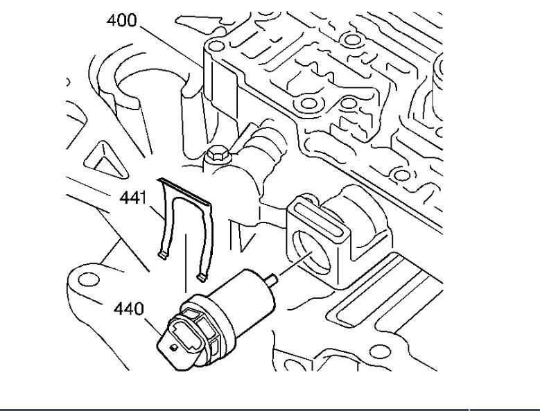

The sensor is inside the side cover of the transmission. The side cover case has to be removed in order to access the valve body for the sensor.

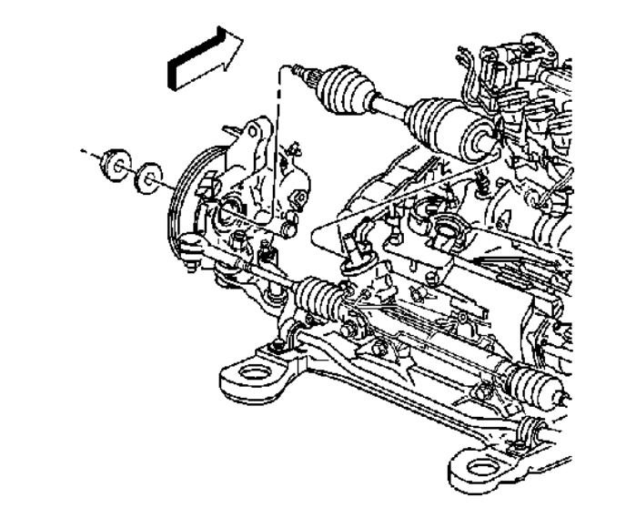

To remove the cover, you need to remove the axle shaft, drop that side of the cradle that holds the engine and transmission in order to get the correct amount of room to release the cover.

Removal Procedure
1. Remove the case side cover.
2. Disconnect the transaxle wiring harness.
3. Remove the input speed sensor clip (441) from the case cover.
4. Remove the input speed sensor (440) from the case cover.

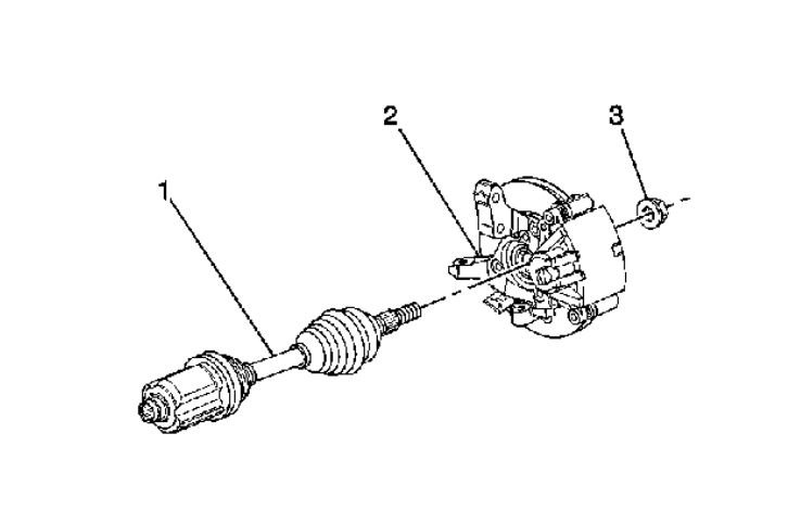

You need to remove the wheel, brake caliper, mount and the nut for the axle. Then the lower ball joint has to be released to allow enough movement to remove the out part of the axle. Then you can remove the axle shaft.
