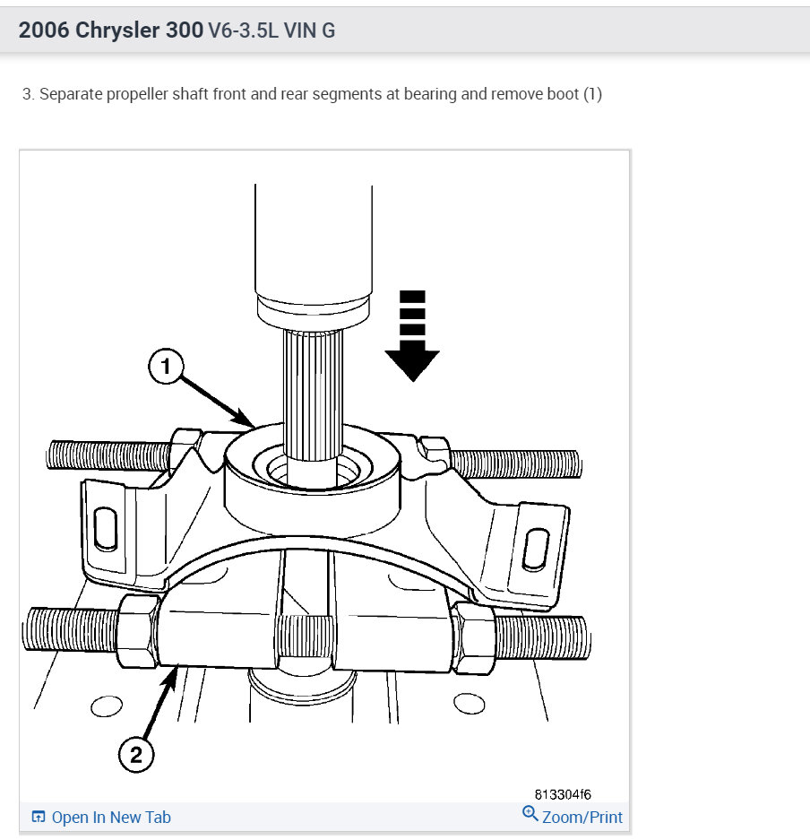

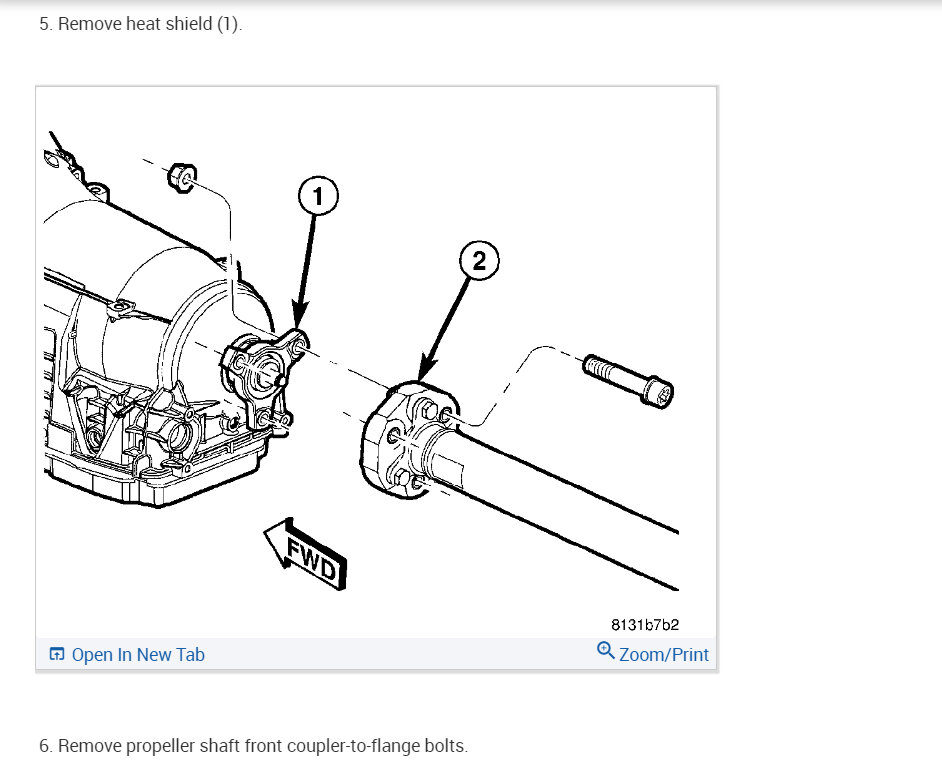

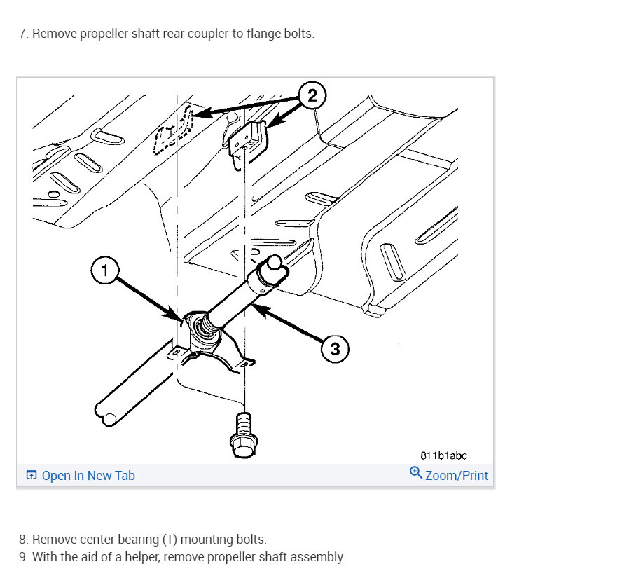

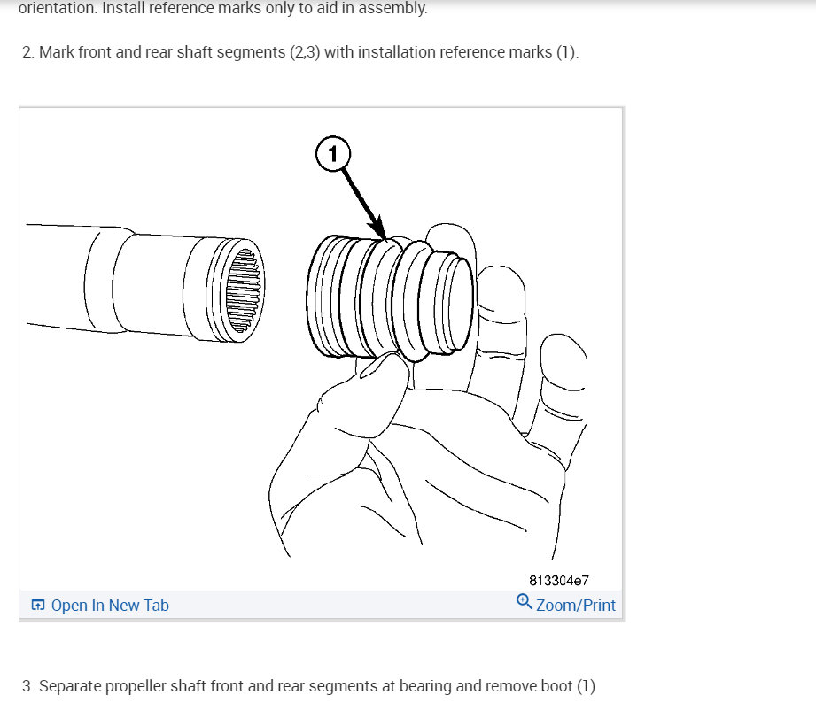

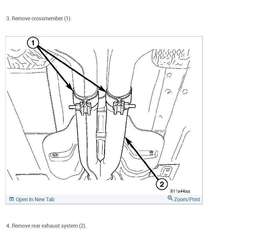

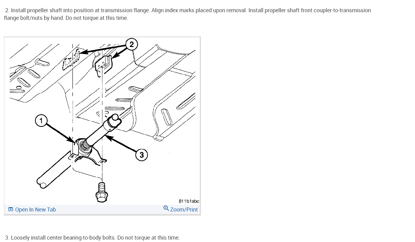

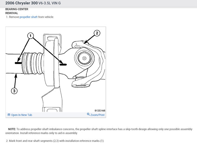

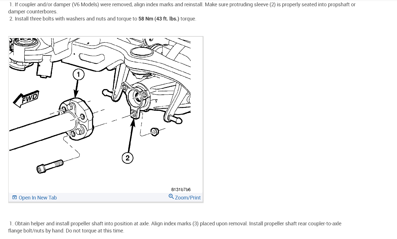

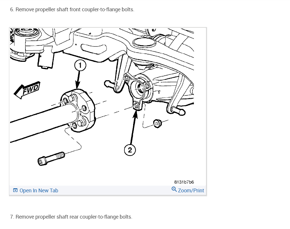

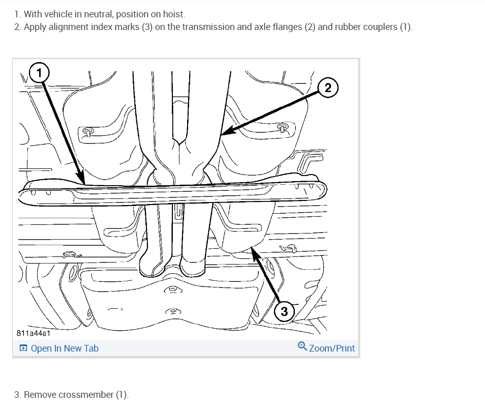

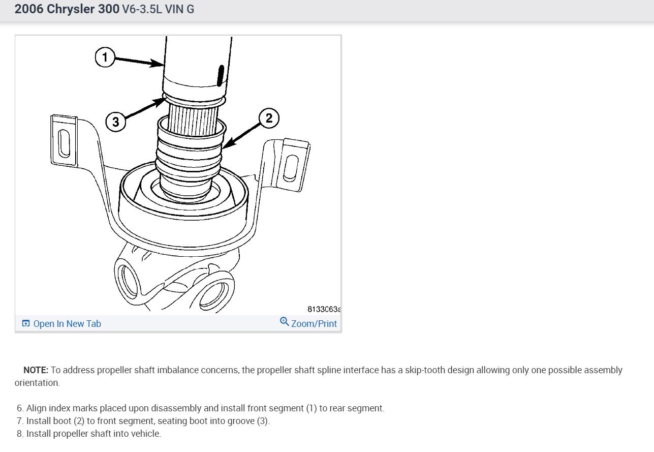

I'm replacing the carrier bearing on the car listed above, rwd. I have my driveshaft taken off, I just can't get the driveshaft to pull apart, so I need help with that.
May 29, 2023 at 5:24 AM

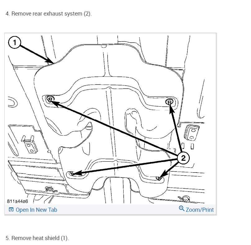

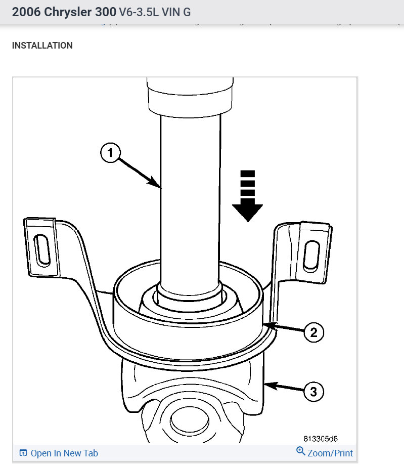

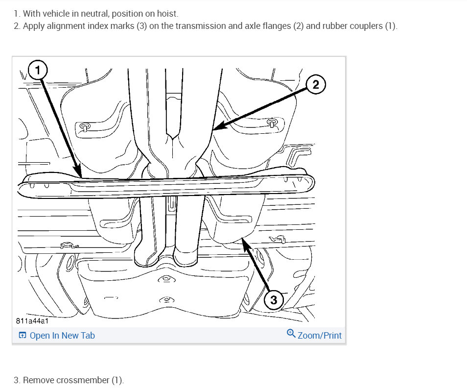

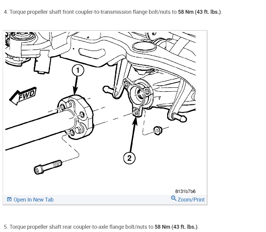

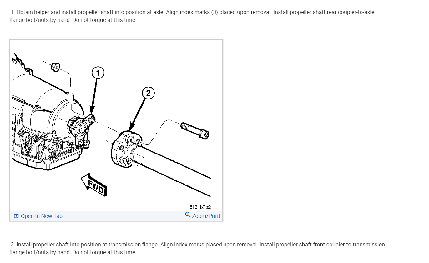

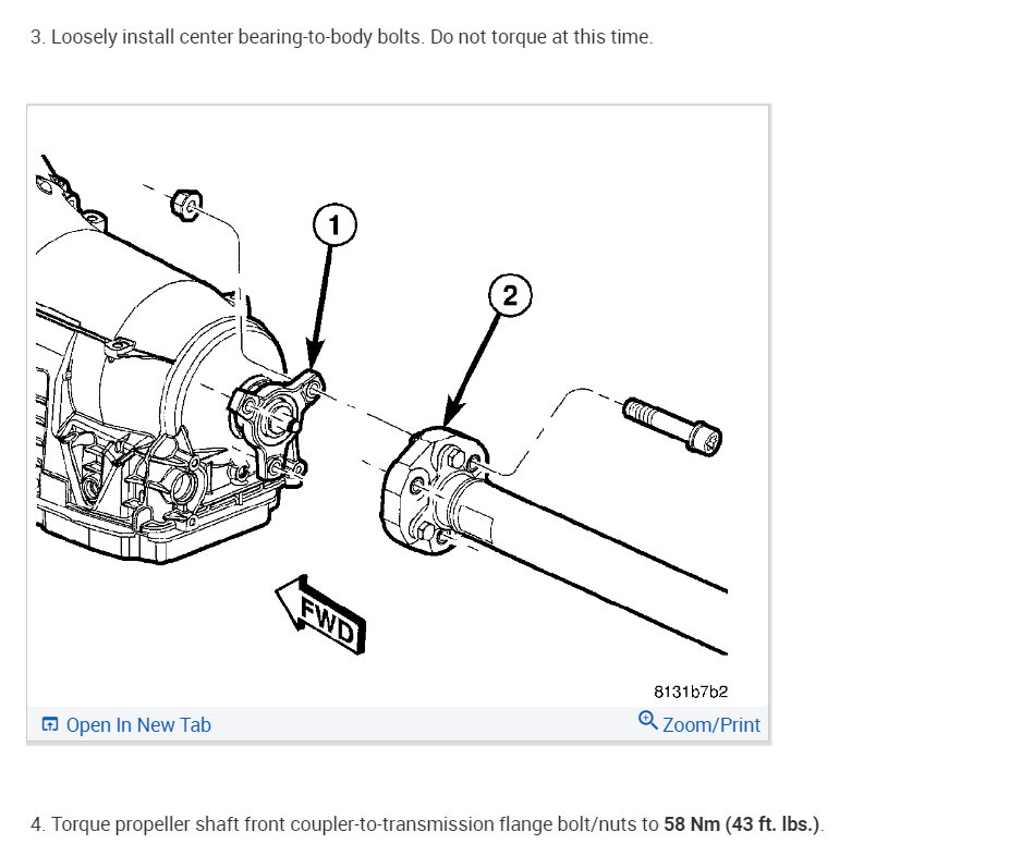

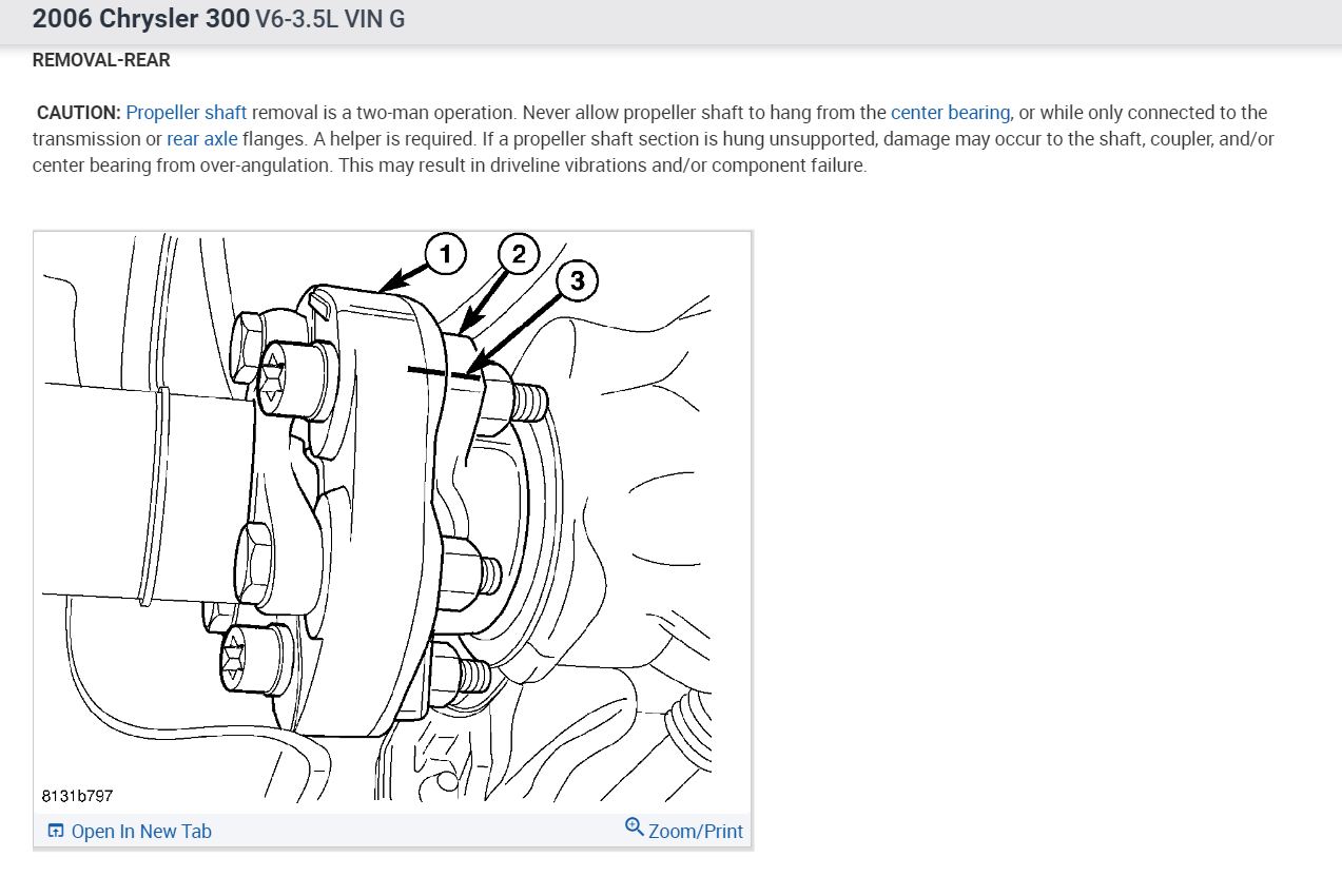

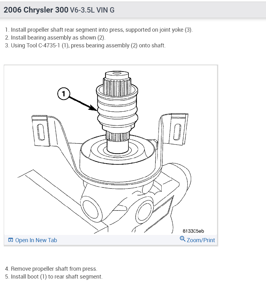

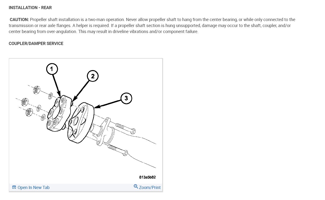

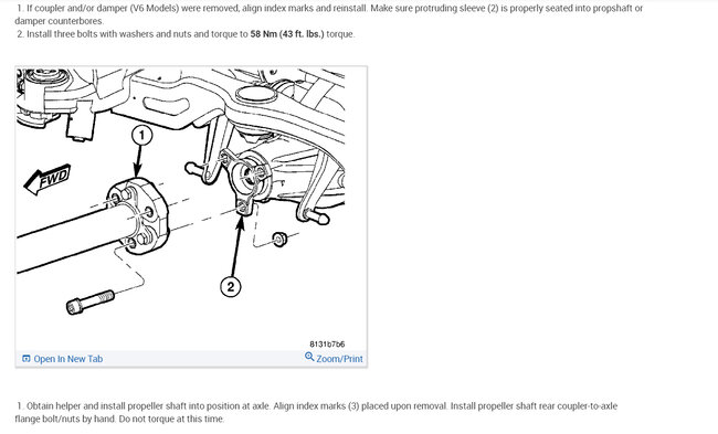

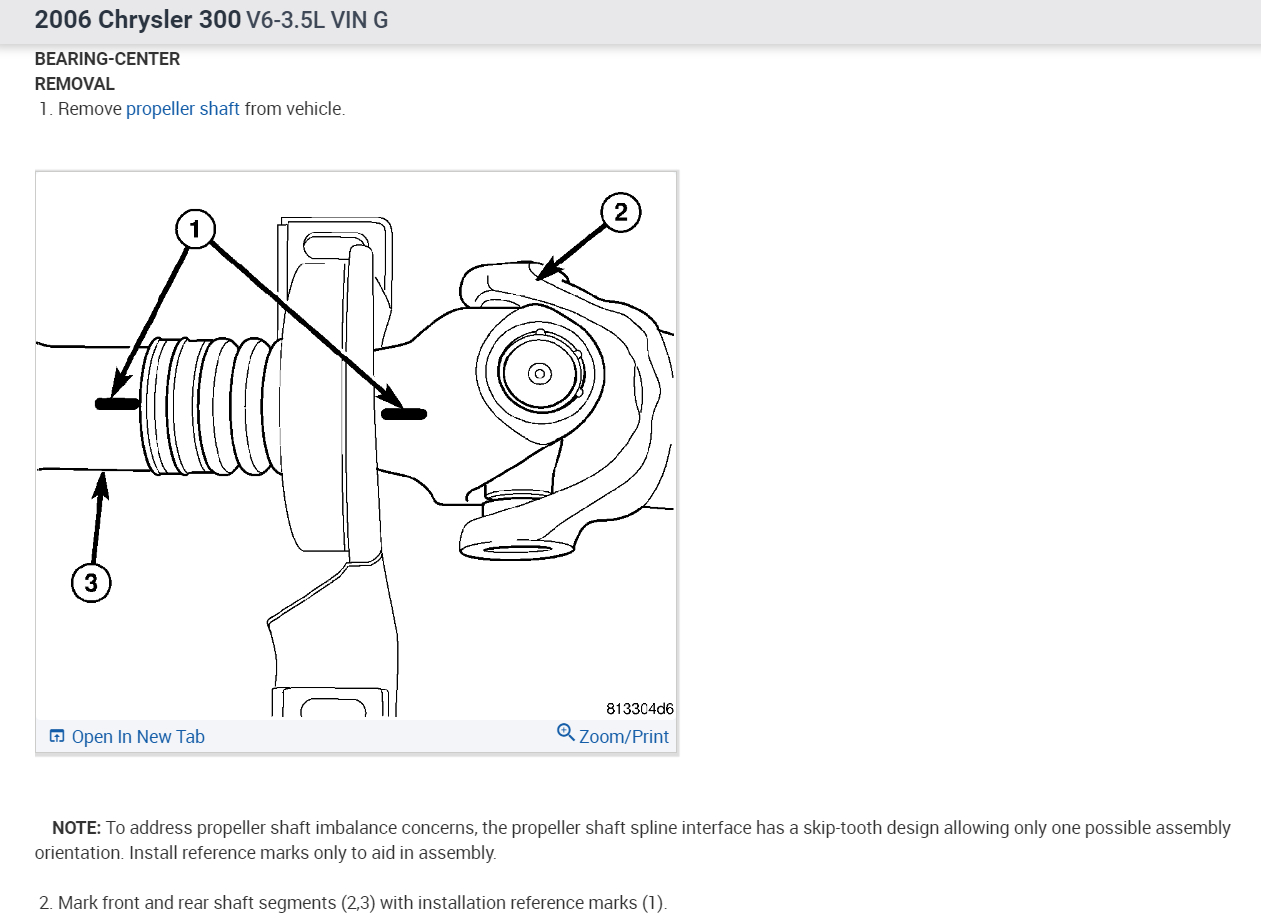

Yep, here are the instructions on how to remove the driveshaft and the center support bearing on the car above. Check out the images (below). Please let us know if you need anything else to get the problem fixed.
May 30, 2023 at 11:31 AM
