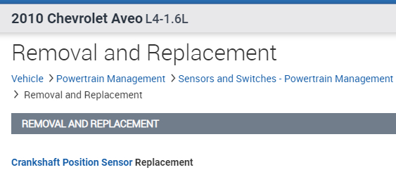

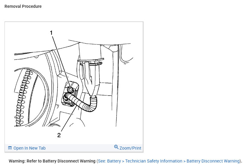

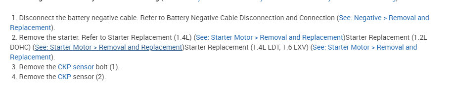

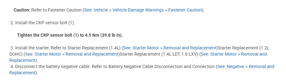

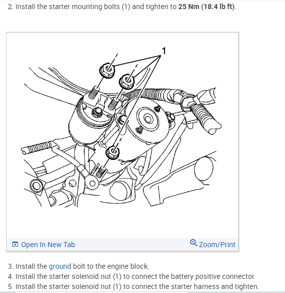

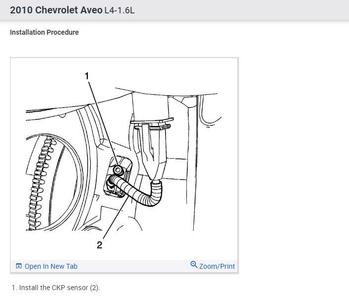

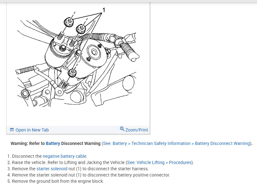

In general, these are usually an easy job. On your vehicle, the starter will need to be removed to access the sensor.
To get you started, here is a link that explains in general how it's done:
If you look below, I attached the directions specific to your vehicle for replacement. In sequence, I included the other tasks needed to complete the job.
See pics below.

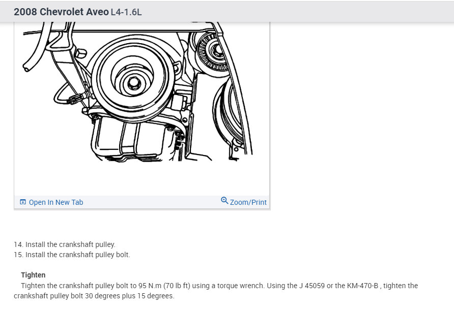

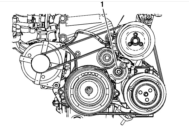

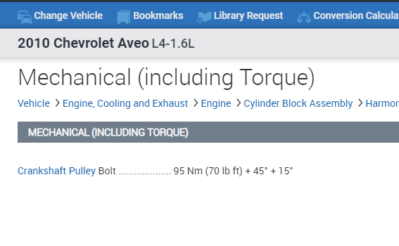

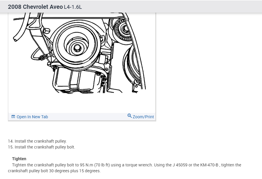

My manual doesn't show a replacement procedure. However, the removal is simple, but the space available makes it difficult.
If there is access via the wheel opening, that is the way I would go. Remove the wheel and fender liner to access the pulley.

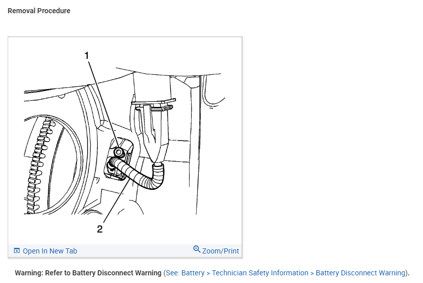

Next, remove the serpentine belt. Once that is off, remove the center bolt on the pulley/harmonic balancer. See pic 2 below. You will need a puller to remove the part from the crankshaft.

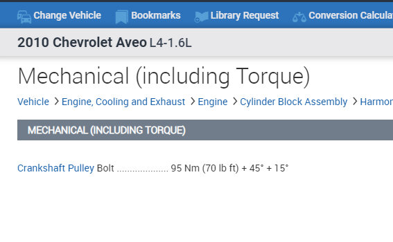

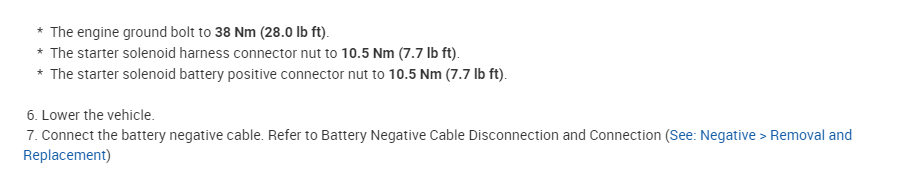

Reinstallation is the opposite of removal. I attached the torque specs below. (See pic 1)
Let me know if this helps.
See pics below.

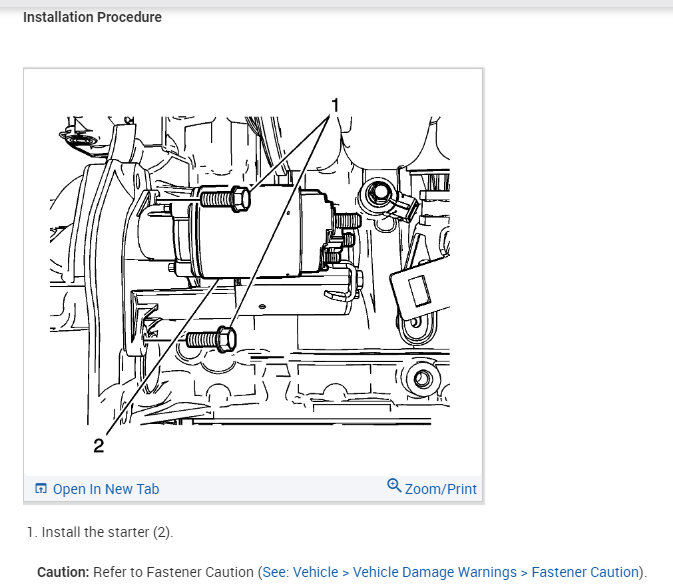

No problem. I was just wondering; how do you torque the crankshaft pulley without making the crankshaft move? Most applications have a holder tool. This crankshaft pulley don't look like there is any holes to install the tool to keep the crankshaft from moving.
Dec 7, 2022 at 8:07 PM

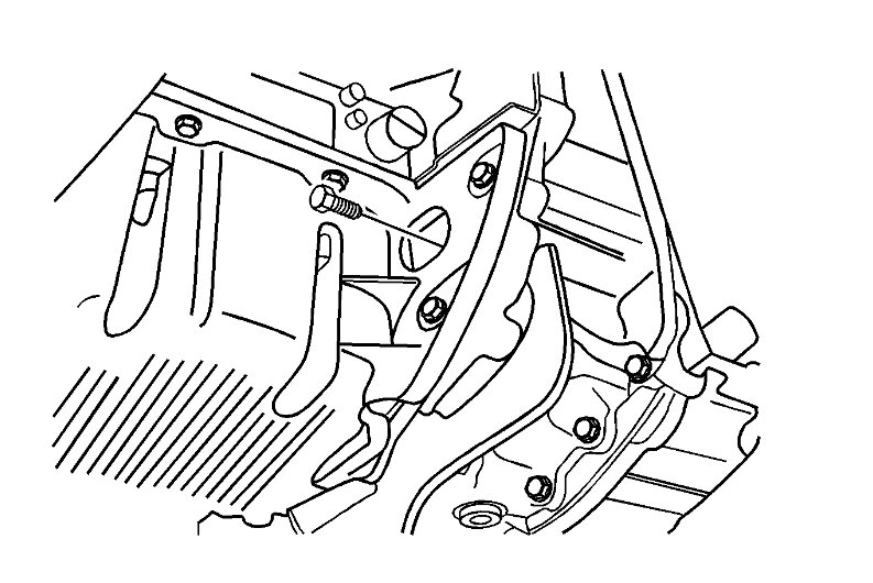

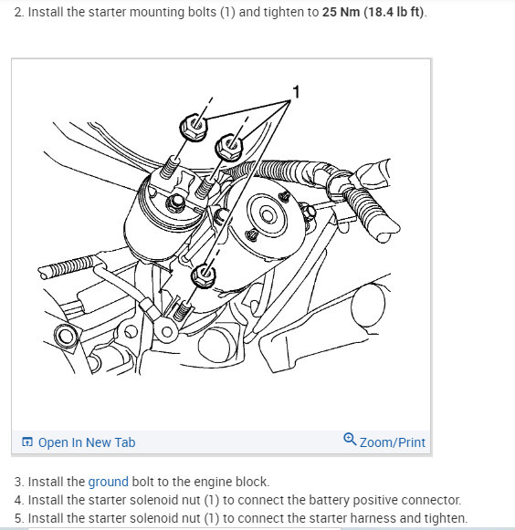

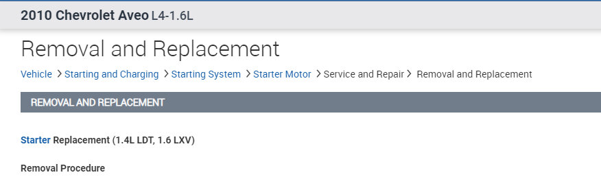

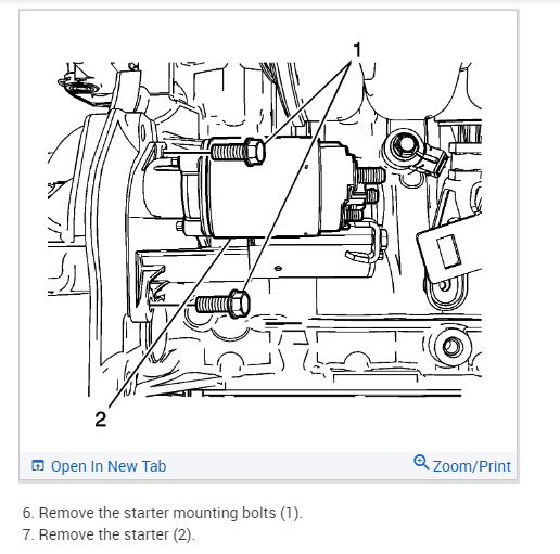

This is a tricky one. What I have done is to remove the transmission inspection plate or the starter and hold the flex plate. To make it a bit more difficult, they want the bolt torqued and then adjusted to degrees. See pic 1 below.
Pic 2 shows the service hall cover. If you remove that or the starter motor, you can prevent the crankshaft from turning.
Let me know if that helps.
Joe.
See pics below.
