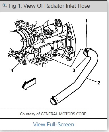

You get at it through the left wheel housing. Safely raise and support the vehicle. Remove the tire and wheel housing liner.
Number 4 in the picture is the thermostat housing.
Image (Click to enlarge)
