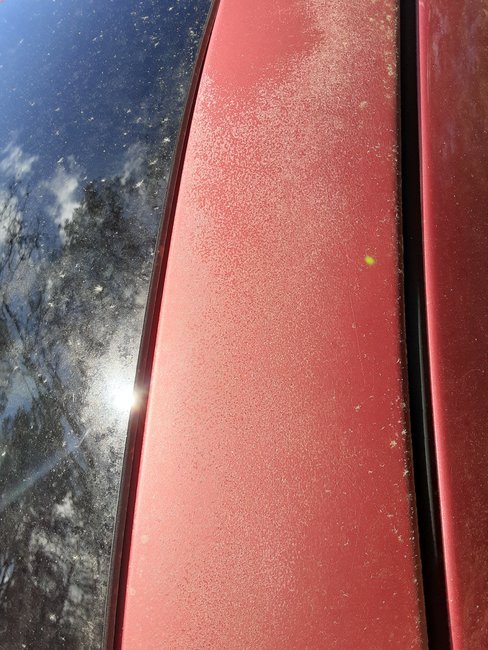

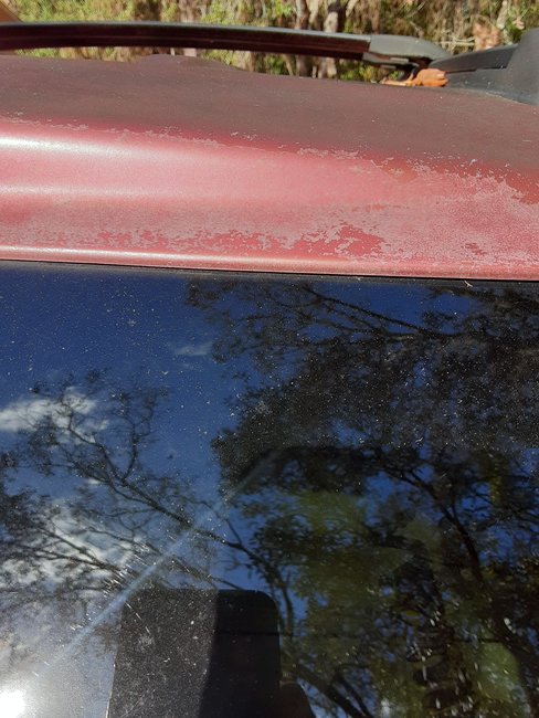

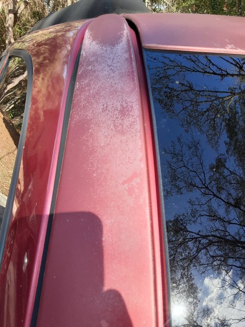

The body peels around the door have some bad fading, I guess that is what it is, and I would like to know if there is a way to restore it or do I have to replace those particular sections? I've included photos. Thanks.

It looks like the clear coat is gone on those areas.
There are many ways to restore this and have a verifying level of result.
One of the simplest methods would be to use a polishing compound to remove the oxidation and use wax to seal it in.
This will last for some time, depending on the weather and driving conditions.
I have used Meguiars ultimate compound to restore surfaces like this before. It works well and it is easy to use. Then you can use quality wax to keep the surface looking much better than it is.
