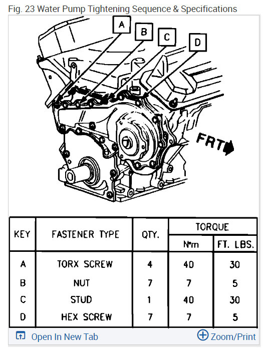

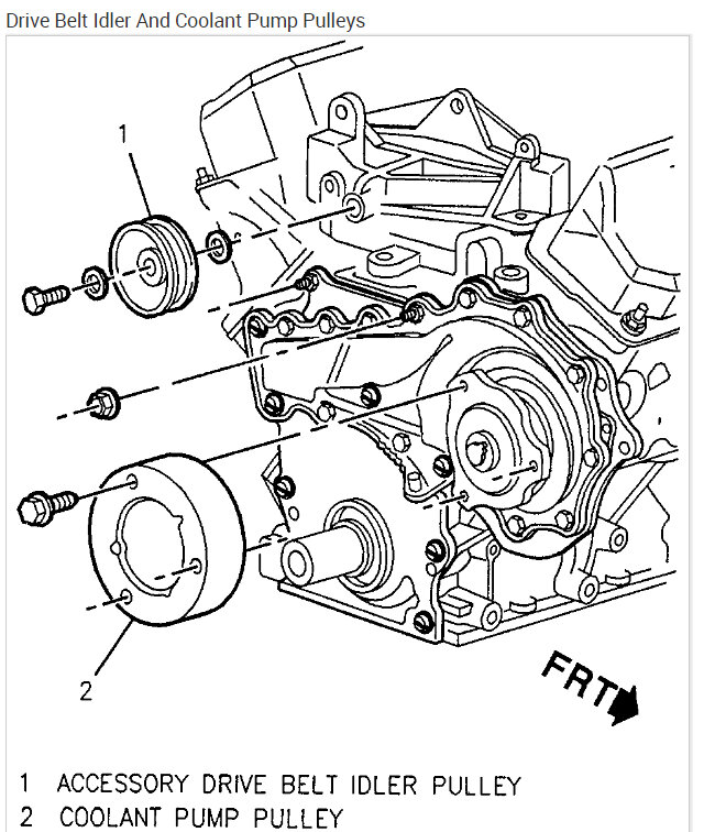

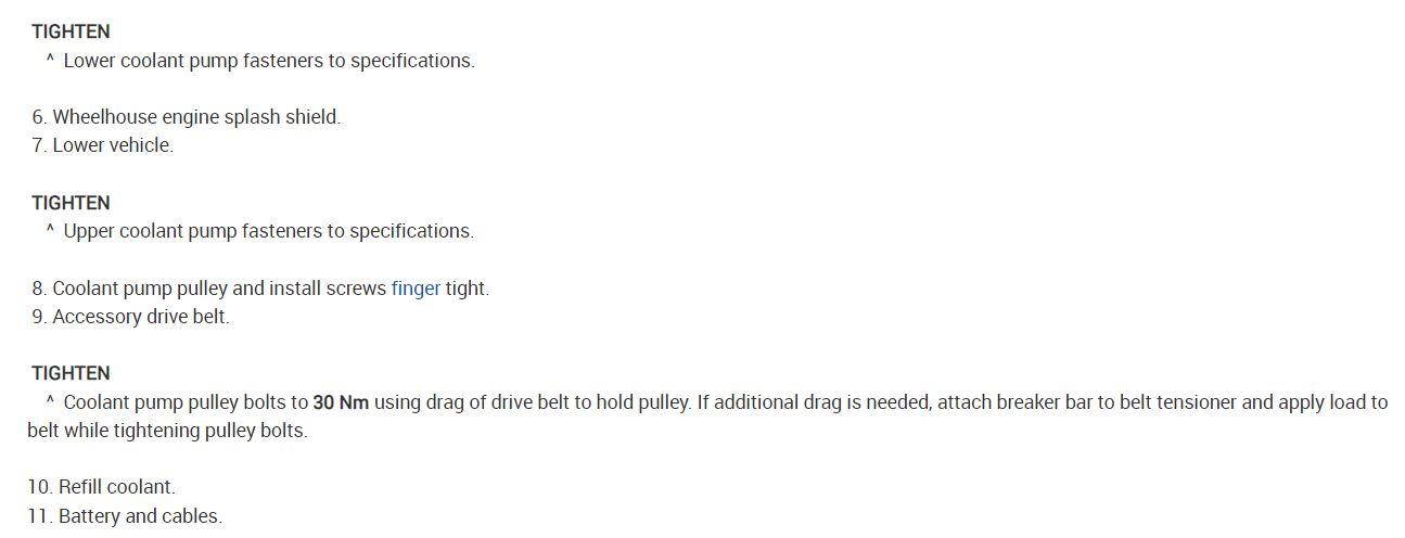

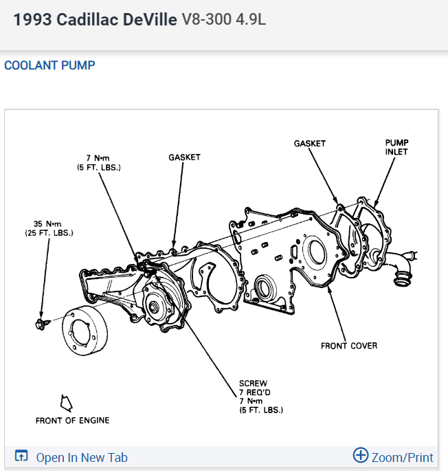

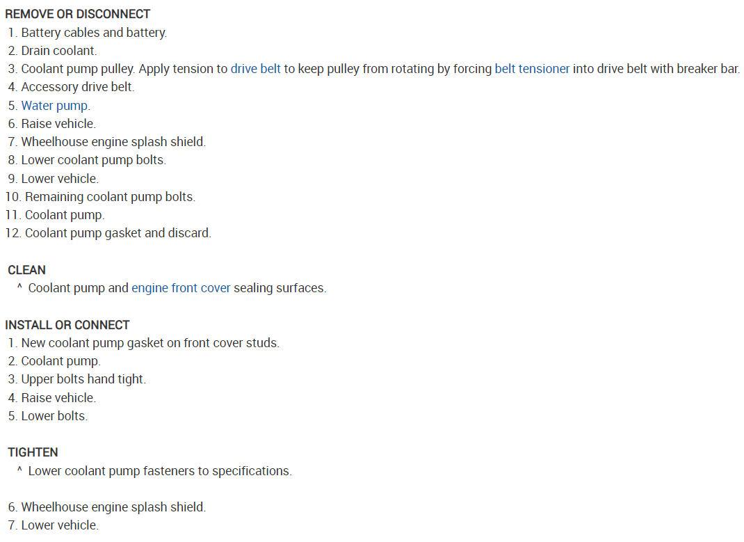

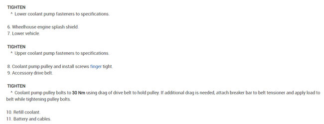

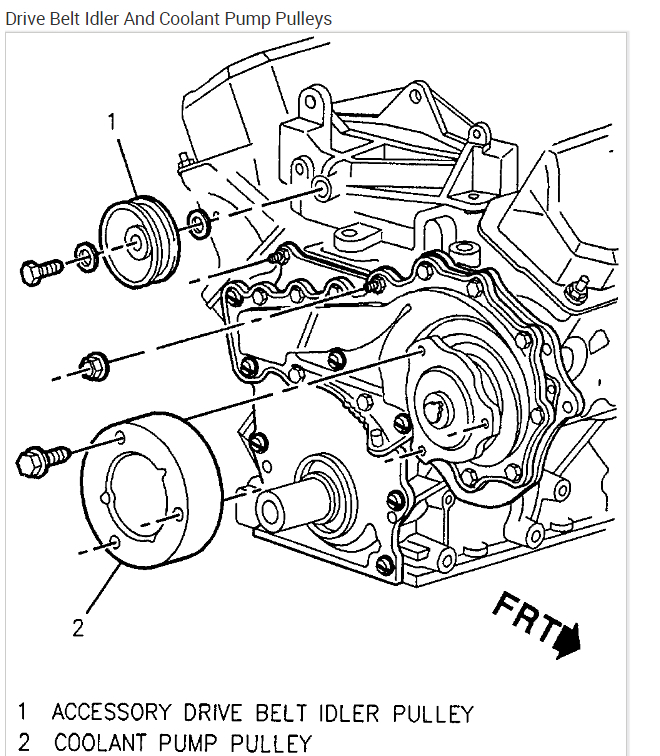

We don't have a video for it but here are the instructions and torque specs needed to do the job. It says it takes a little over two hours to do so be ready. Check out the images (below). Let us know if you need anything else.
