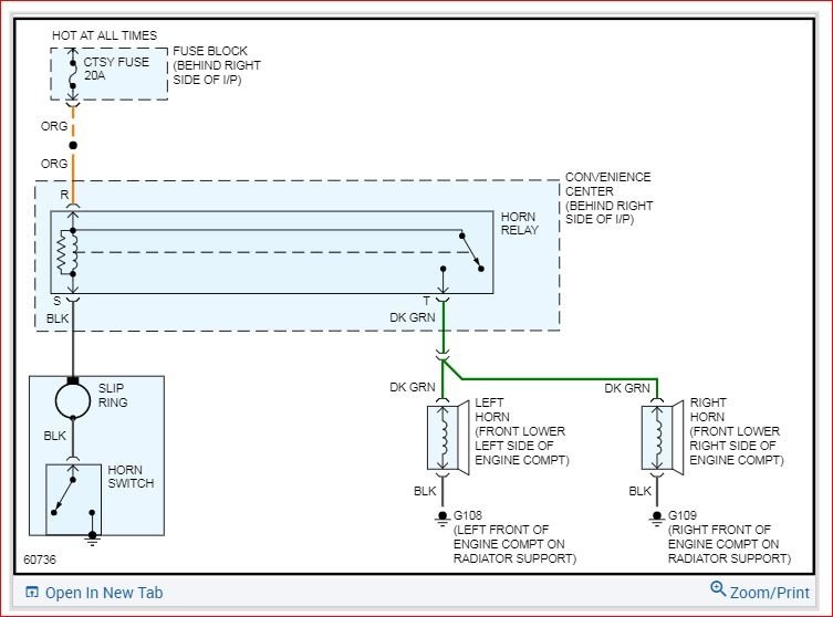

Not saying the horn does not work when you press the button. I'm trying to find where the horn is.

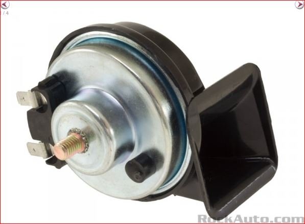

Are you talking about the part of the horn that actually produces the sound? If so, it will be a little speaker in the engine compartment. Unfortunately there is not a diagram that shows them but the wiring diagram lists they are in the left and right front lower side of the engine compartment.
I attached a picture of what they look like.
If you are referring to another component please let me know.
