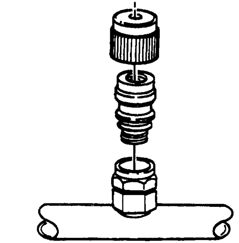

how do I replace the high side port?
1998 CHEVROLET MONTE CARLO
127,000 MILES • 3.8L • V6 • 2WD • AUTOMATIC
JOE1953
  • 772 POSTS
leaking around the high side port it need to be replace.
Aug 12, 2025 at 6:04 PM
Yes, this is easy to replace, I assume all of the refrigerant has leaked out correct? Here is how the job is done and I have included a video to help with the A/C vacuum down and recharge.
https://www.youtube.com/watch?v=4EqdrBVb0sY
Aug 13, 2025 at 11:15 AM
JOE1953
  • 772 POSTS
the parts in the middle do it just screw out? I tried a 5/8 wrench but my wrench want to slip. this is valve core wrench I'm using trying to remove the core but nothing come out.
Aug 13, 2025 at 1:39 PM
Yes, it wont it is made as all one piece I would try vise grips to get the valve assembly out.
