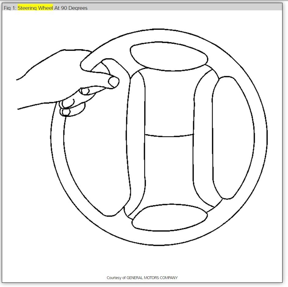

Here are the instructions with diagrams below to help you replace the blinker switch.
TURN SIGNAL SWITCH REPLACE
1. Disconnect battery ground cable.
2. Remove horn switch, then the steering wheel.
3. Remove turn signal switch lever by unscrewing from steering column.
4. On 1987 models, remove lower steering column shroud. On 1989-91 models, remove upper and lower shrouds.
5. On all models, disconnect electrical connector from turn signal switch and remove switch attaching screws.
6. On models with tilt column and Bronco with fixed column, remove wires and terminals from steering column electrical connector, after noting color code and location of each connector. Remove plastic cover sleeve, if equipped, from wiring harness, then lift switch assembly out through opening in shift socket.
7. On models with fixed column except Bronco, remove switch assembly by lifting out of column while guiding connector plug through opening in shift socket.
8. Reverse procedure to install.
