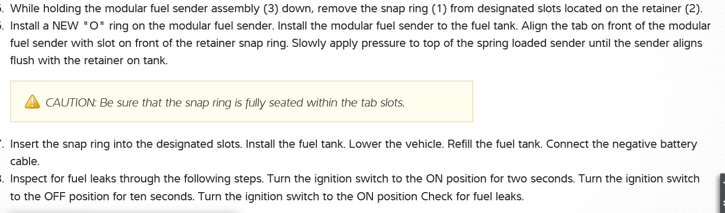

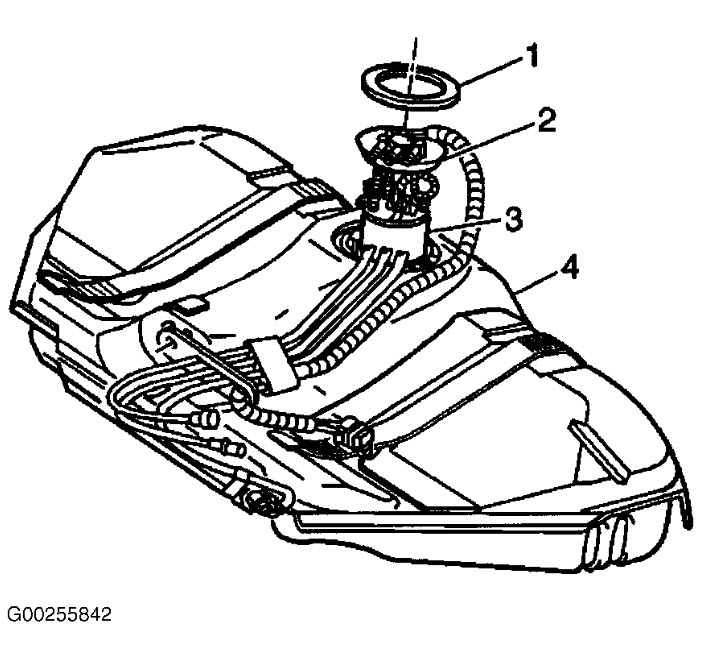

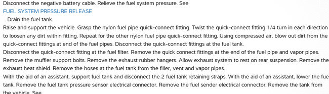

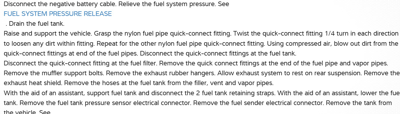

see pictures this includes removing fuel pump module.
