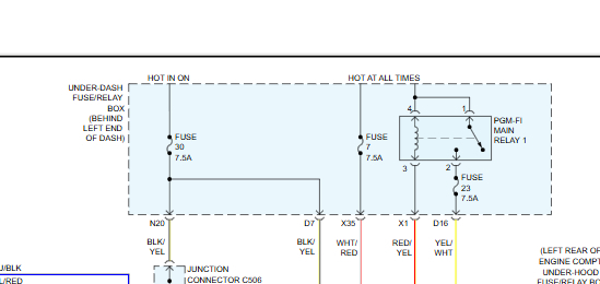

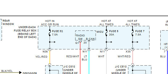

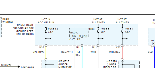

Did you check the fuses? If not I would check the 3 fuses that run the system, here is a guide to help and the fuse locations in the image below.
Have the key on on when checking the fuses. Check out the images (below). Let us know how it goes
