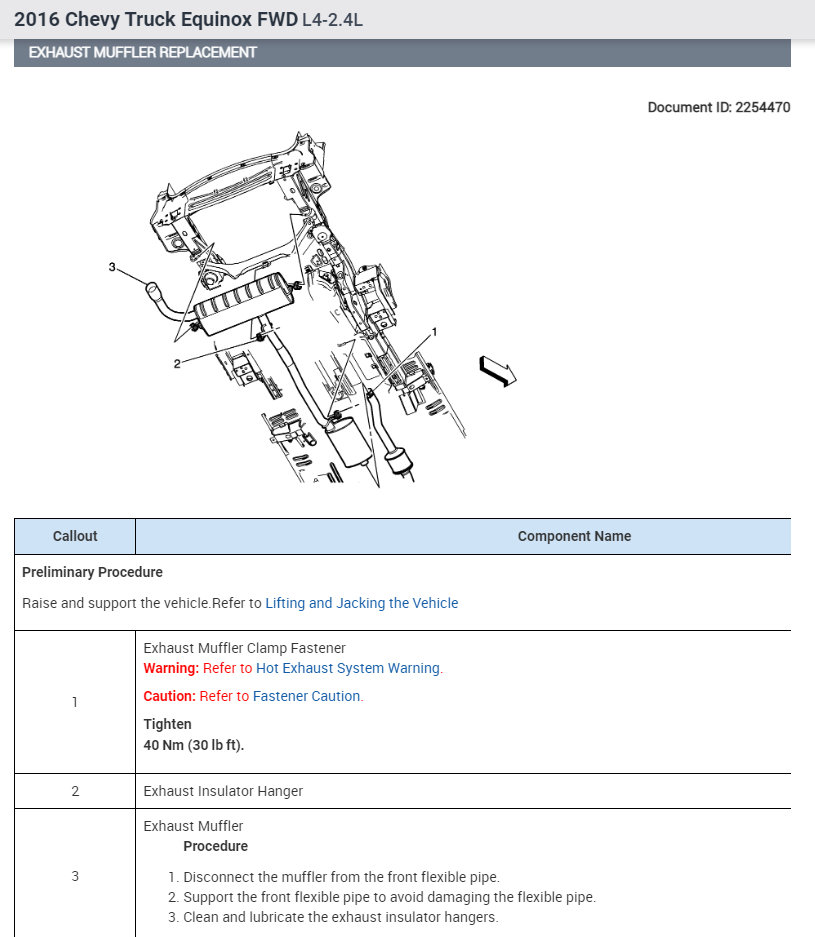

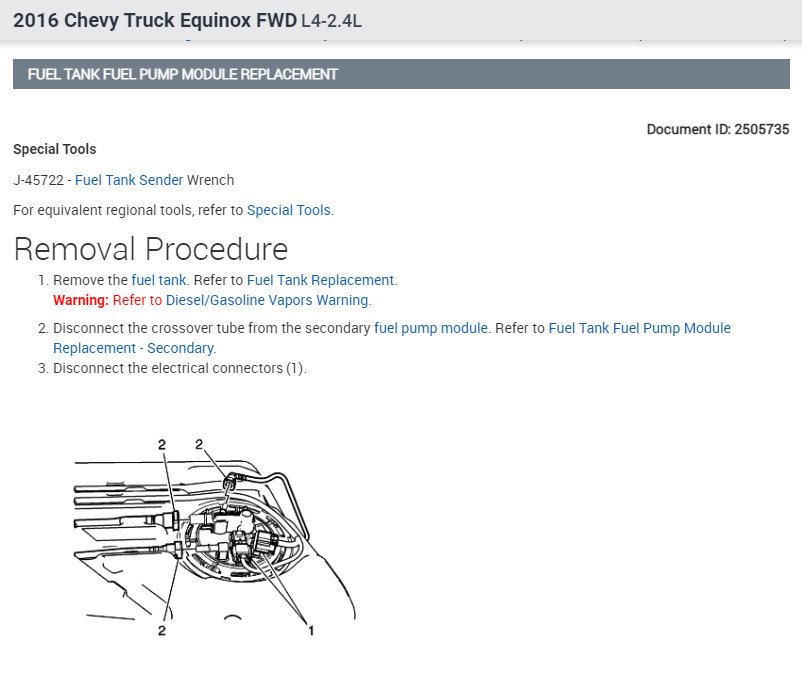

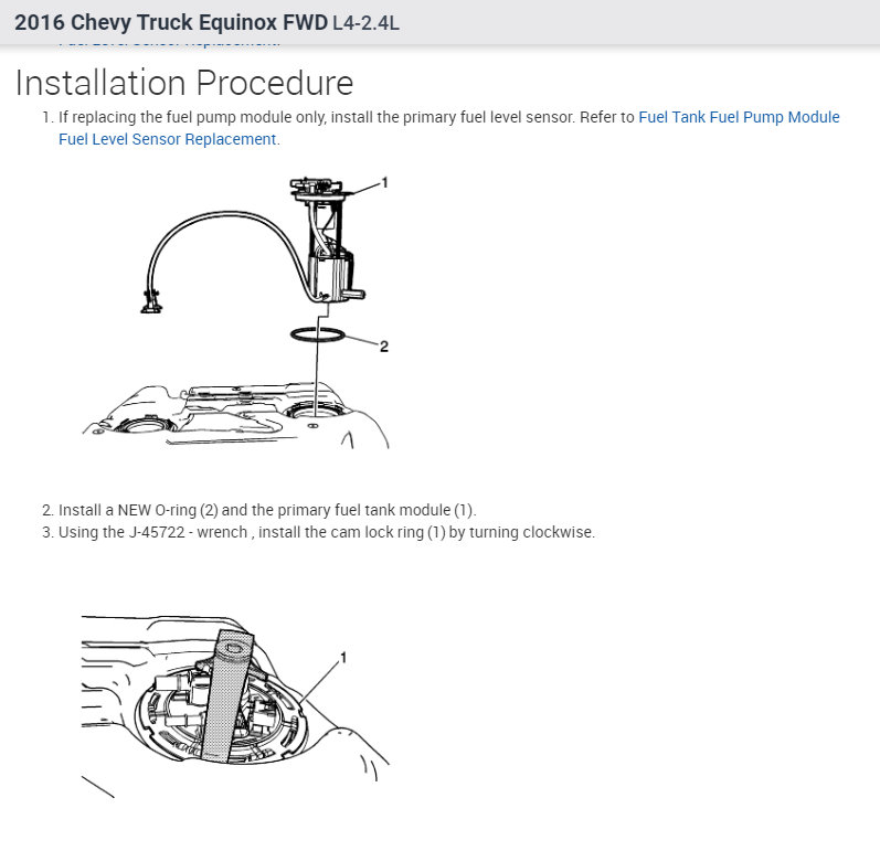

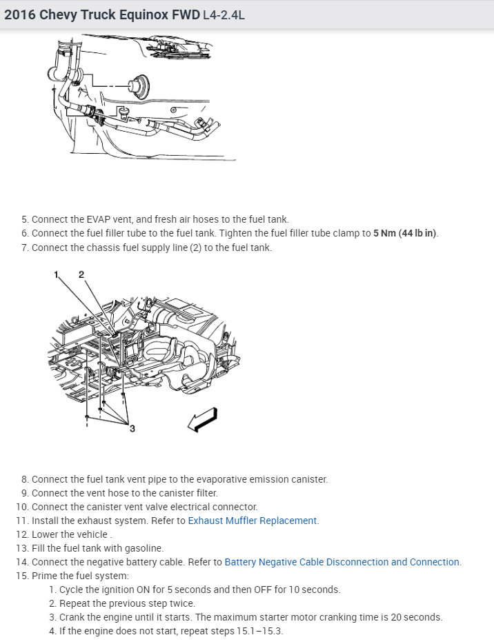

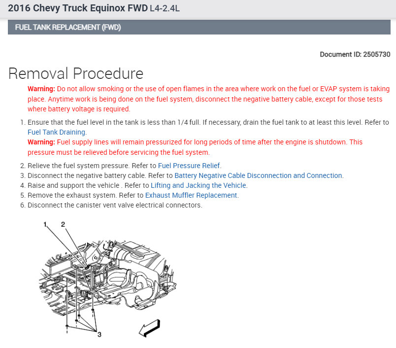

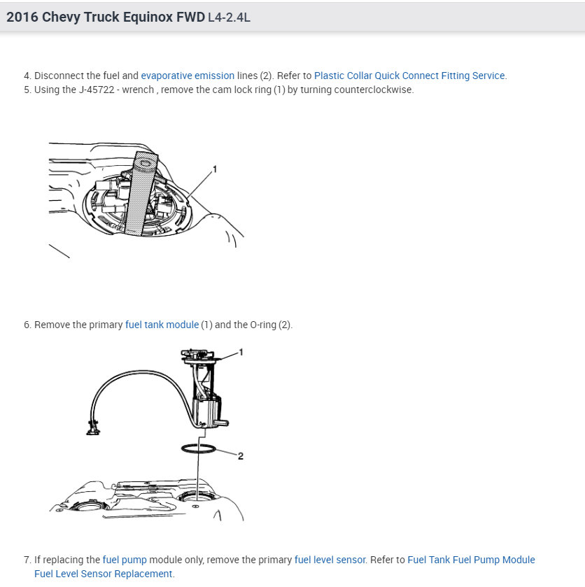

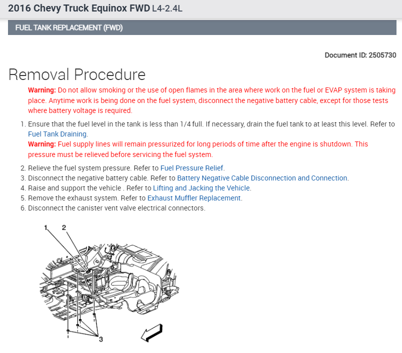

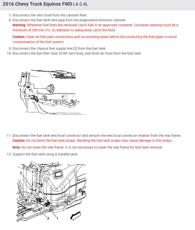

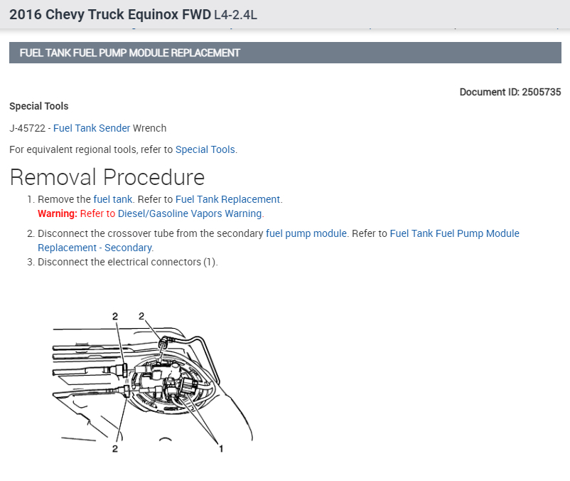

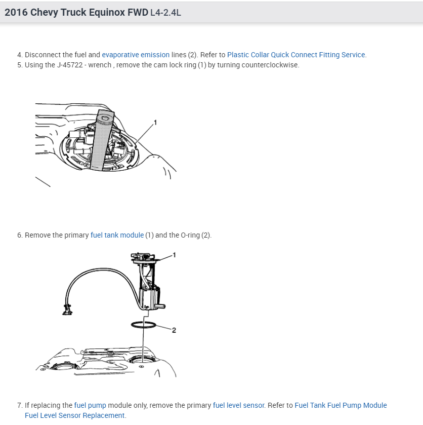

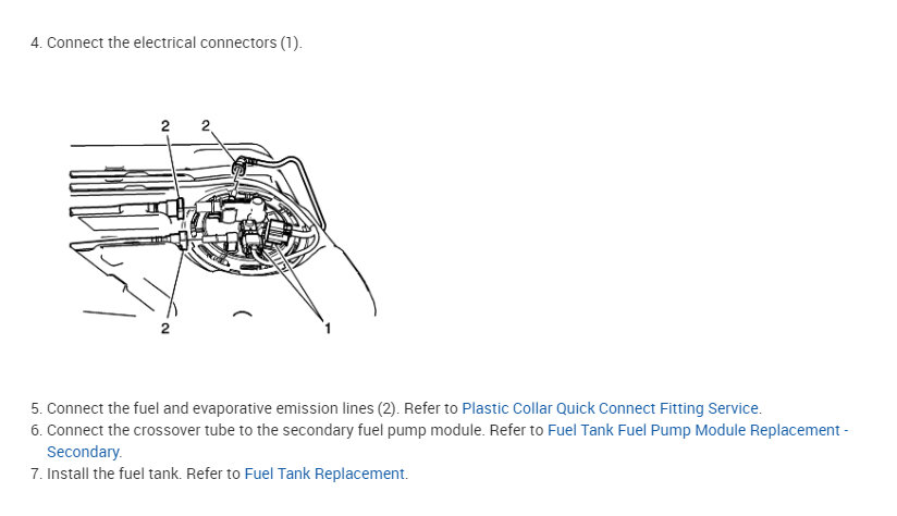

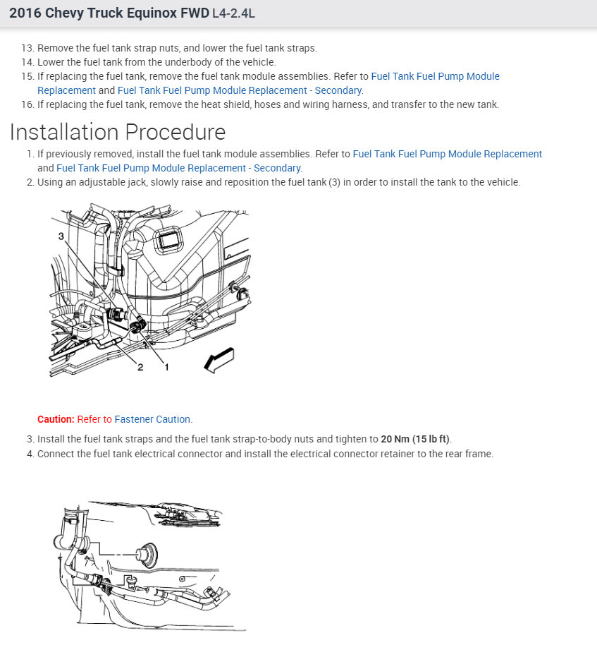

On this vehicle you will have to remove the exhaust to drop the fuel tank.
I have attached the fuel pump, fuel tank and exhaust removal and installation procedure below for your reference.
Let me know of any questions.
