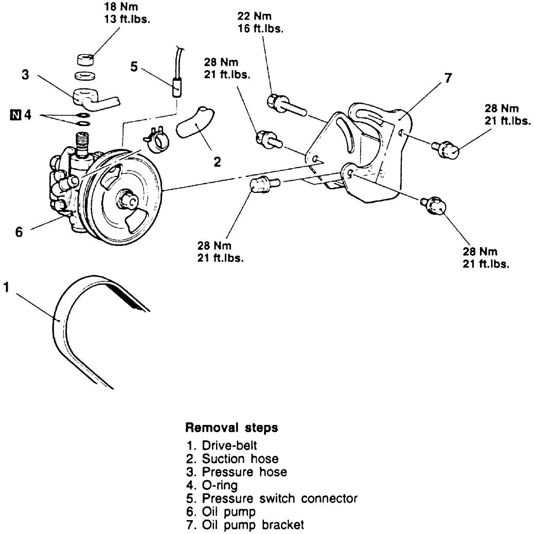

How do I change the power steering pump? I cannot figure where the tension pulley is to loosen belt.

On the power steering pump bracket, loosen the four bolts, two in front and two in the rear.
Here is a diagram:
Image (Click to enlarge)

This guide will give you an idea of what you are in for when doing the job.
https://www.2carpros.com/articles/how-to-replace-a-power-steering-pump
