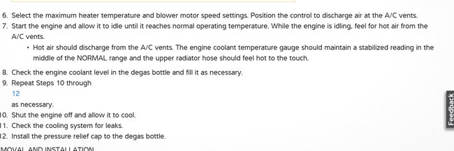

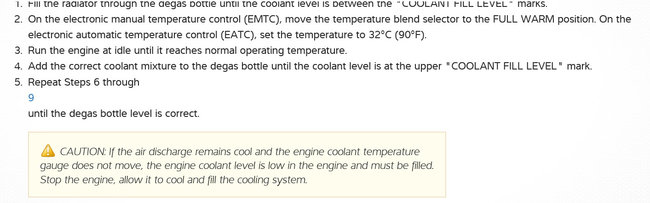

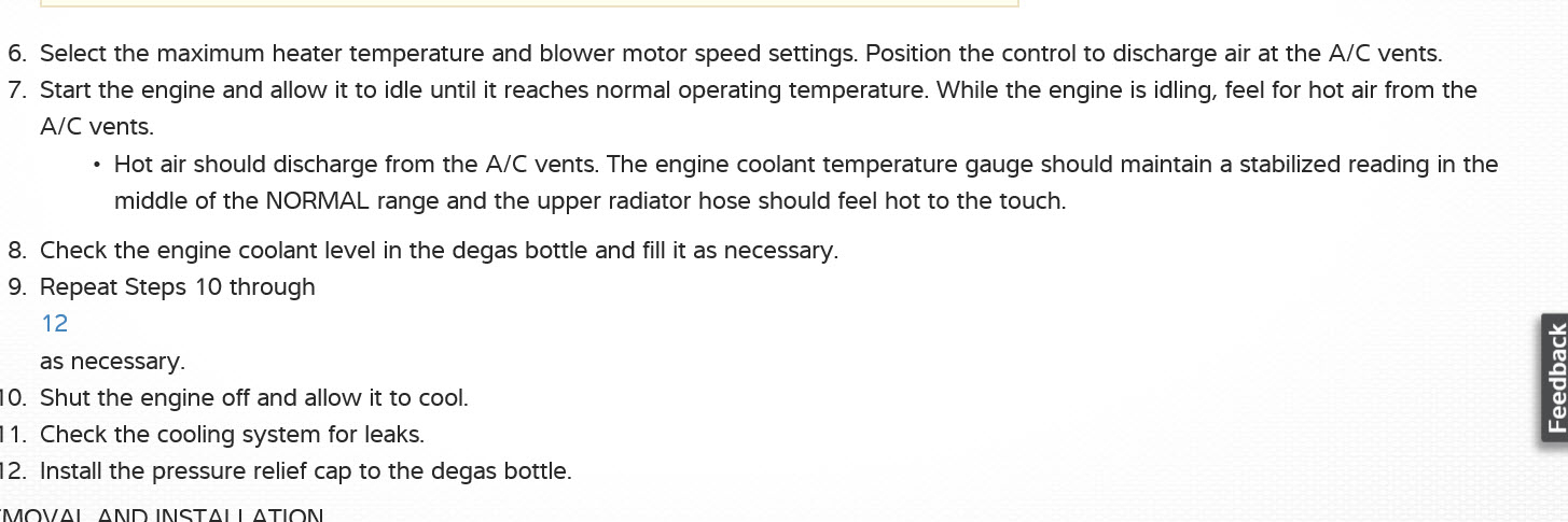

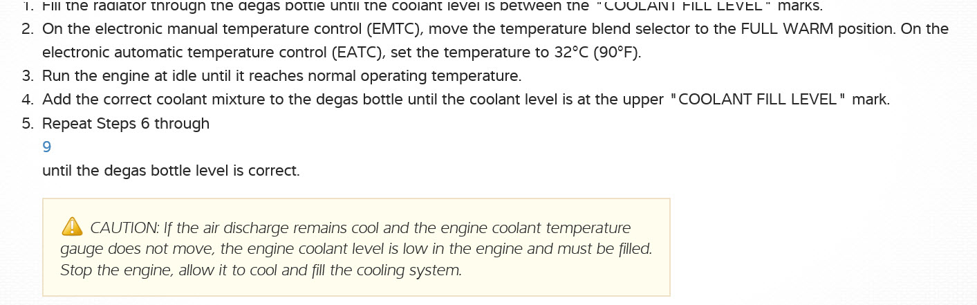

see pictures for bleeding system.

with it off then install cap after it says right in instructions.
