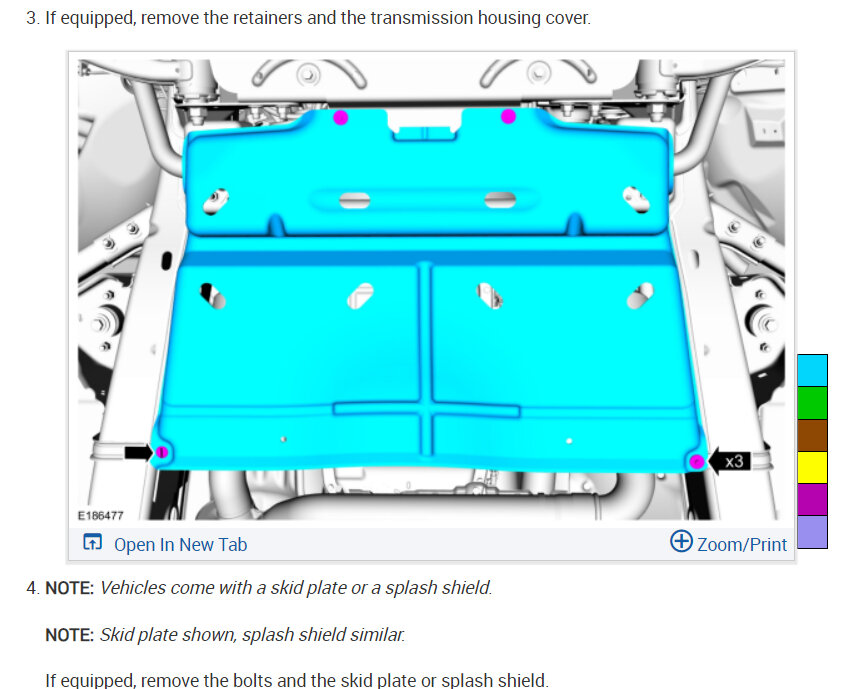

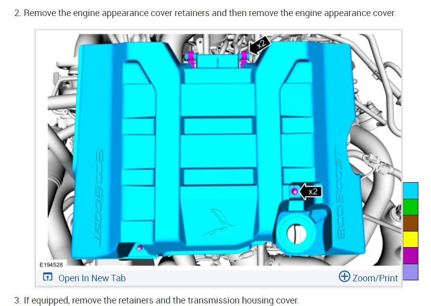

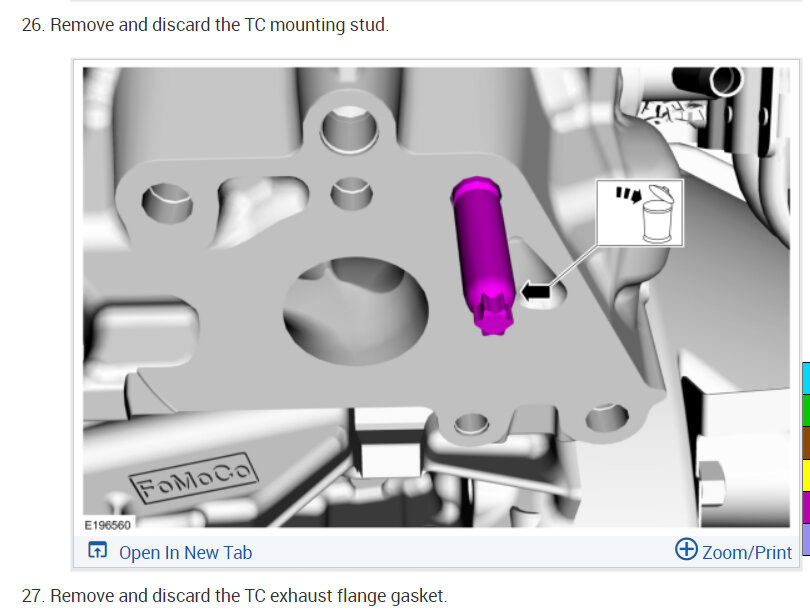

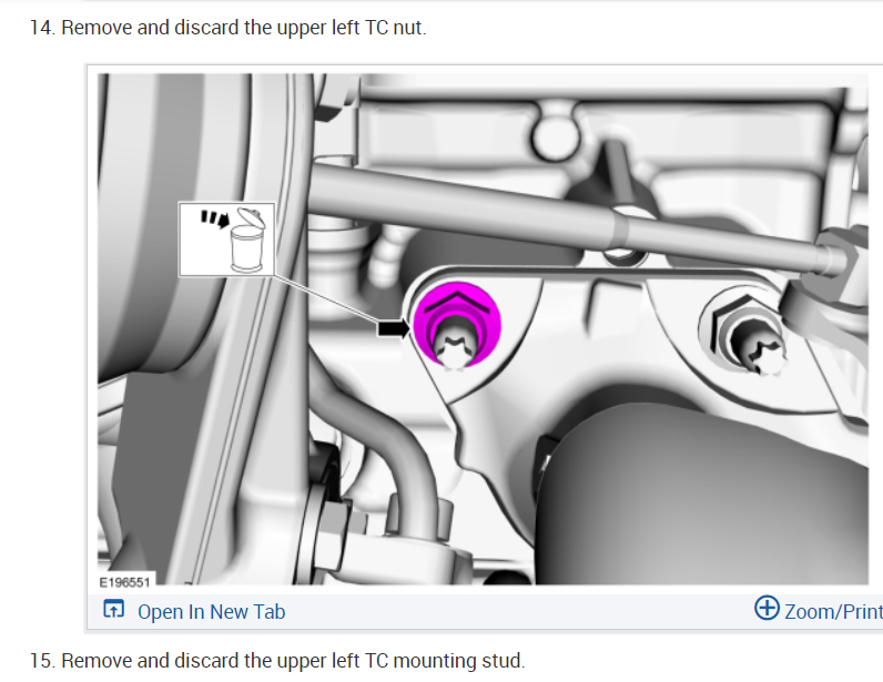

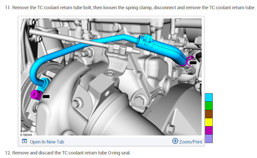

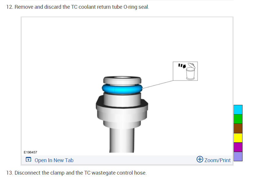

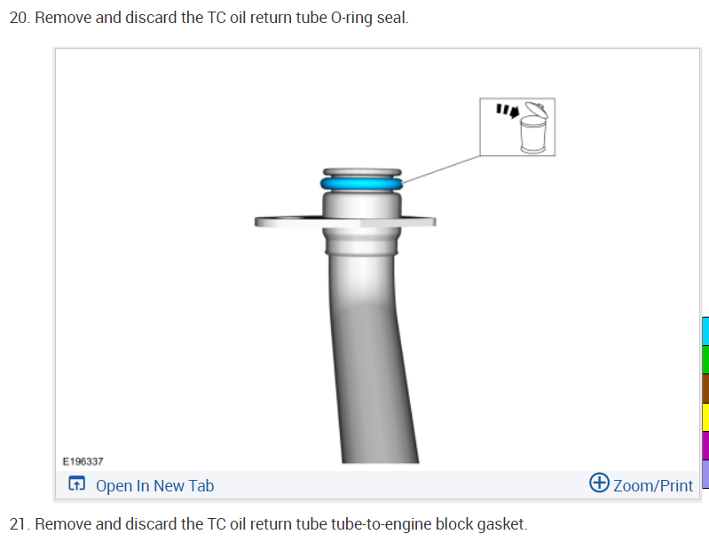

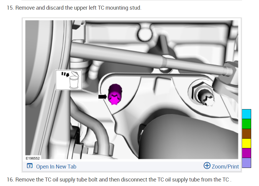

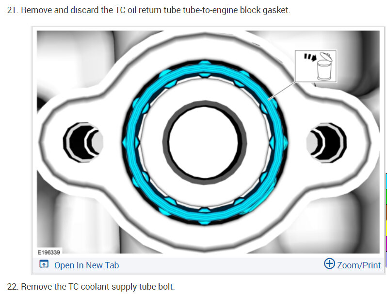

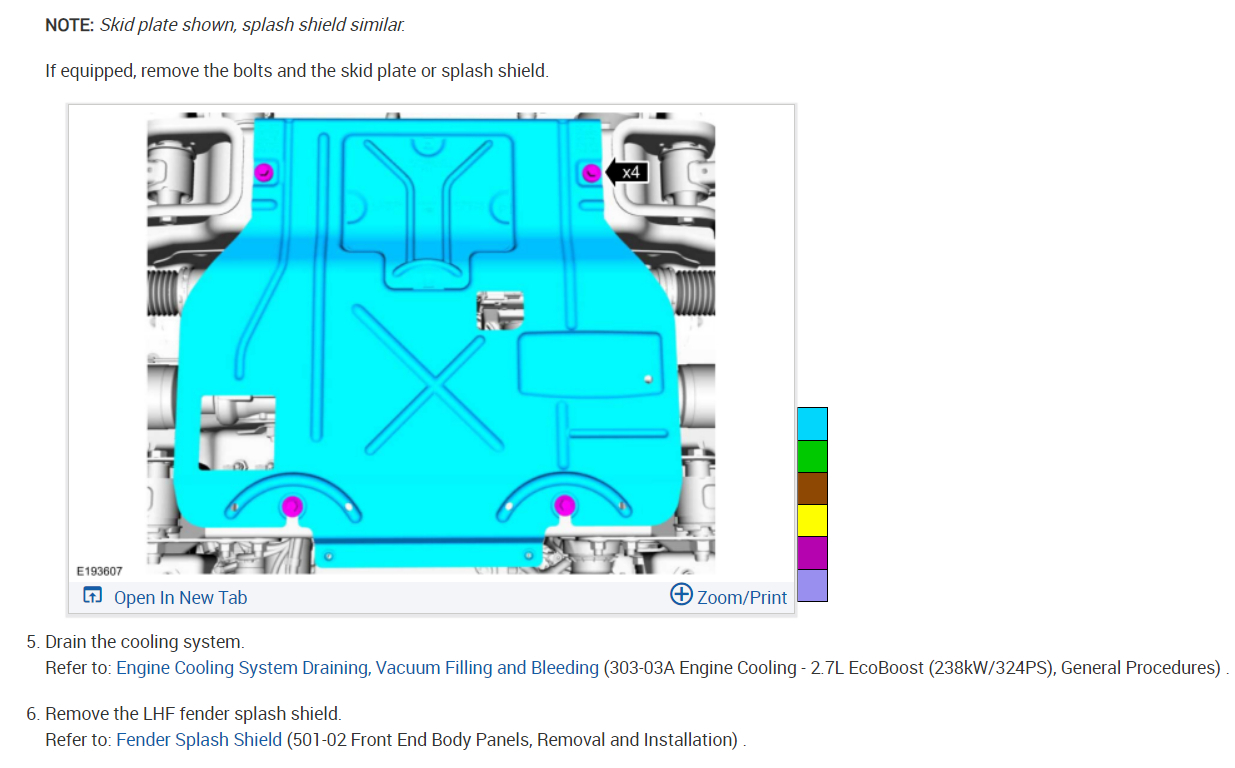

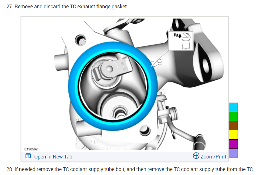

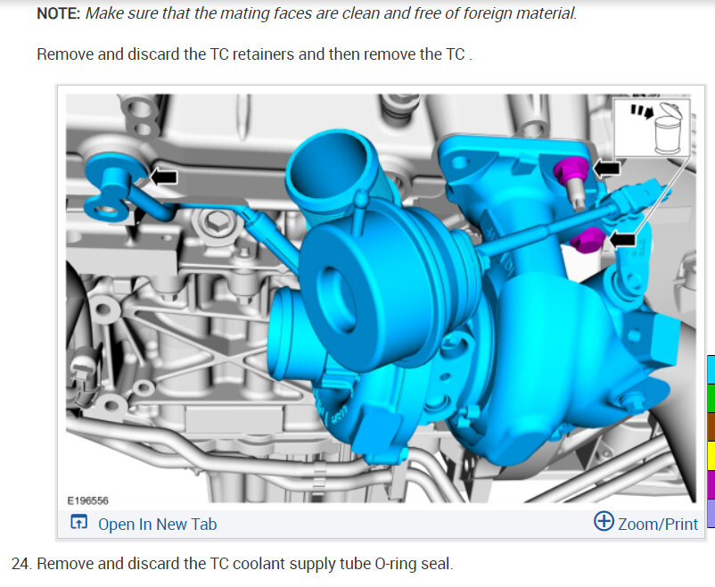

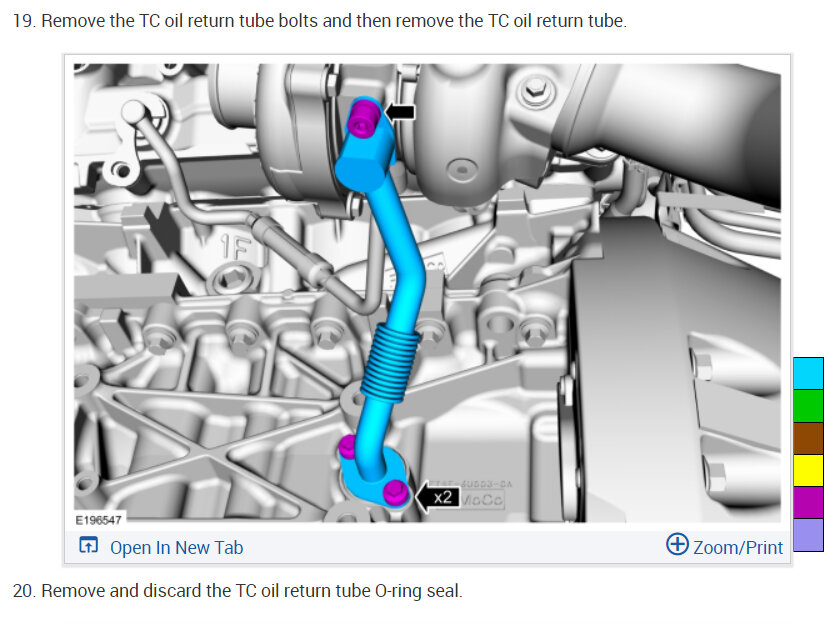

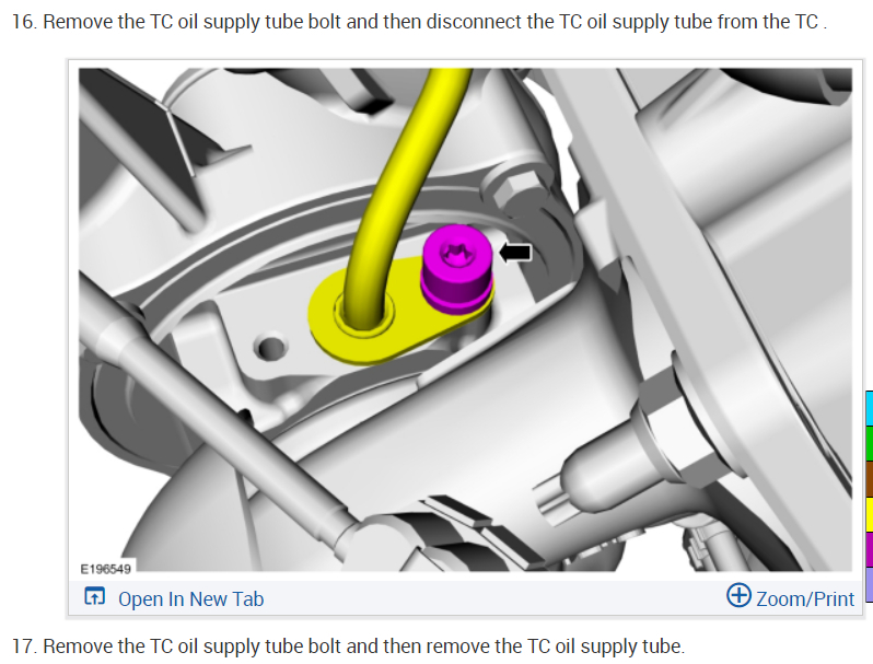

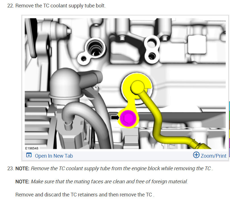

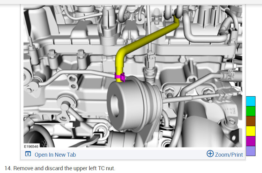

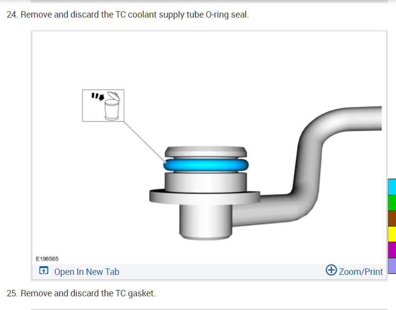

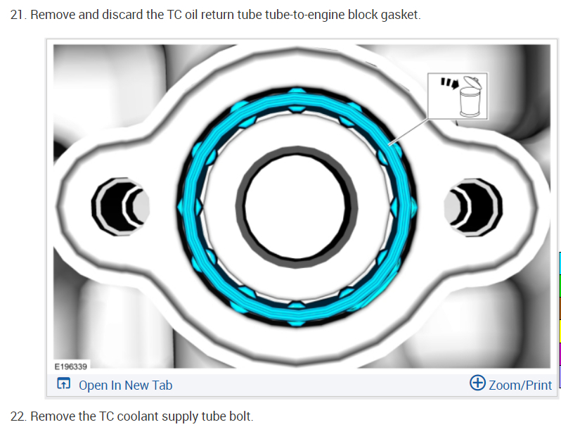

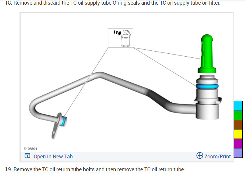

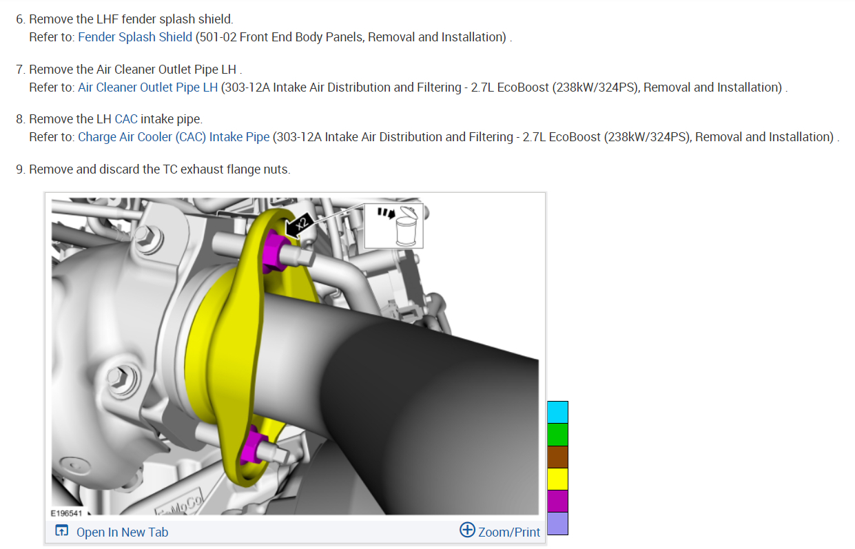

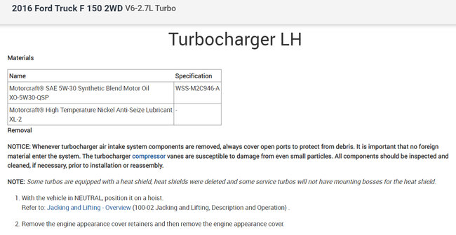

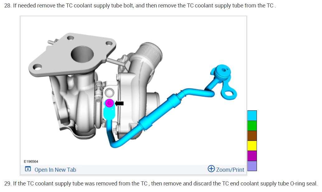

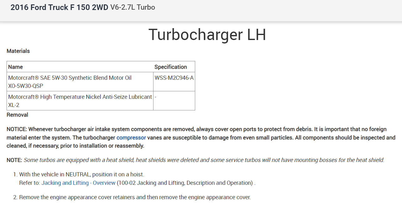

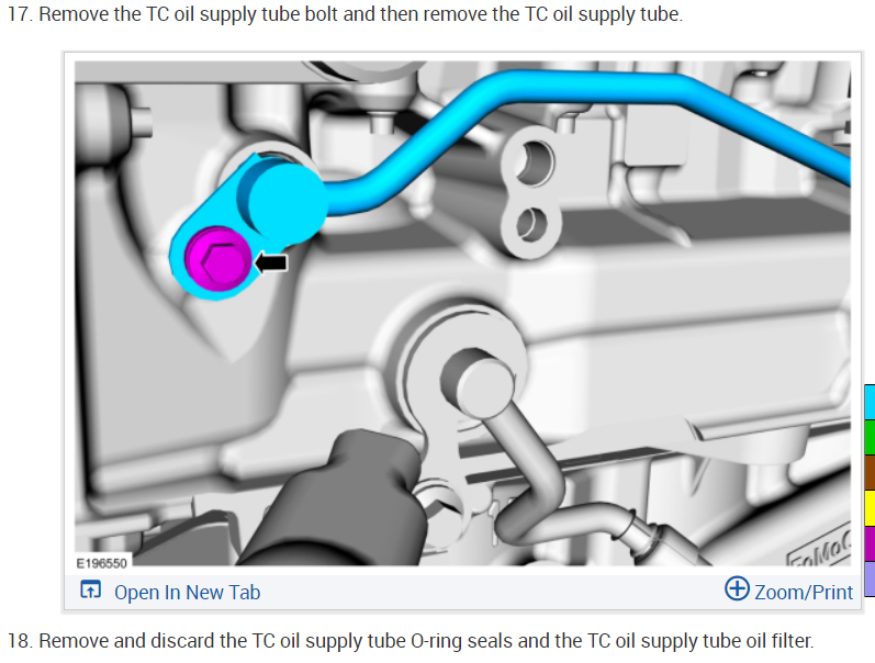

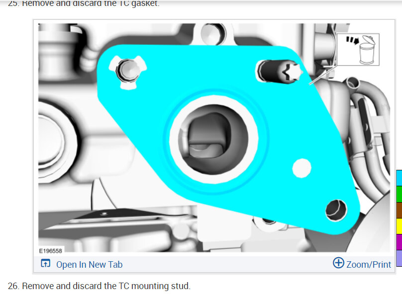

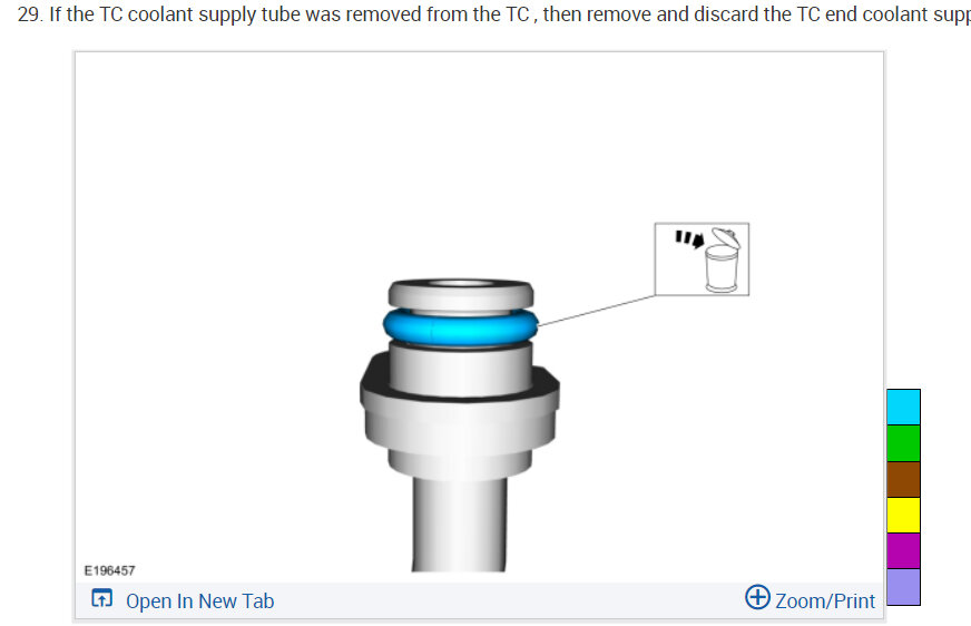

Yep, they just do, because the turbo spins so fast when it goes bad it does so very quickly which will cause the aforementioned smoke. This is a common problem with these trucks, I would replace both turbos to fix the problem, here is how. I show one right the opposite side is similar. Check out the images (below). Please let us know what happens.
