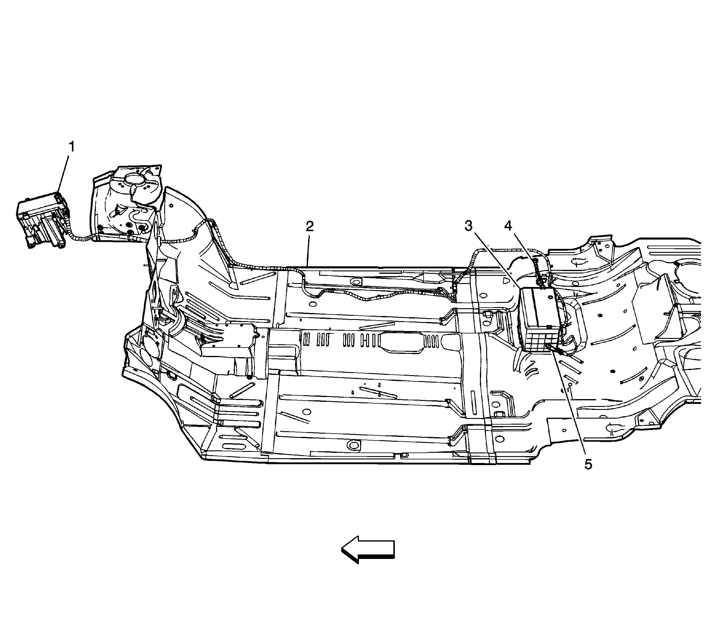

That is a tough one because there are so many different possibilities. If the smell is coming from in the vehicle, remove door panels to confirm there is nothing shorting with the power windows, door lock assembly. If the smell is noticeable both inside and out, remove the tail light assembly and inspect wiring. Also, the battery is located under the rear passenger seat. Remove the seat and confirm there are no melted or damaged wiring.
When you remove these components for inspection, pay close attention for the smell you mentioned. Often times, electrical components will have or create a residual smell which can help locate the problem.
The attached picture shows where the battery is physically located. If you find you need to check for power, check wiring. Here are links that show how it is done:
