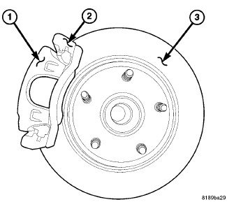

Here is a guide to help you step by step with instructions in the diagrams below to show you how on your car.

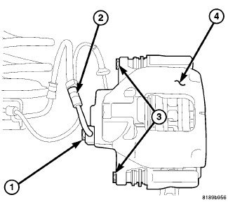

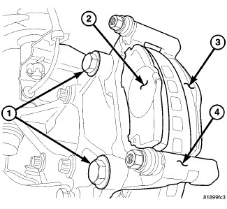

Here are the directions specific to your vehicle for replacement. The pics below correlate with the directions.
FRONT PADS
Raise and support vehicle.
Remove wheel and tire assembly.
Drain small amount of fluid from master cylinder brake reservoir with clean suction gun.
Remove the 2 caliper mounting bolts (3).
Compress the caliper (4) and remove from the adaptor.
Secure caliper (4) to nearby suspension part with wire. Do not allow brake hose to support caliper weight.
Remove the inboard (2) and outboard brake pads (3) from the caliper adapter (4).
Remove the anti-rattle clips from the brake caliper adapter (4).
Install
Remove and clean all rust and debris from the anti-rattle clip mounting surfaces (3) on the brake caliper adapter (2).
Install new anti-rattle clips into the caliper adapter (4).
Install the inboard (2) and outboard brake pads (3) onto the caliper adapter (4).
Install caliper (4) on the caliper adapter.
Install the caliper slide pin bolts (3) and tighten to 44 N·m (32 ft. lbs.).

Check out the diagrams (Below). Please let us know what happens.
