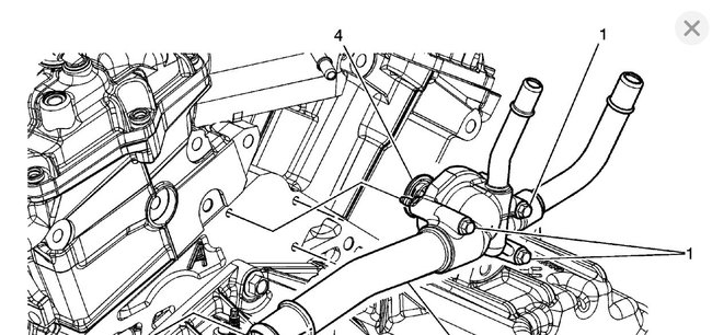

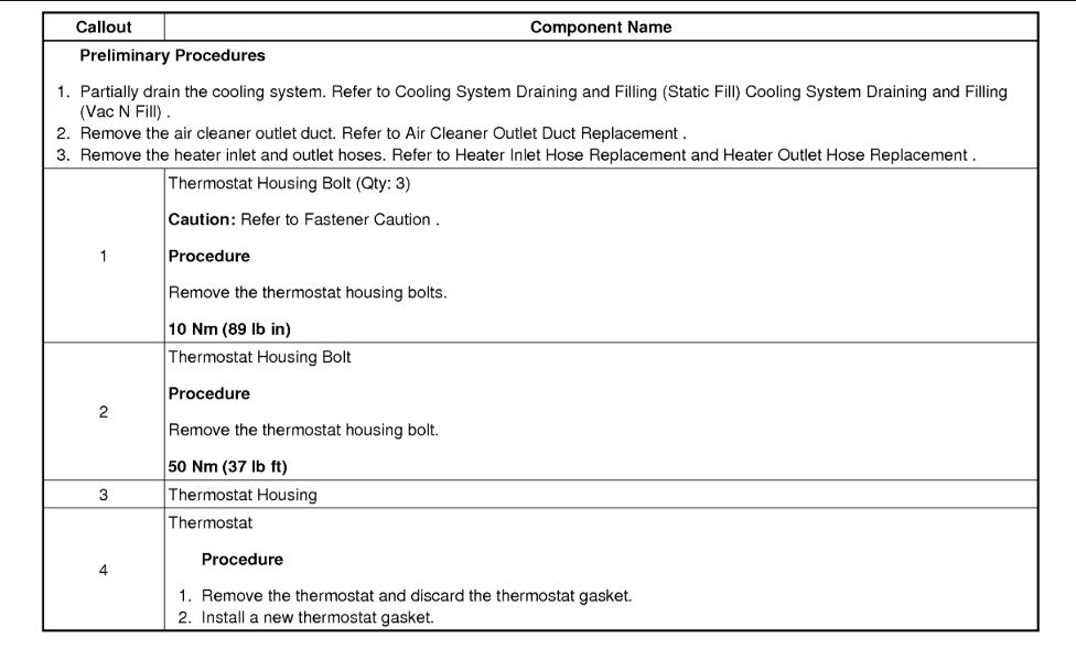

I would start by changing the thermostat. If it is not opening all th way, it will cause the engine to heat up.

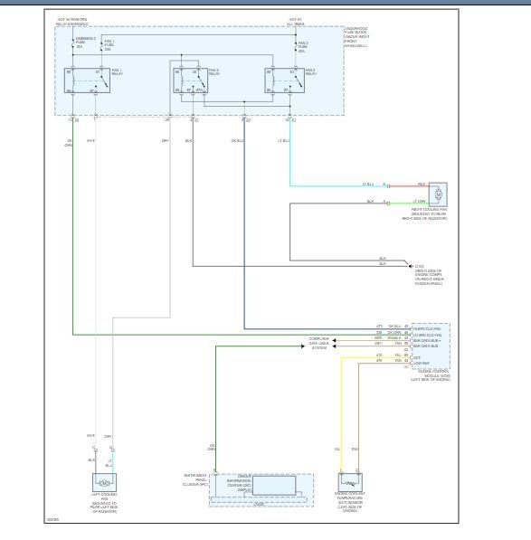

Are the cooling fans coming on when the engine is stopped or idling?
I attached a wiring diagram for the fans in case there is an issue. We can do some checks if they are not working.

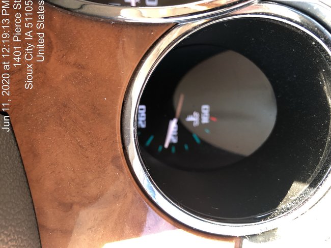

It sometimes gets a little higher then this:

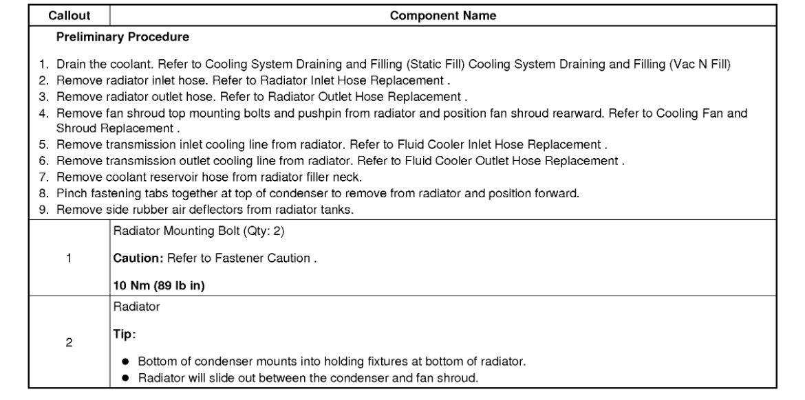

Then there may be more inside that did not get removed.

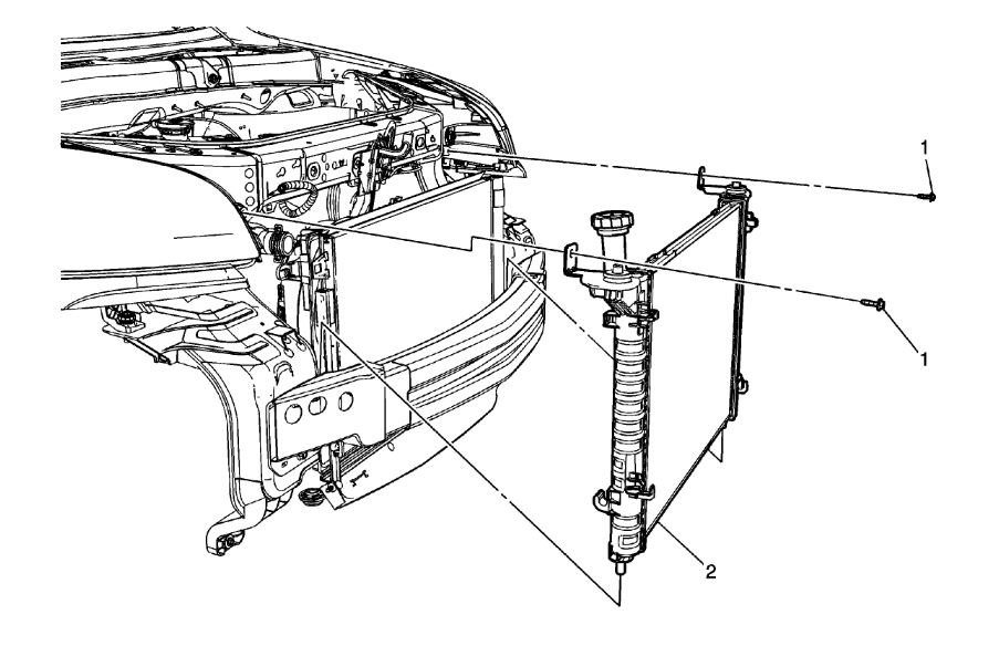

I would suggest replacing the radiator with a new one.
https://www.2carpros.com/articles/how-to-replace-a-car-radiator
